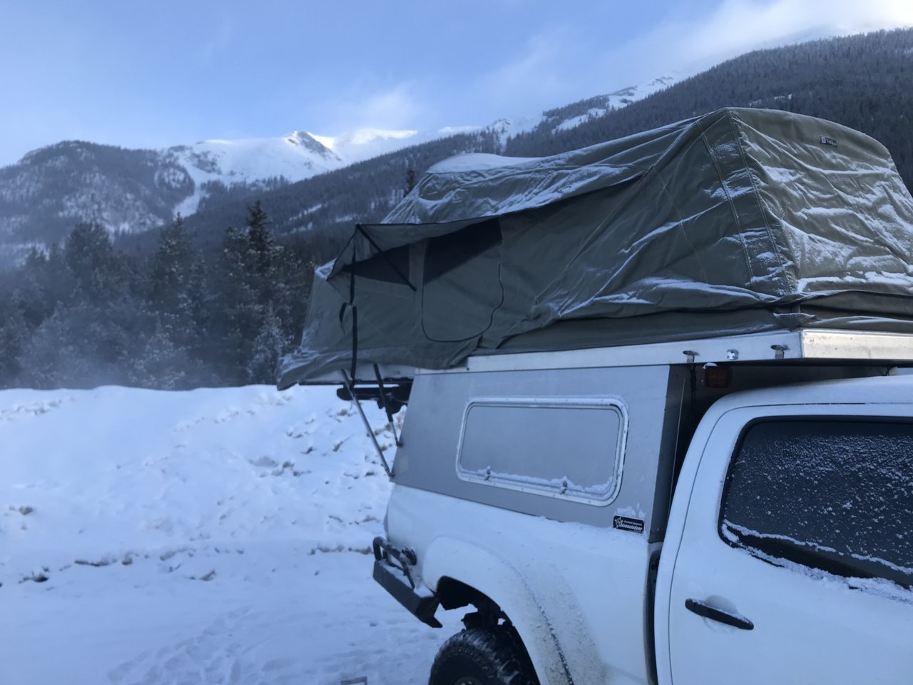

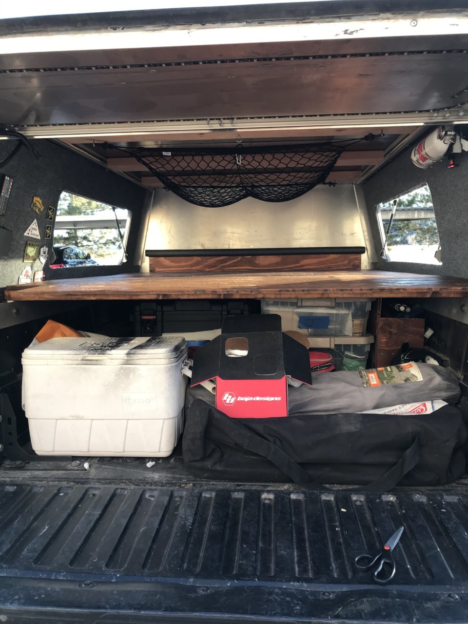

    Sup everyone,
    i see we are sharing winter camping with the habitat stories.. so figured id share my most recent winter camping setup.
    I have been snowboarding and camping every weekend. Here in Colorado, it has been getting pretty chilly. Two weekends ago, it dropped to -4*F overnight. I don't have a heater just a down sleeping bag and a blanket. I was toasty! The worst part was trying to pack the habitat up alone at 0*F in the morning. When everything is frozen, nothing wants to corporate. I have determined that the habitat is no problem to pack up when the temp is >=15*F but below that and it exponentially becomes more of a task. After that experience, I decided to switch up my winter camping situation for these 3 reasons:
    1. Packing up the tent alone in extremely cold weather is a PITA
    2. Removing the snow that accumulated on the tent overnight is a PITA
    3. Incognito camping in Summit County is more difficult when popping the habitat
    Below is my new setup (excuse the mess.. this is midproject)

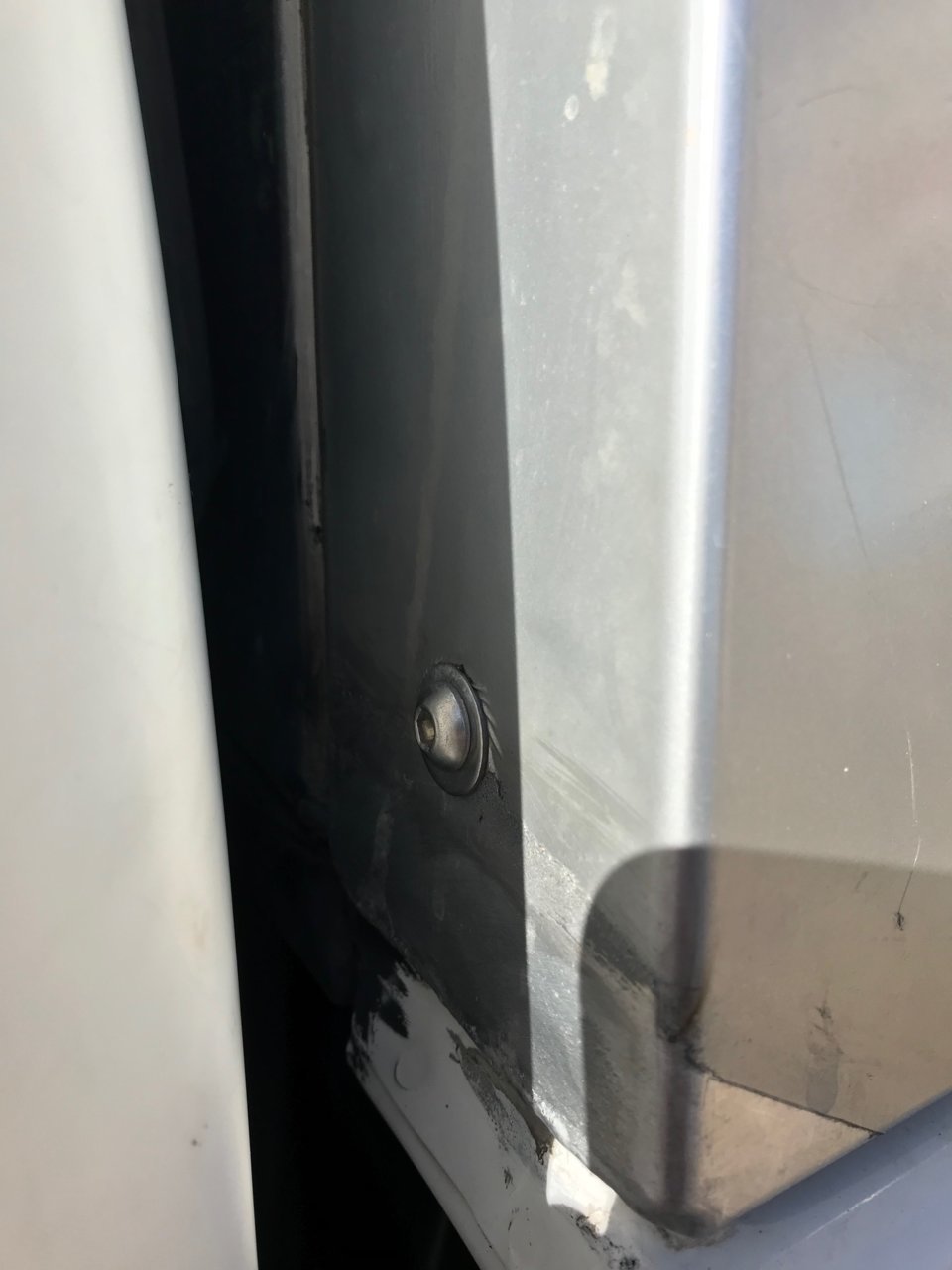

    **Postscript: I went to AT in Prescott and they fixed the cracks in the front corners of my habitat. They are pretty cool dudes! If you are having this issue give them a call and they will take care of you. If you arent facing this issue yet and don't have bed stiffeners, buy bed stiffeners.. it MAY prevent the cracks from occurring.

    I’m heading down this Monday to get the corner stiffeners installed in my habitat at AT.
    It’s those Tacoma composite beds that are causing the flexing of our habitats that cause the fractures of the aluminum corners. I have a big year planned with some amazing adventures and don’t want the those corners to get worse. I’m glad AT found a solution for this issue.

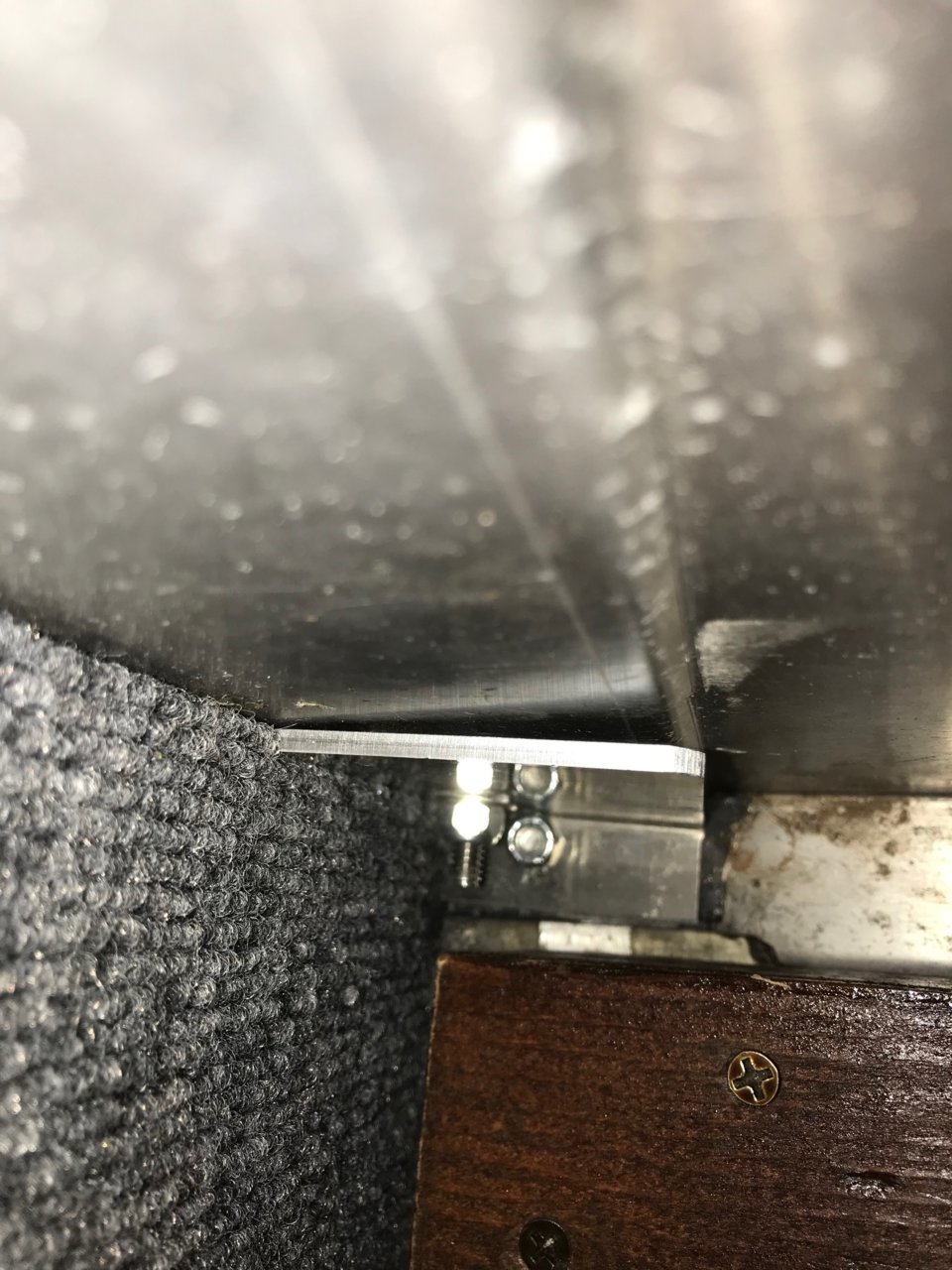

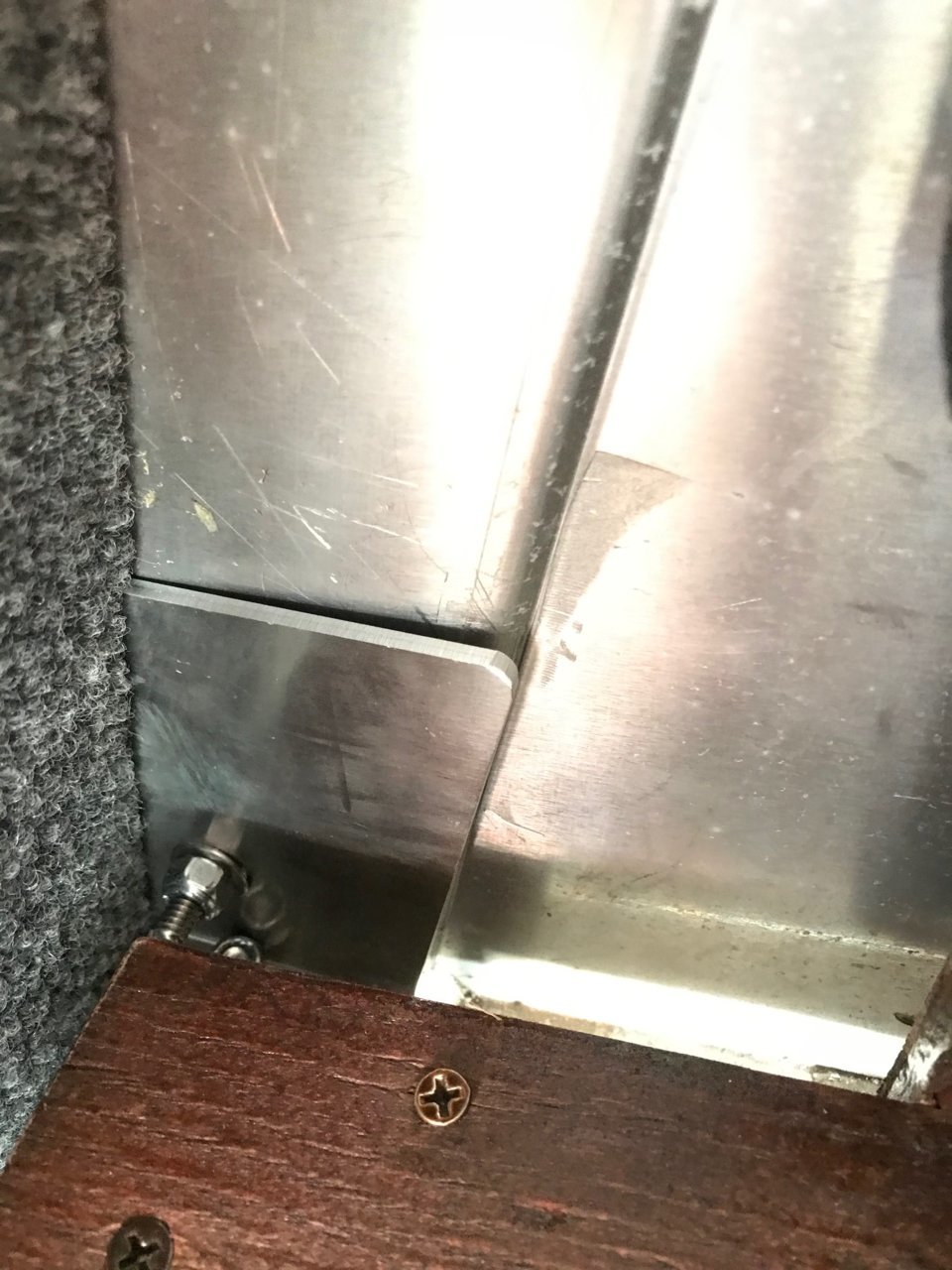

    For mine, they rewelded the seam and installed the L brackets they made that provides additional rigidity to the corners. Simple fix but the work of lifting the habitat and installing the brackets in the right place is the hassle. They make it easier because they have all the right tools and know exactly what to do.

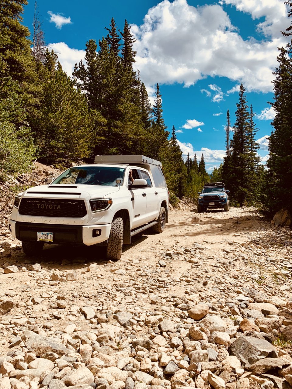

    Habitat is on my tundra ;) Not sure that i necessarily need them but I’d rather be safe than sorry. The tundra will still flex quite a bit.
    Probably go with the SDHQ hidden ones unless there’s something else out there.

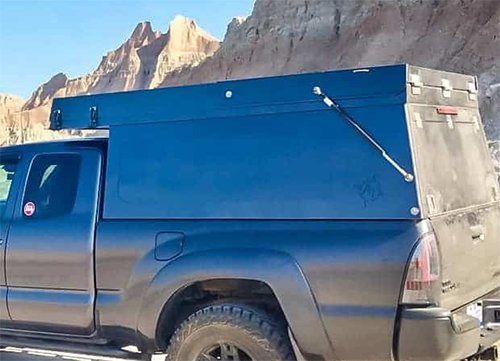

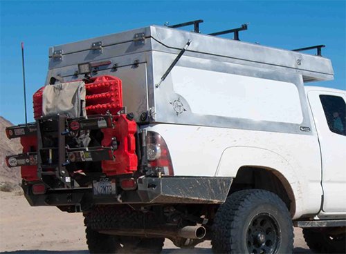

    In 2016, the side panels were a two-part exterior design.
    V1.0
    In Late-2017/Early-2018, AT made the switch to solid exterior design.
    V1.1

    As you can see, it goes under the side rail support on the bottom.

    I would argue v1.1 was out before late 17. We took delivery of ours in May 2017, solid panels. But that is me just splitting hairs.
