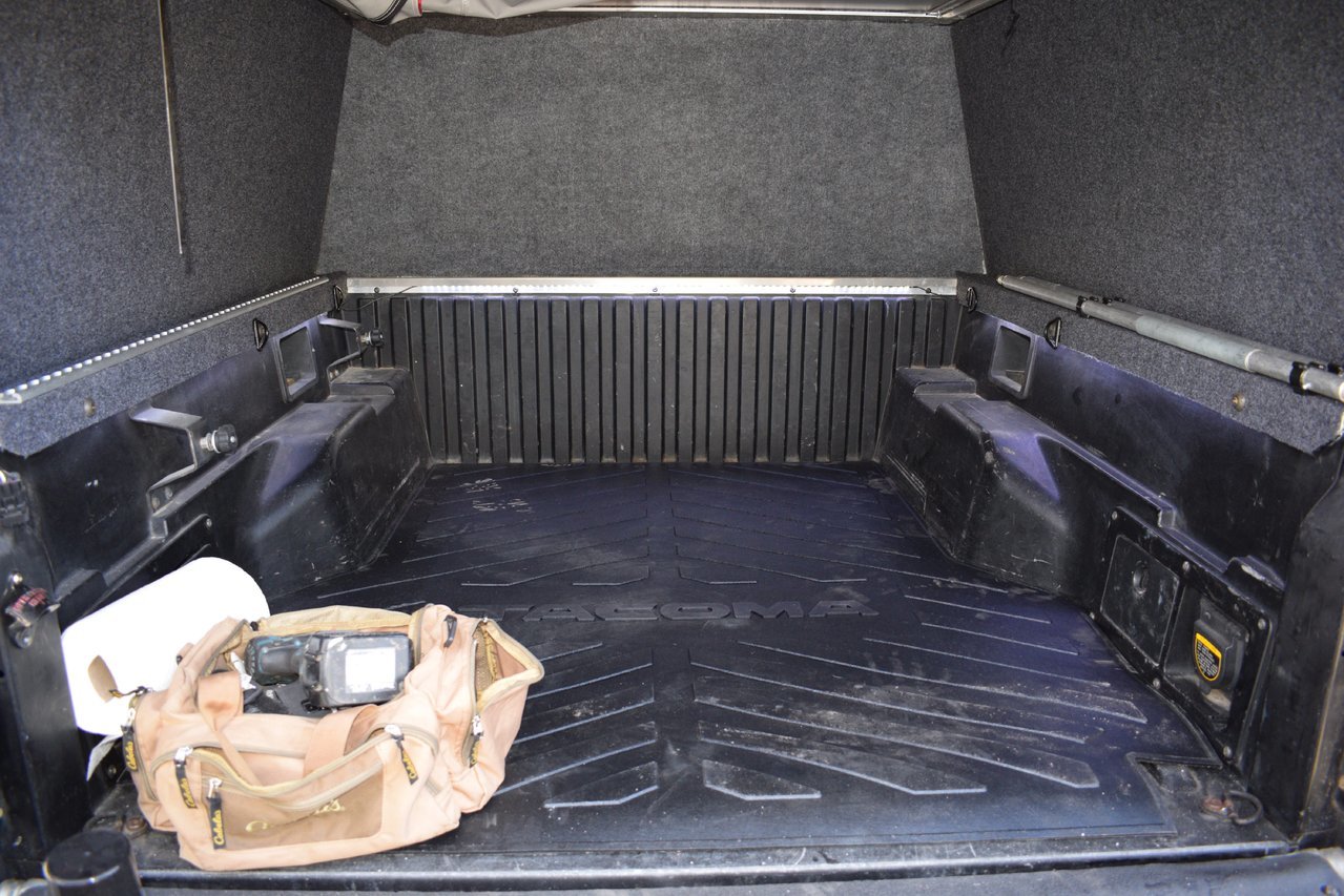

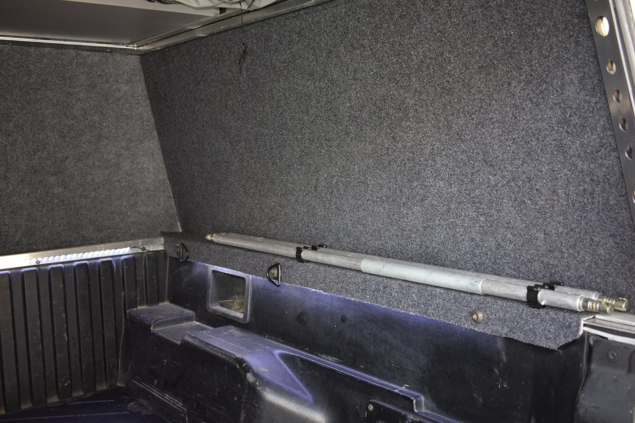

    I only have had the habitat for a month, and am already pretty well into the build.
    After alot of back and fourth on carpet, I finally decided to use a factory bedmat for the flooring inside the habitat. I am very happy with this choice as we camp in dirt, snow, mud etc.. hardly ever on pavement...we just keep a small hand broom and sweeping it out is a breeze.

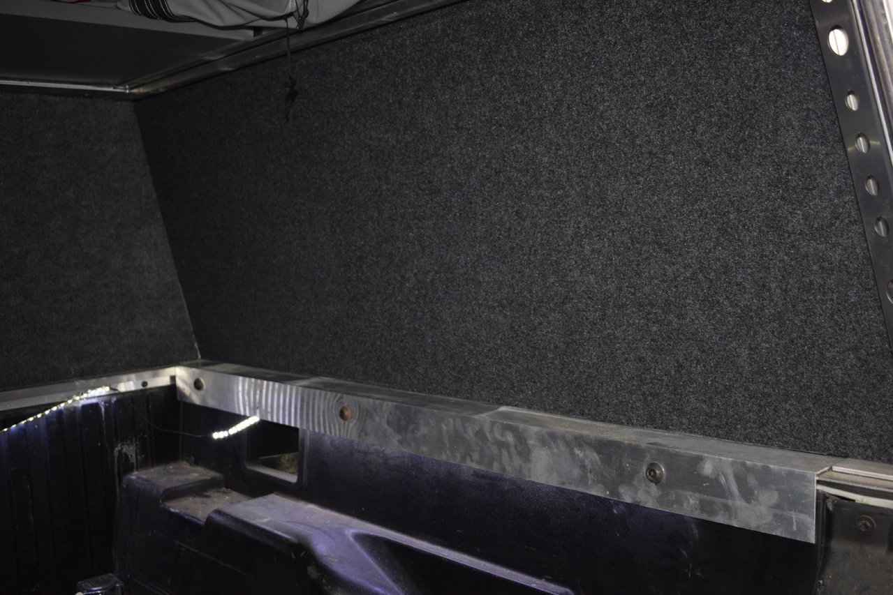

    I carpeted the interior walls myself. This was a surprisingly easy and affordable task. I just measure the approximate panel size needed, get some spray adhesive from your hardware store and smooth it out with your palm, and trim with razor bladeand straight edge. While I was doing this, I took the opportunity to trim down the large aluminum bed rail mounts that are used by AT to give my bedrail LEDs some more coverage (they were being covered by the big surface area of the AT bedrail mounts) and also tapered the ends so they didn't look so clunky.
    I also mounted the two support poles using Kayak paddle holders found here for 8$:
    https://www.amazon.com/gp/product/B01BZJO16S/ref=oh_aui_detailpage_o03_s00?ie=UTF8&psc=1
    and added some d rings (need 2 more) found here:
    https://www.amazon.com/gp/product/B01CGXSNC0/ref=oh_aui_detailpage_o09_s00?ie=UTF8&psc=1
    Here are a couple pictures before/after the rails were trimmed and carpeted. (still haven't finished trimming the carpet in spots)

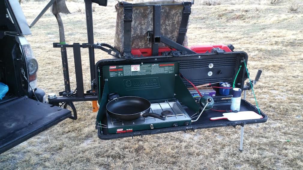

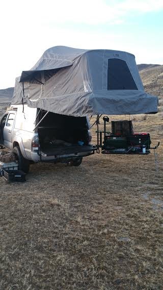

    One of my main objective's of this buildout is to keep things light as possible. A swingout was necessary to open up some space in the bed. All the swingout options right now are WAAY overbuilt (and heavy) for what I needed (not using for a spare tire) So I decided to build my own around the factory bumper. On one side is the 42'' plano box that I use for kitchen supplies that doubles as a fold down table. It fits a standard coleman grill PERFECTLY and plenty of room for other stuff. The other side holds an axe, shovel, an aluminum 6lb propane tank, 4 gallon rotopax, and trasharoo. (need to get better pics)
    There is a bunch of other stuff I have done (modified prinsu to fit, removed tailgate panel and made a flat surface, ABS panel for table surface in plano box, other little random stuff) but it was alot to write in one post I'll work on getting better pictures and details of everything.

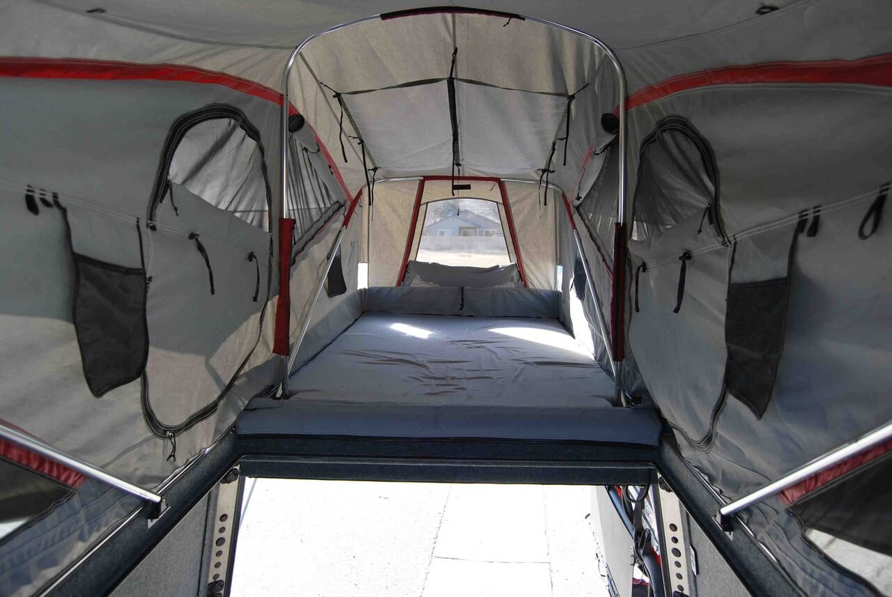

    Photos inside the tent?

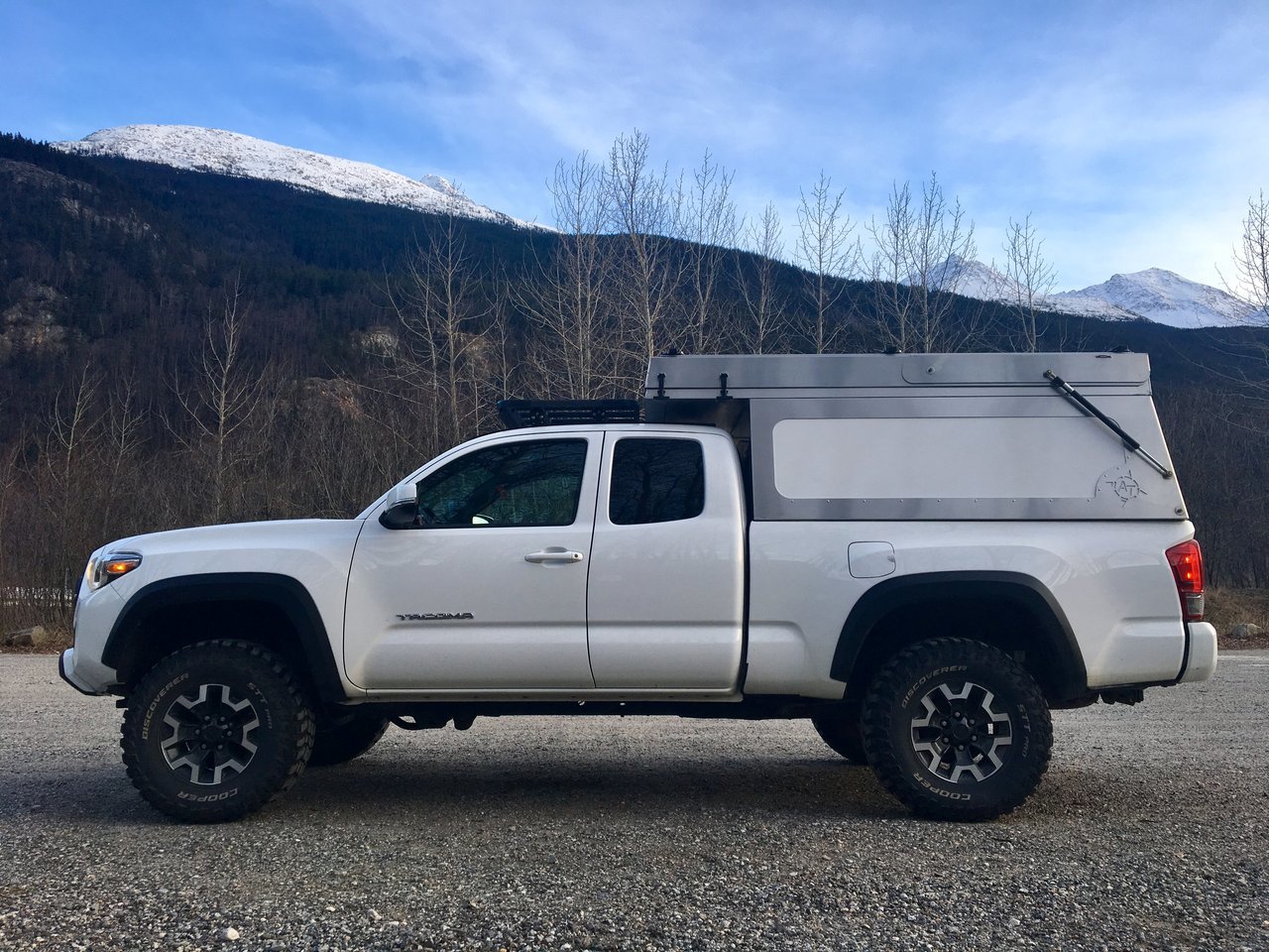

    Awesome! I’ll post up some of my mods a little later. Thinking about mounting some l-track as well. There’s two strips on my roof for the rack.
    I’ve been using mine for almost 2 years now. Probably 200 nights spent in it. Only wear issue is the end connector on one of the support poles cracked. Ordered some replacements. Also there is a leak where the habitat meets the bed , front passenger corner. I have one of the first ones made, so I’m curious if they’ve changed anything.

    What roof rack are you running? Doesn't look like Prinsu, unless they updated their design for Habitat setups. That's one of the next things on my list of mods, especially now that I have a fridge and need to get solar.

    It’s a custom Eezi Awn K9 rack. I bought it from the AT Overland guys. I use it for solar all the time. Just ratchet strap some panels up top and run it to my dual battery when I go on trips where I might need it.
