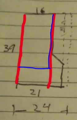

    I was actually in the middle of typing up a response on this last night when all Hell broke loose in my culdesac.
    Box is just made of some plywood, a 2x10 or 2x8 (can't remember right now), and a piano hinge.
    Here are the base dimensions and rough drawing. Base being 21in wide on the end with the Battery switch, and the top being a 24 x 39 rectangle. The red lines are the 2x10s, The blue line over the red is where the piano hinge is located. The blue line generally depicts where the "door" is that opens up to see what's inside, piano hinge being the longer blue line. The 16in end towards the cab does NOT have anything covering it, giving more ventilation for any heat from the electrical.
    My fridge is quite large at 75L. With the Habitat closed I cannot open the doors fully, but I still have no trouble packing it with full sized gallon jugs and such. I just can't remove the internal basket in the fridge without popping the Habitat loose. It's never been an issue though.
    If you've got any other questions let me know. It was REALLY easy to make the box, and CHEAP.
