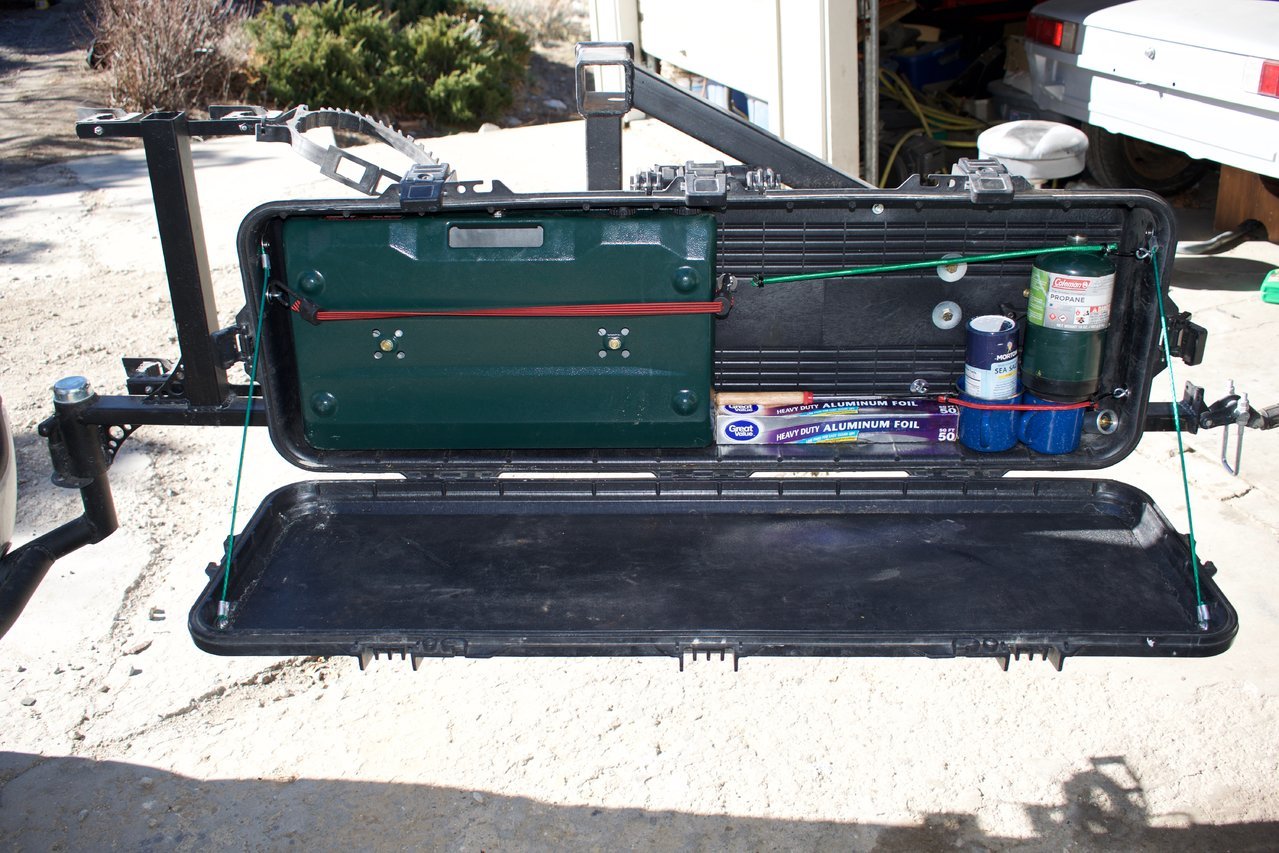

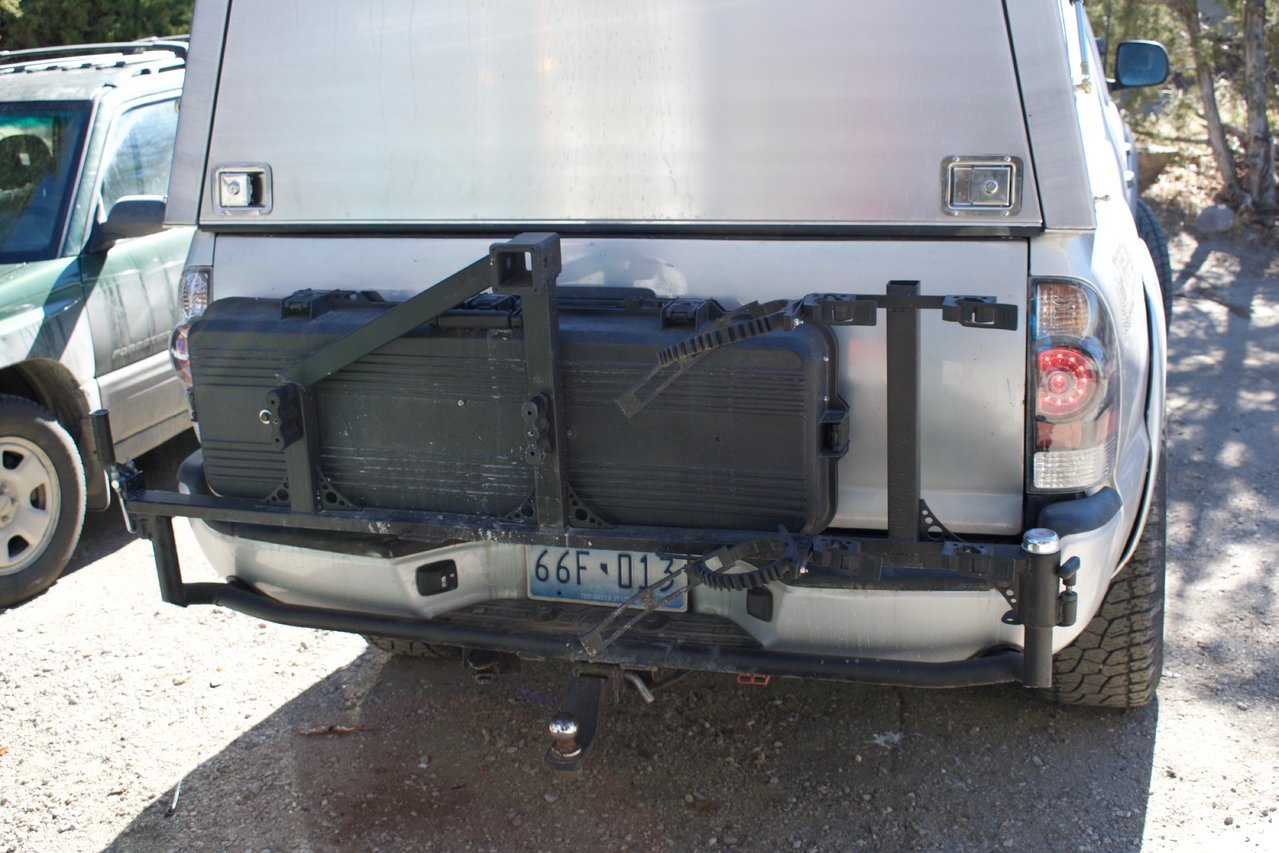

    At the request of @yellowdogpaddler and @crazysccrmd here are some more pictures and details of the swingout I made around the factory rear bumper.
    There were quite a few important goals when building this;
    1. To keep things as light as possible.
    2. To be able to mount a 42'' plano waterproof lockbox on the inside of the swingout so I could utilize it's lid as a fold down table.
    3. To retain factory bumper with license plate mounting / lights and a clear view of plate.
    4. Retain usability of factory hitch.
    5. Get as much as I could onto it and out of the bed for more room.
    6. All without having an affect on my departure angle.
    It is bolted to the frame using factory hitch mounting points with 3 bolts on both sides (for a total of 6) and I also tied it into just above the rear hitch where those two large vertical bolts are.
    I also utilized a trail gear bolt together tube clamp for the middle, so that it easily brakes into three very light (and there for very easy to install with one person) pieces; the passenger side, the driver side, and the swingout portion.
    I used a standard 2'' female receiver on top of the swingout as I figured this gave me some good modularity. I am currently using it with a custom bracket I made to hold the trasharoo, that way I can easily remove the trasharoo when not needed.
    Rear view shown with rotopax off

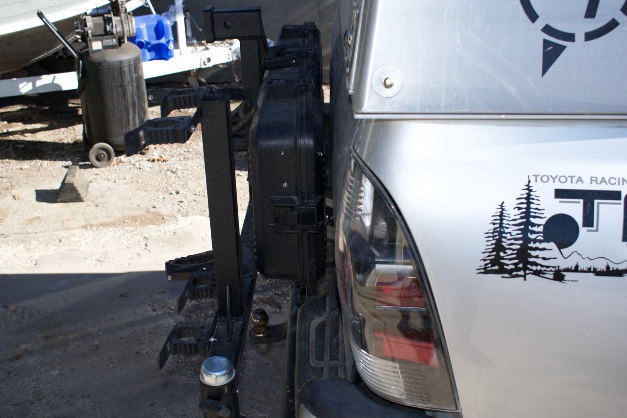

    Side profile showing clearance for plano box:
    Picture showing how bumper was trimmed for clearance:
    Inside "chuckbox" Not seen is a cast iron pan and a roll of paper towells. We are still setting up the aluminum propane setup so using 1lb tank now. You can also see in this the ABS sheet we used for the "tabletop" on the fold down portion. When you order these boxes they come with a glued in foam panel, and under that is a rough surface with corrugations. The ABS panel provided a flat spot for setting important stuff like beer.
    Showing clearance, middle bumper tie-ins, and also the bolt together tube clamp can kind of be seen in the center.

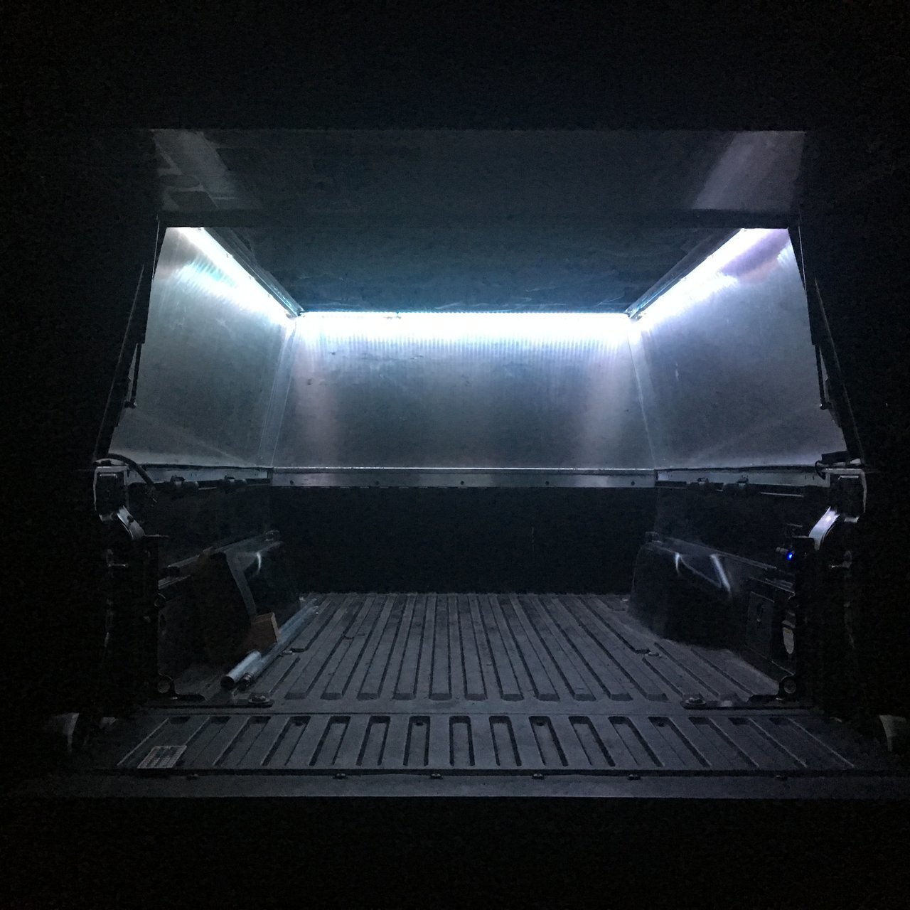

    The lip running along the top of the habitat is the perfect place to hide an led light strip. Most of these strips are dimmable and have lots of color modes.
