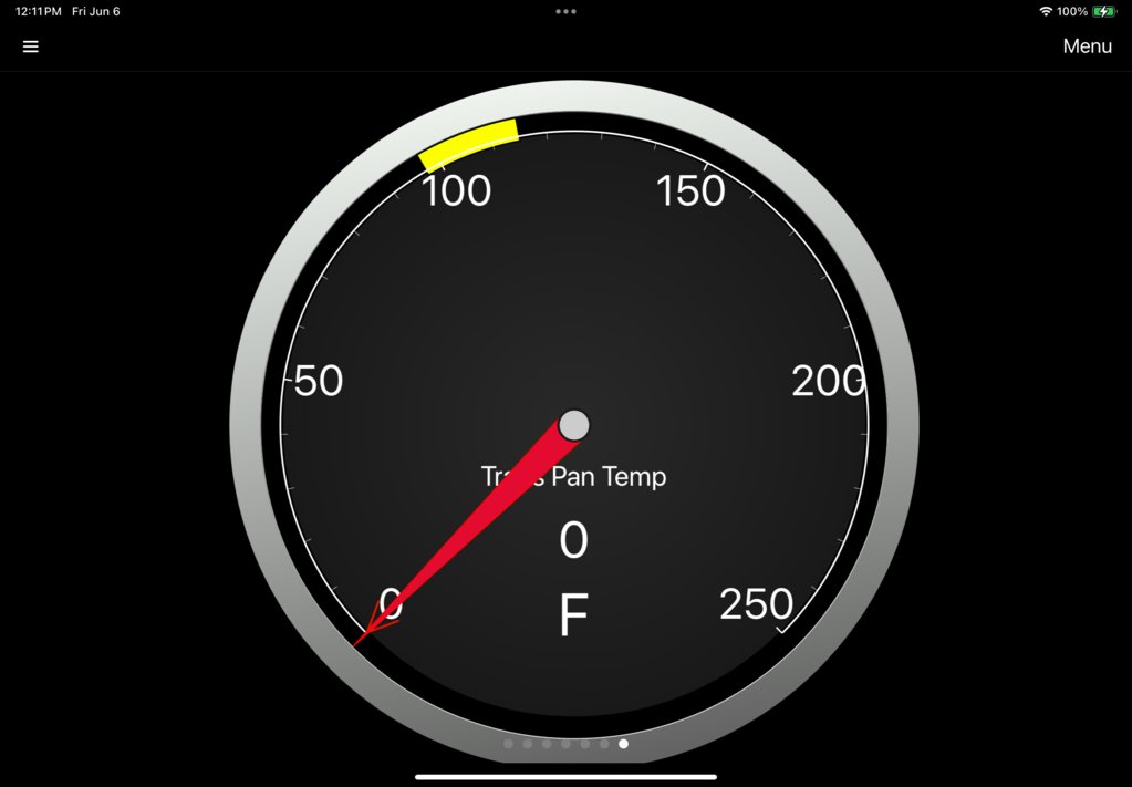

    The fusion app is cheap and easy to use after you load the pid’s
    When she hits yellow, check that fellow.

    Faye compared the temperature readings from a scan tool and an IR thermometer and found them to be very close. Personally, I'd recommend picking up a temp gun and checking the fluid when it reads around the minimum required temperature (97°F — with the actual fluid likely being about 5°F higher). In my opinion, this method is much easier.
