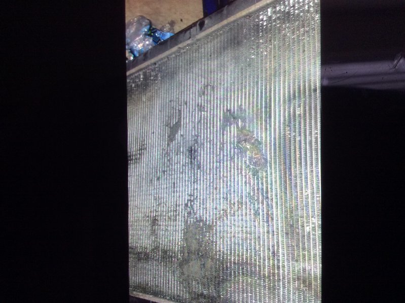

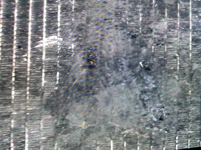

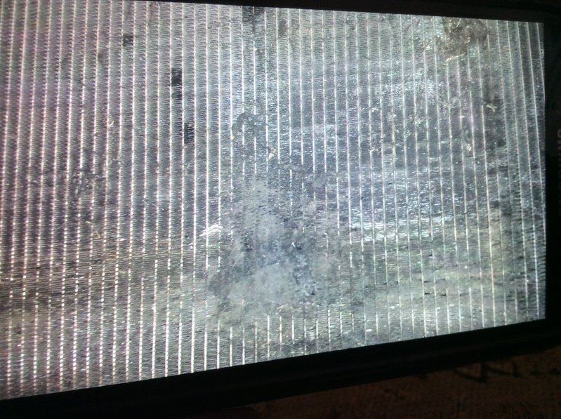

    Same problem my fan clutch would not disengage, sounded like a vacuum cleaner all the time, so I replaced the fan clutch and still did the same thing sucking all my power, decided to take the radiator out and guess what, behind the AC condenser, the radiator was packed with
    mud and dirt, bugs, leaves, you name it, was like a brick, was that hard. I couldn't see any of this until I pulled the radiator because of the AC condenser is covering 3/4 of the radiator, now a new radiator and thermostat now runs even better, AND MY AC IS COLD AGAIN, guess the condenser was not cooling off because the radiator section behind it was plugged
    Guess after 503,000 miles it time for a new one anyway,;)
