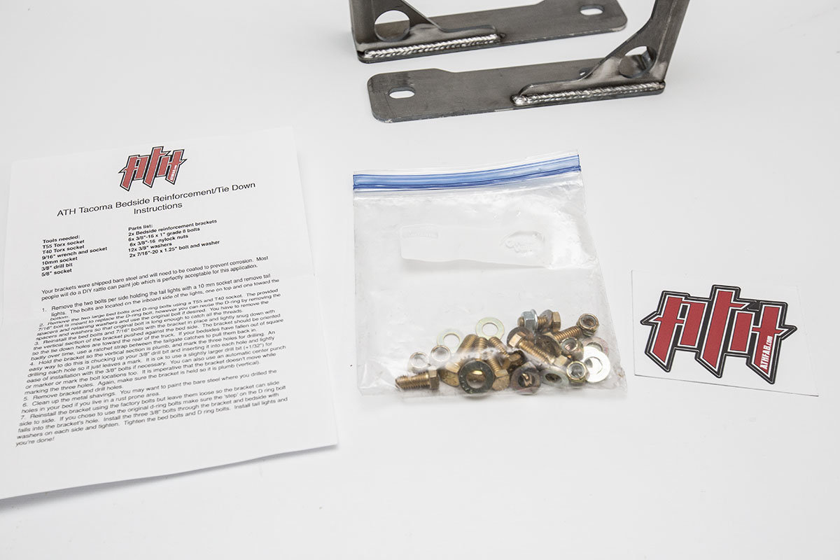

    The ATH Bedside Reinforcements come neatly packaged in stretch wrap, with a sealed bag of fasteners inside. Both pieces are bolted together to prevent movement.

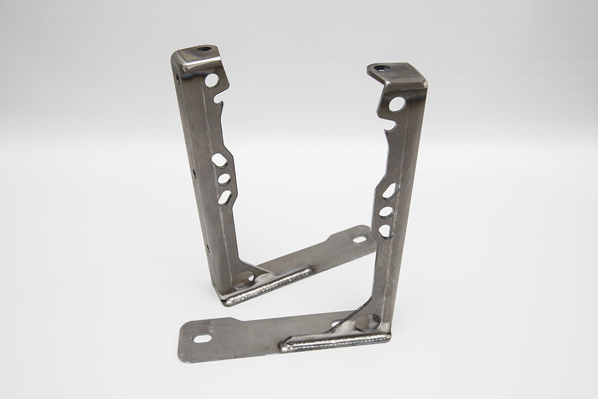

    Each bedside comes with five tie-down points; the top plate has a mounting hole for an antenna or auxiliary light for illuminating the bed. Additionally, there’s a functional bottle opener on each mount.

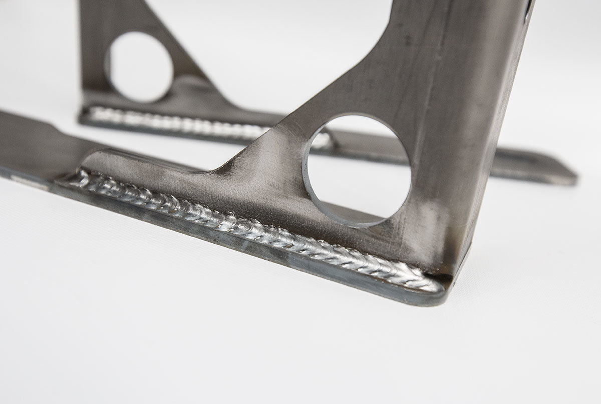

    Check out those welds! The proverbial stock of dimes comes to mind here. Each part is CNC laser cut, welded cleanly, and ready for use.
    Here’s a look at what’s included with the ATH Bedside Reinforcement package: a complete pack of grade-8 zinc-coated fasteners, east to follow instructions for installation and an ATH decal to proudly display.

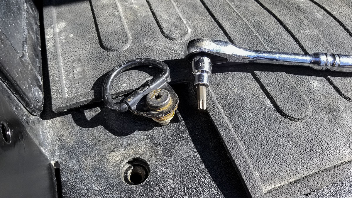

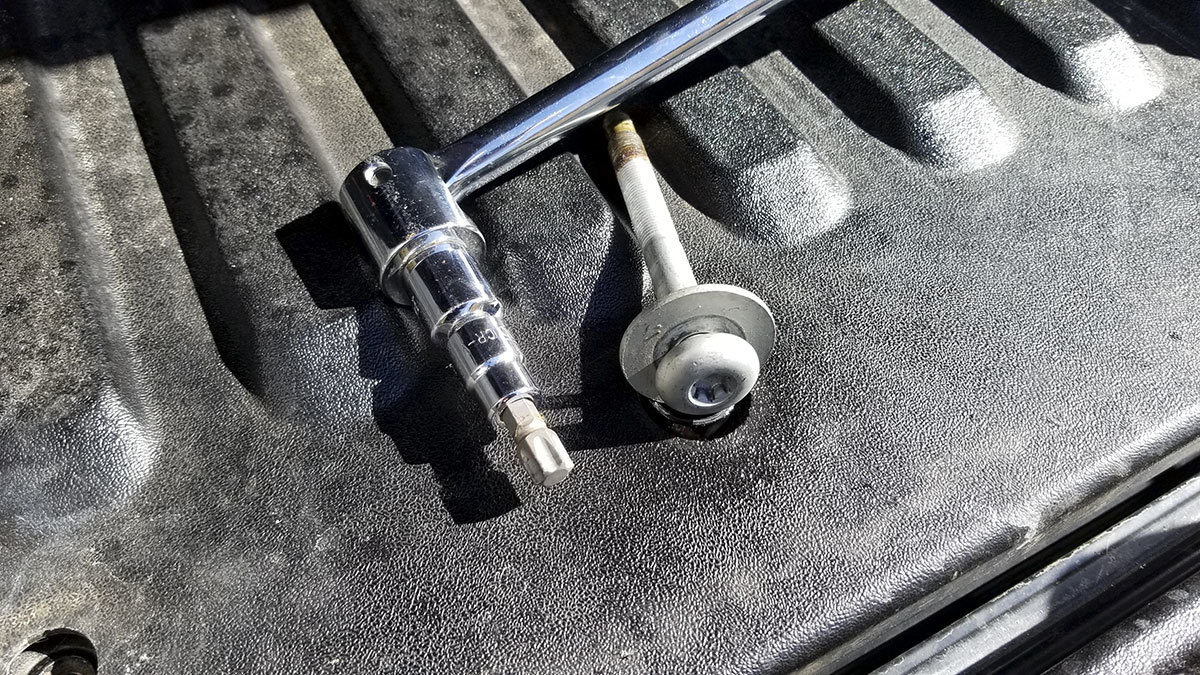

    Next, remove the D-ring bolt and bed bolt on each side. The D-ring bolt uses a T-40 socket and the bed bolt uses a T-55 socket. All four bolts took some persuasion to loosen, thanks for numerous salty Northeastern winters. I sprayed each bolt with PB-Blaster from the bottom and freed them from their rusty grips with a breaker bar. The D-ring can be reused if you remove the bolt and use the included hardware; I opted not to use it as there are plenty of attachment points on the Bedside Reinforcements.

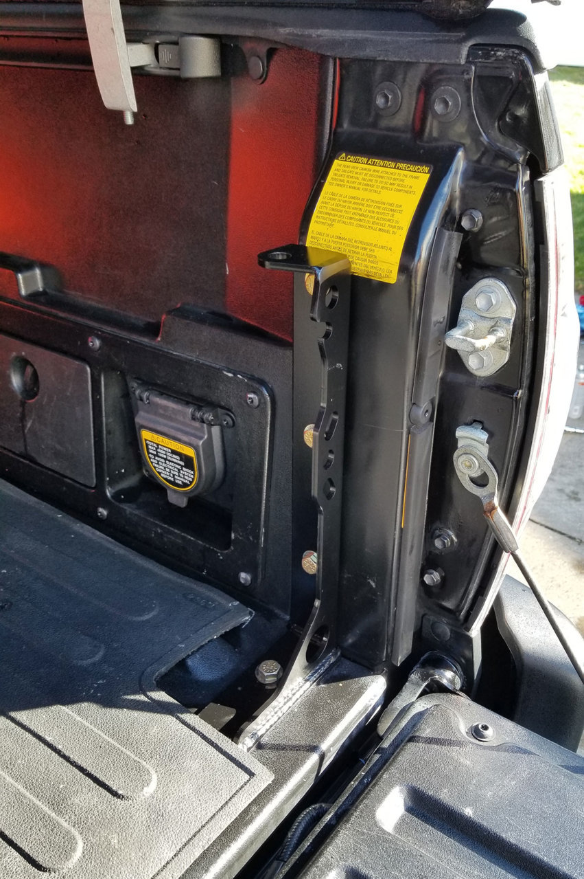

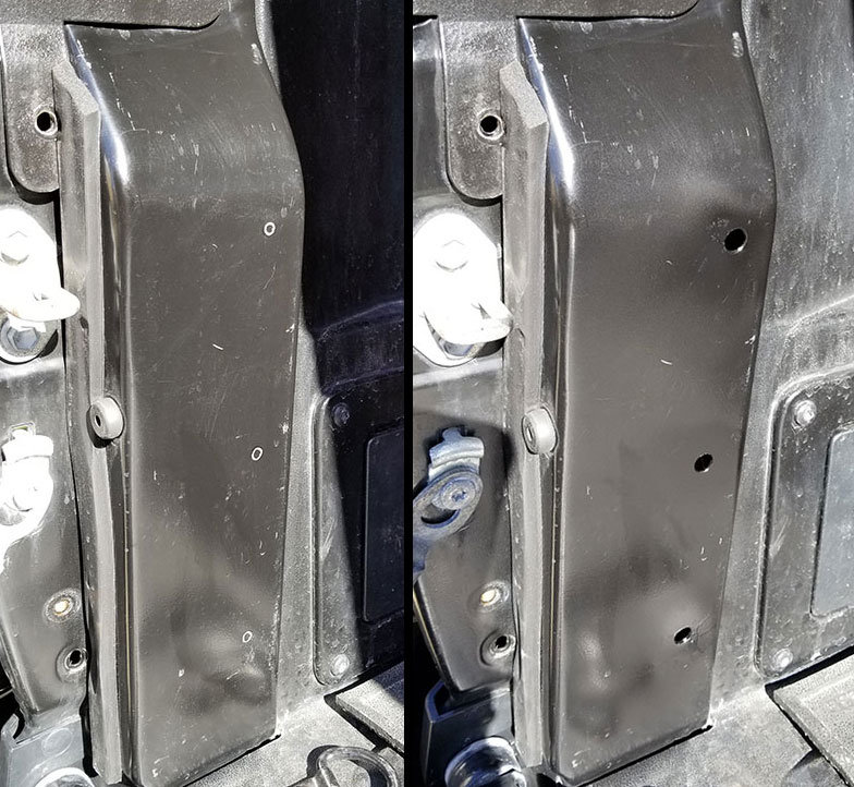

    Now it’s time to mark our holes for the 3/8” bolts. Test fit each Bedside Stiffener and snug them down with the T-55 bolt and 7/16” bolt that replaces the D-ring. Mark the three hole locations with a permanent marker or center punch, remove the stiffeners, then drill them out with a 3/8” bit. Make sure to paint those freshly drilled holes with some rust-preventing spray on both sides.

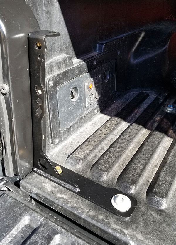

    All that’s left to do in this installation is bolt down the ATH Bedside Stiffeners; install the T-55 and 7/16” bolts on the floor, leaving them loose as we snug down all six 3/8” bolts. Once they are secured, tighten the floor bolts, reinstall the taillights, and take a step back to admire your quick installation!

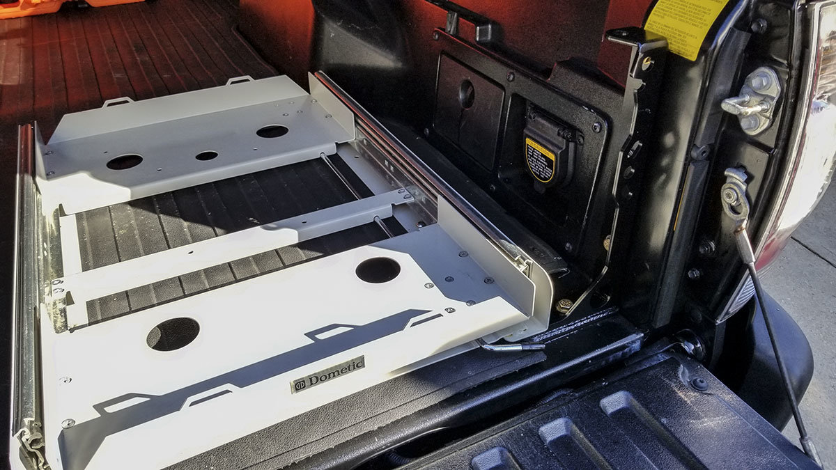

    The ATF Bedside Reinforcements have a low-profile design that doesn’t interfere with mounted accessories in your Tacoma’s bed. I was able to keep my Dometic fridge slider in its original location even after bolting them in place.

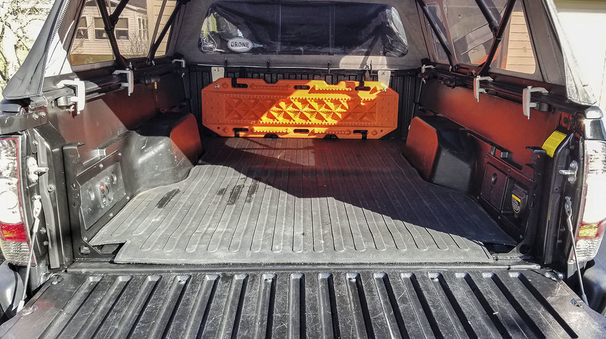

    The bed stiffener is a functional hunk of bent and welded metal that keeps the Toyota Tacoma’s bedsides true while off-roading. ATH Fabrication has taken the stiffener to the next level by incorporating a multitude of tie-down points, accessory mounts, and a bottle opener into the design. So secure that payload, head out on the trail, and enjoy a frosty beverage at the end of the day!
