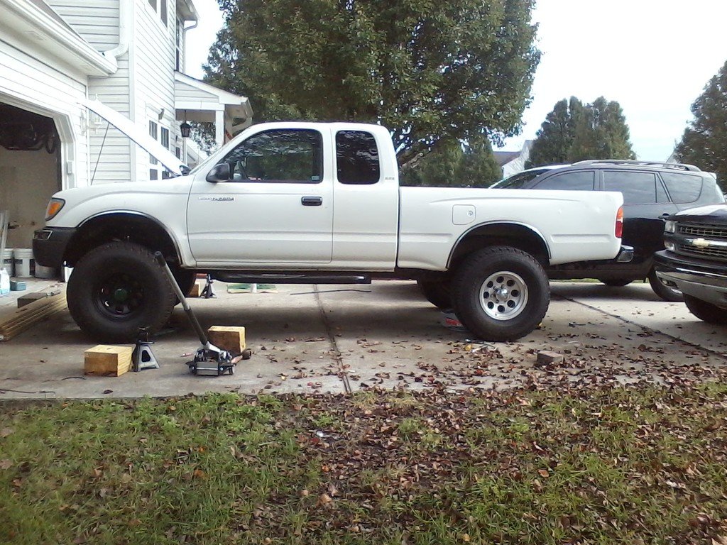

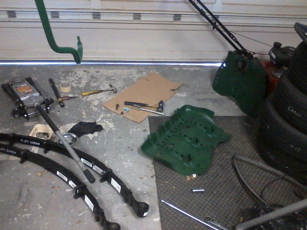

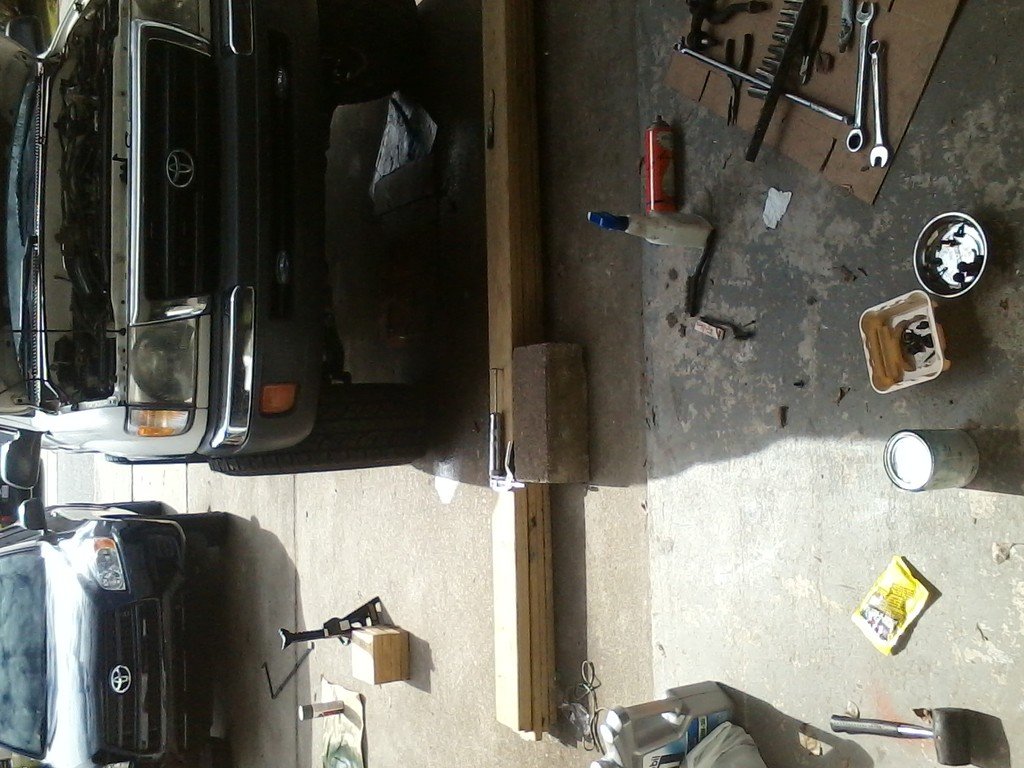

    I'm a Craigslist fiend and one lonely day came across what I think might be the deal of a lifetime. A local guy threw on a brand new set of Camburg UCA's and Tundra TRD coils and Bilstein shocks for 500 bones. I basically ran out the door yelling "Honey, I love you, I'll be right back, no time to explain." He had received these in error and I guess got to keep them, don't know how that works but... The only thing I found wrong with them was that the metal sleeves were for the Tundra not the Tacoma. Amazingly enough I called Camburg and explained, they actually sent me the new sleeves at no charge, so kudos to them. I'll use them in the future for sure.
    This then prompted me to pull the trigger on getting the All Pro Offroad rear kit to match everything up. This was a horrible mistake. I recieved the leaf springs and they were already rusty as hell. I called them and was advised they'd had gotten other customers saying the same thing and that they just hit it with a little Rustoleum black paint. I asked for a few bucks returned to my card to cover the paint and was told no. I had everything I needed in the garage already so no worries. I moved on with my life.
    Sadly when I started pulling all my old stuff off my bolts holding the front shocks on were completely seized as were my rear shackles and one of the eye bolts. I went ahead and took an angle grinder to them and ordered bolt replacements from the local dealership. If you have to do this make sure you specify that you need the washer and the nut and the total might be close to $20-40 depending on how many you cut off.
    I now also needed new shackles and loved the idea of having greasable ones. Since All Pro's shipping was fast and easy and there website was easy to navigate. (Like I said before I'm a bit special and that easy to use website is a huge bonus to me) I gave them another shot. Once again not impressed. They sent/charged me for more bushings even though I had the ones that came with the leaf springs, and once again the bolts now came rusted to all hell. I called them again to let them know but this time wanting money back for sure. I didn't specify how much but the actual owner called which I thought was amazing and a great gesture of the company and advised I would be getting some refunds. This was also because they never applied a military discount to my orders. That was about 4 months ago, the greasable bolts are disgustingly rusted now, my leaf springs are showing major signs of rust (I should have taken them apart to treat them because the insides I couldn't get at is whats rusting now), and I never did get that refund. So I highly recommend anyone looking into this company to look else where. The Deavers are more expensive but probably wont rust on you right away. Sorry for the rant...but the story needed to be told.
    After all set backs I got everything replaced, and the truck drives great now. This also fixed the axle wrap I was getting that I was mistaking for the tranny shifting hard.

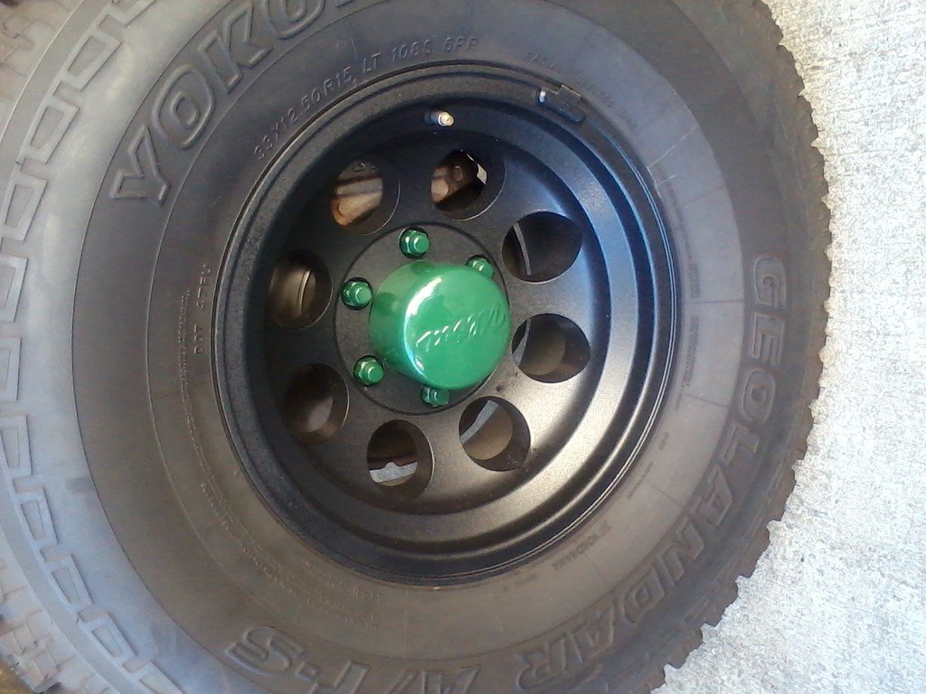

    • painted my wheels

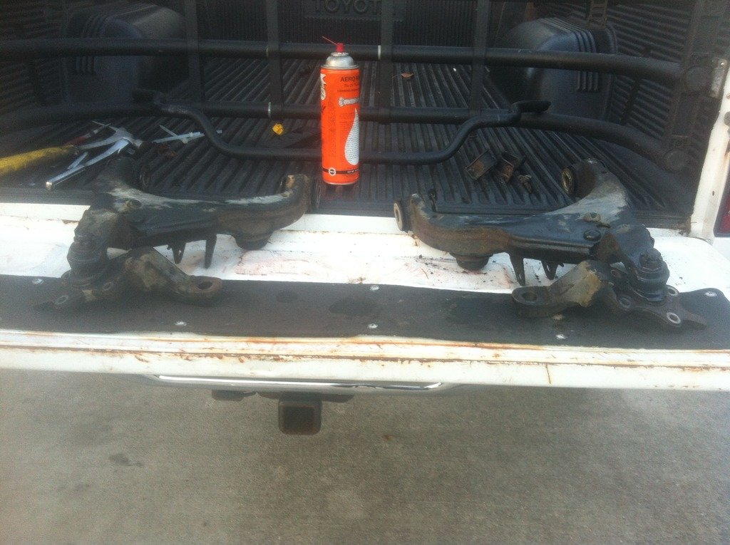

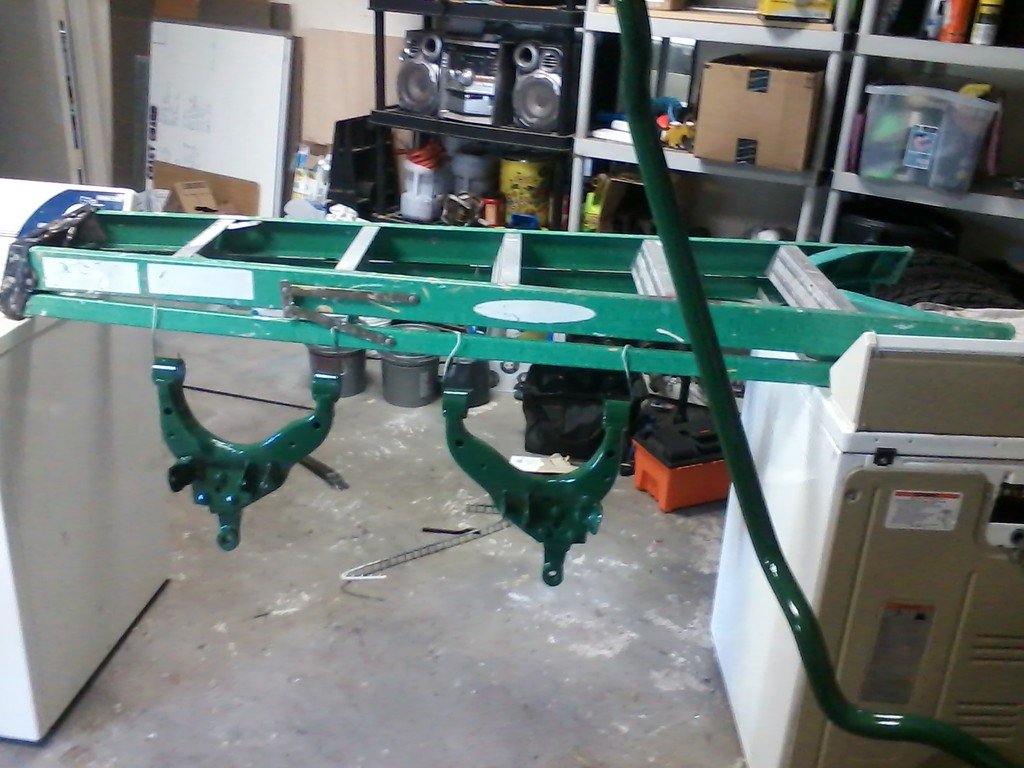

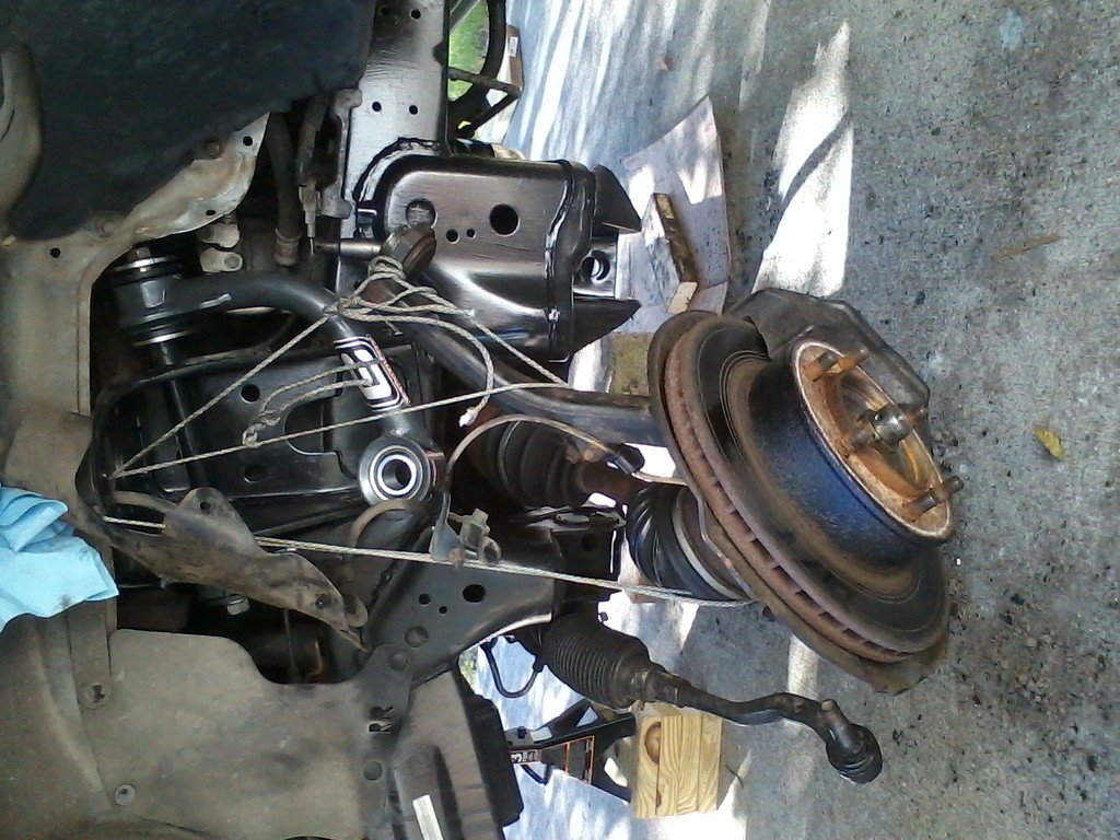

    1019151546-01_zpswtywu1wa_99d2752848bbf832b11ec75a7700dd12ddbeda3d.jpg 1019151546-00_zpsvbtl79hr_4d9eb27f41c82ea2f12a0c936cdfd7791d0c2b54.jpg
    Camburgs in and also a shot of my old tie rods, rotors and calipers before I replaced them.
    1019151545-00_zps4u6ceggj_199985c248ed1c89d41401d31afd0920079d6b6f.jpg 1019151544-01_zps7djbs9yz_9f8f834bd9fe8ee30e6e0eca45b63ff390a36173.jpg

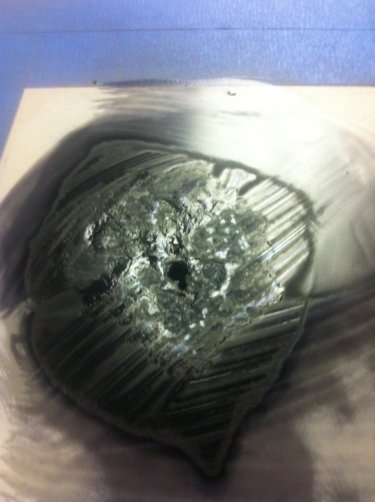

    My skid plate a rusted so bad there was a hole. So I filled it in and covered these bad boys with Corroseal (100% awesome rust converter off of Amazon) Used it on my sway bar, LCA's, leaf springs, and wheels center caps.

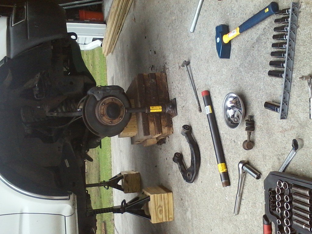

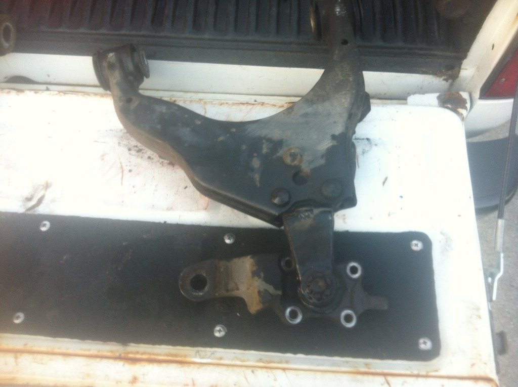

    IMG_4237_zpsmf5ixkzl_23a66a379e3ed37e2cedd79493381a09dd18f6c0.jpg IMG_4236_zpsnkslc1ev_66743f56451bb1fd55c91b6684245704d19dcb88.jpg
    The bushings on the LCA's are hard as hell to get off. Had to use the ball joint press and a torch.
    This is with just the front done and not the rear. Serious rake on her. Also painted the wheels while they were off with Rustoleum's bed liner spray.

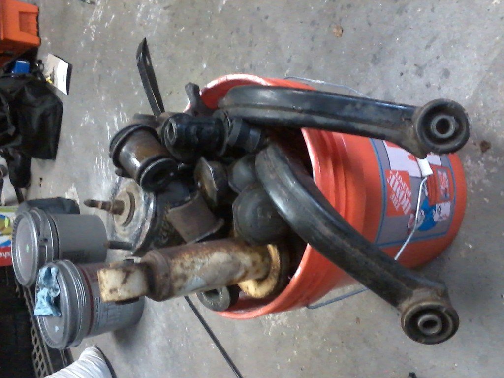

    Bucket of old parts

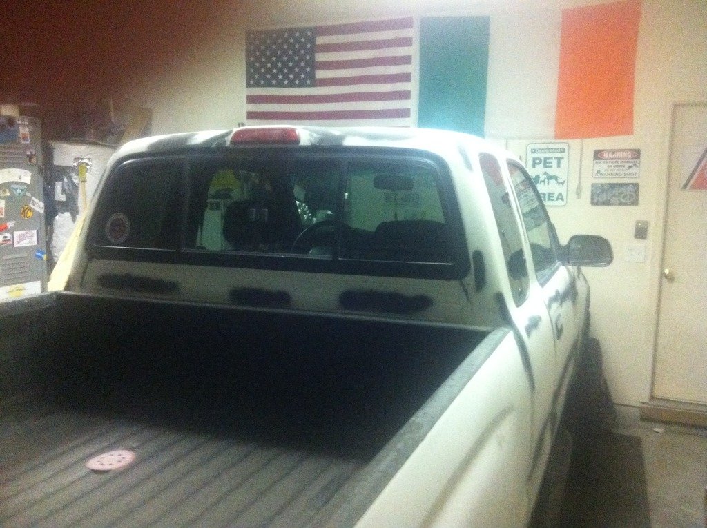

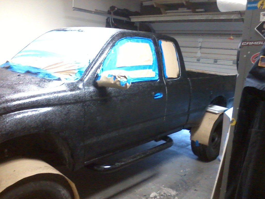

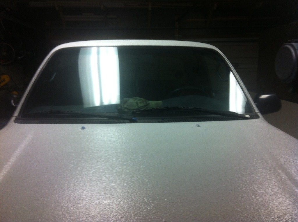

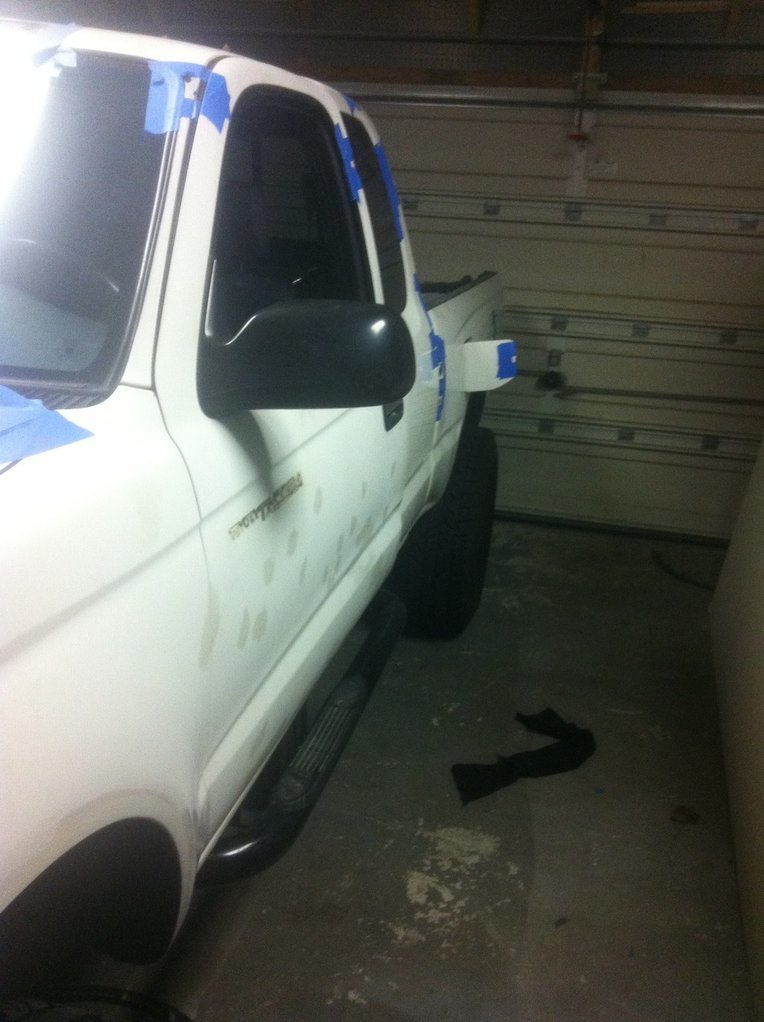

    When I bought the truck all clear coat was gone, on the top there were multiple rust spot as well as a few on the front under the headlights. Id been researching for the last year the best way to paint the truck as I don't have an air compressor and finally decided using a roll on bed liner (Herculiner) would be the best approach. So after I begged and pleaded with the wife I was on my way to Lowes.
    I grabbed:
    • 2 gallon kits of Herculiner
    • 3qts of gloss white Rustoleum paint
    • 7 cans of clear coat
    • tape, trays, and paper
    • All together a little over $200

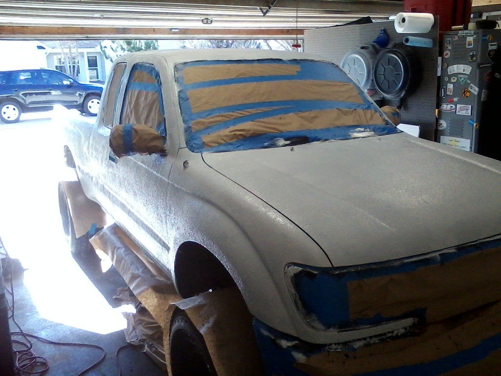

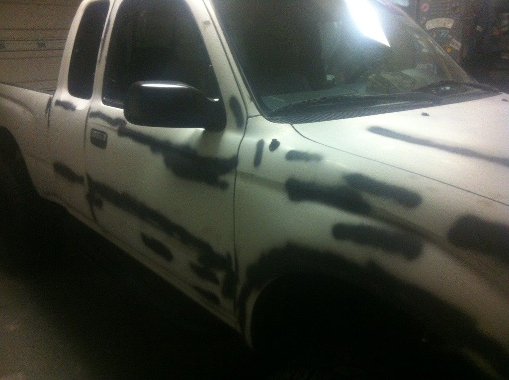

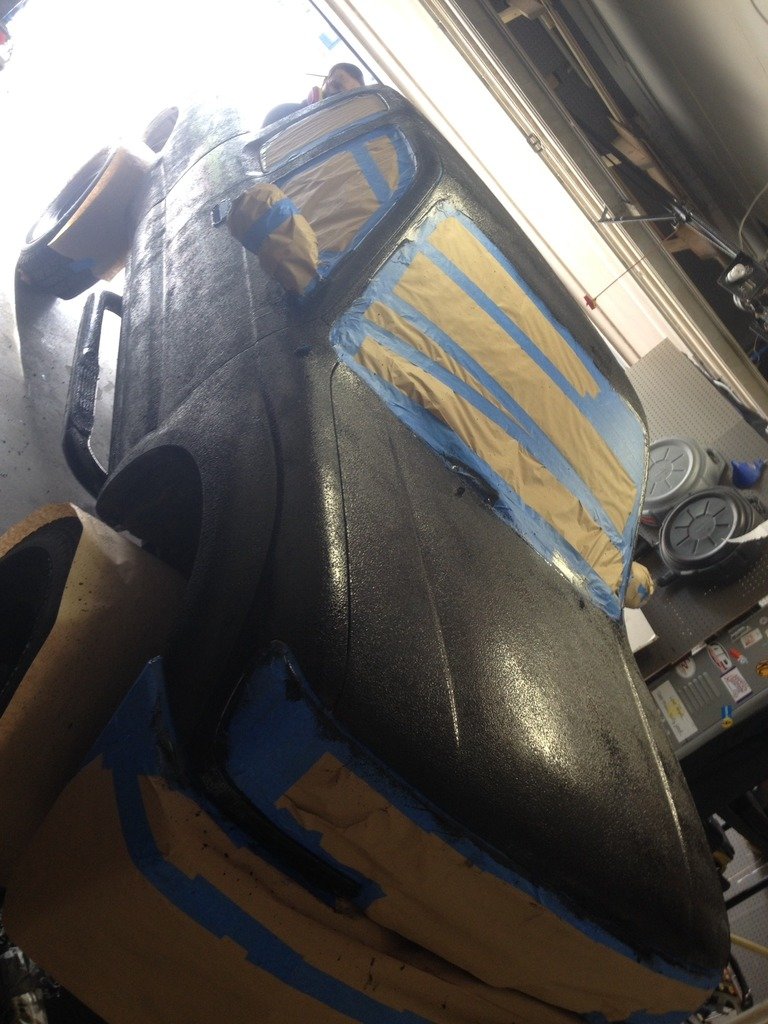

    The process consisted of a light coat of Herculiner, followed by a slightly heavier coat, and then a super thick one. I let it sit I believe 24 hours and then applied three coast of the white. Then just sprayed the hell out of it with the clear coat. If anyone else tries this I'd highly recommend taking off the tailgate, lights and at least the rear bumper, door handles and mirrors. This would have come out much better if I would have myself. So far its holding up great and I get compliments on it all the time. I also hit my running boards with the Herculiner for better traction.

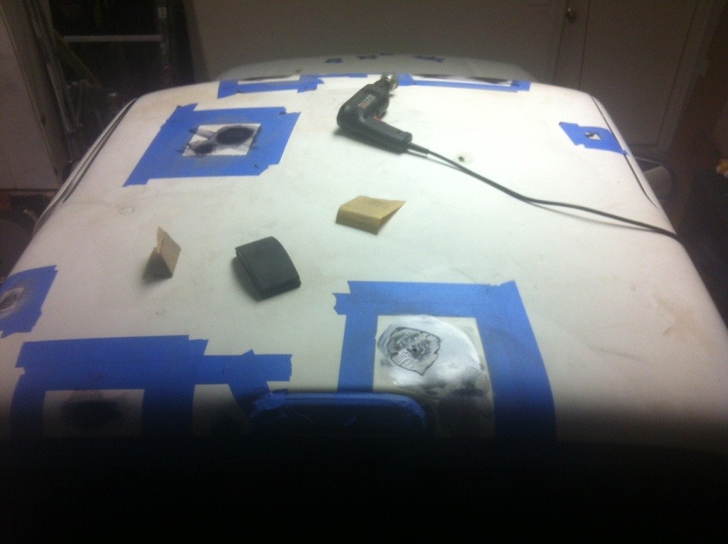

    So I sanded the whole thing down and anywhere I got to bare metal I hit with some primer.

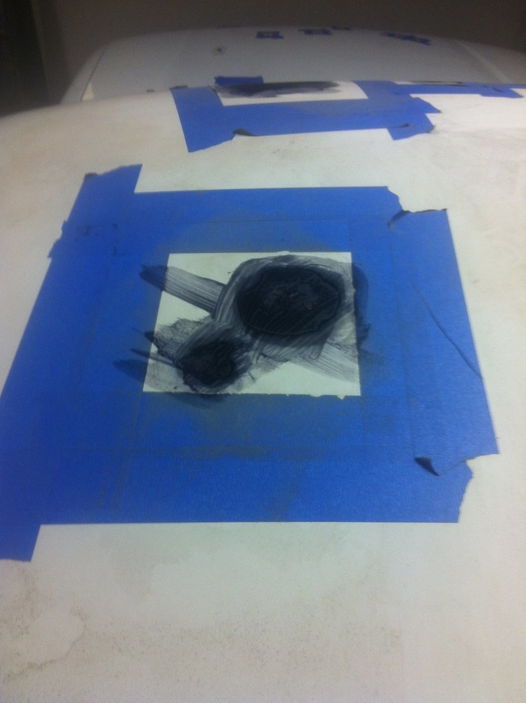

    IMG_4347_zpsv0zm0llw_3e41426498877cc6e96851fc1ca3f42290cf4242.jpg IMG_4346_zps9fp87prw_814e961dee8eeaf1ebf22b346636765af6481a19.jpg IMG_4365_zpshaac6w4a_63c3937b6213b30bced61be538859287f6b9fb52.jpg IMG_4344_zpsur25wsqz_02ede91bb19dd452f1dc77f3c0126800cff2d162.jpg IMG_4363_zpsneb44zue_5fd2c59f320bda58f889d4344874ded2b6f8210e.jpg

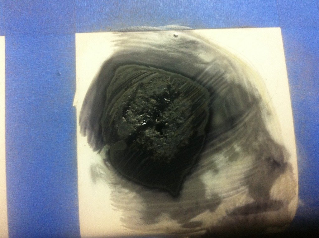

    This was the close up of the worst hole in the roof. I had to fill her in. The black stuff is the Corroseal after it dries and the its rust converting thing.
    IMG_4362_zpsshkjw1nj_f2ae231e3a93ec902fdcb7f26f950064d0f7c9c9.jpg IMG_4361_zpsj38tf71j_649f25e470341a3d0187547ce18accfaa393a6d9.jpg IMG_4340_zpsjpu13k9m_428e89c1345141d4537758115b295f746b2c3b33.jpg

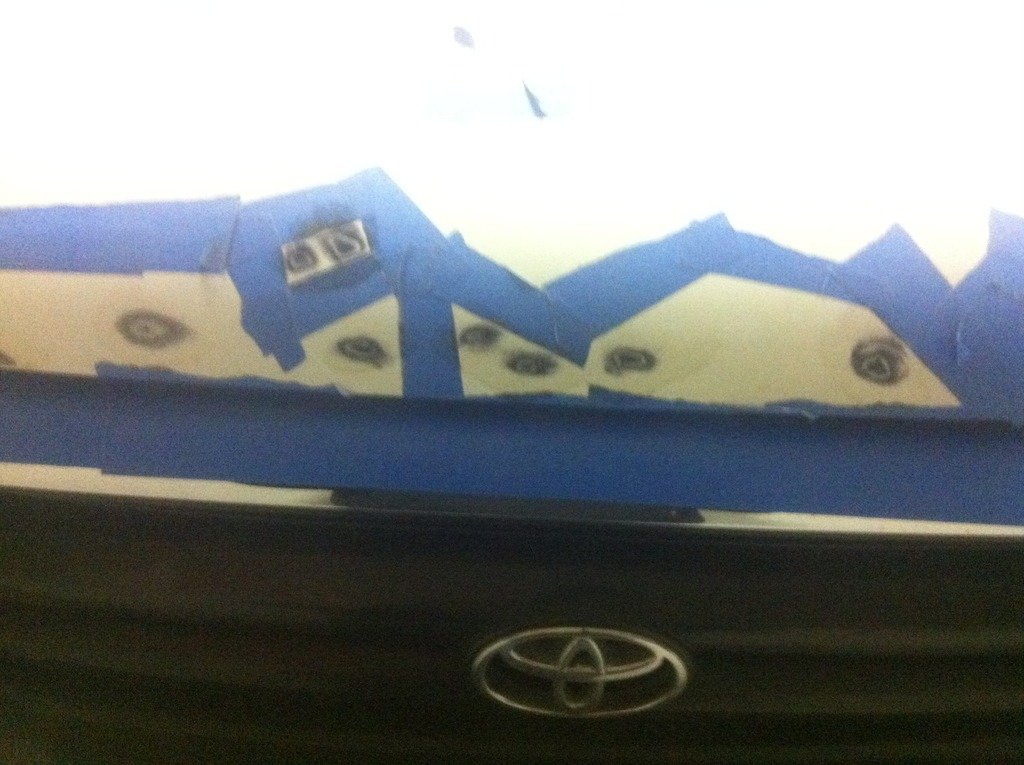

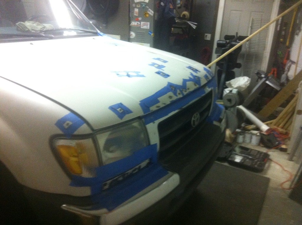

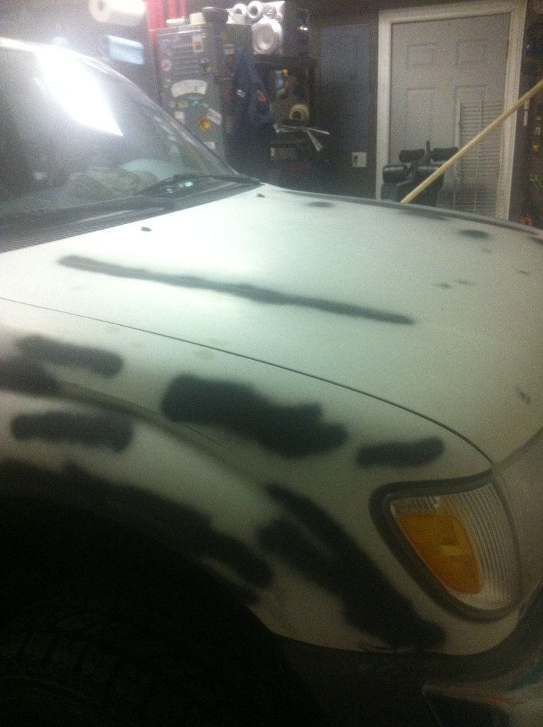

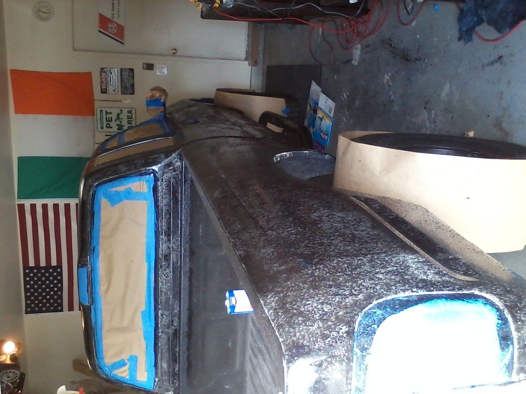

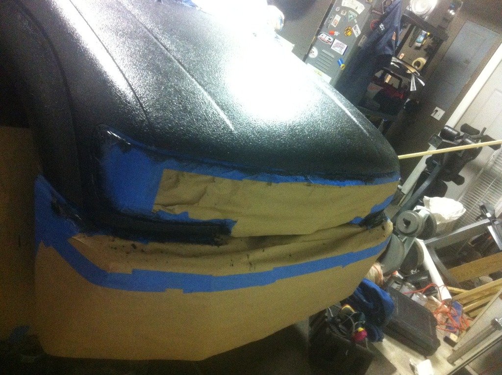

    I taped off the whole thing thinking i was just going to do touch ups and realized the whole damn thing was going to need a "touch up". Huge waste of tape.
    All the shinny spots are also the Corroseal. From the stuff kicked up I had little rust spots all along the door panels.

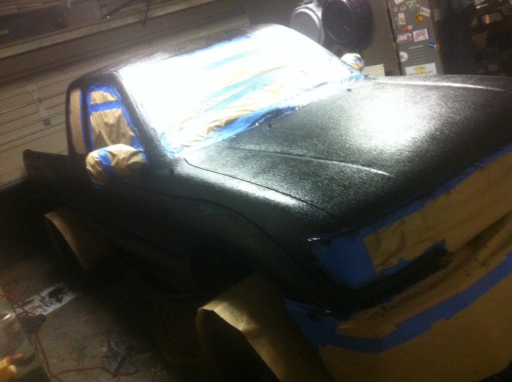

    The hood obviously had some of the worst spots.
    IMG_4357_zps5orgdw0k_bbcc0266a4625d6dfeb03a0c6c1775f10e11e01a.jpg IMG_4372_zps4gifpsai_ba8e0e5b63c788e619a66bfa961d23a496bf630f.jpg

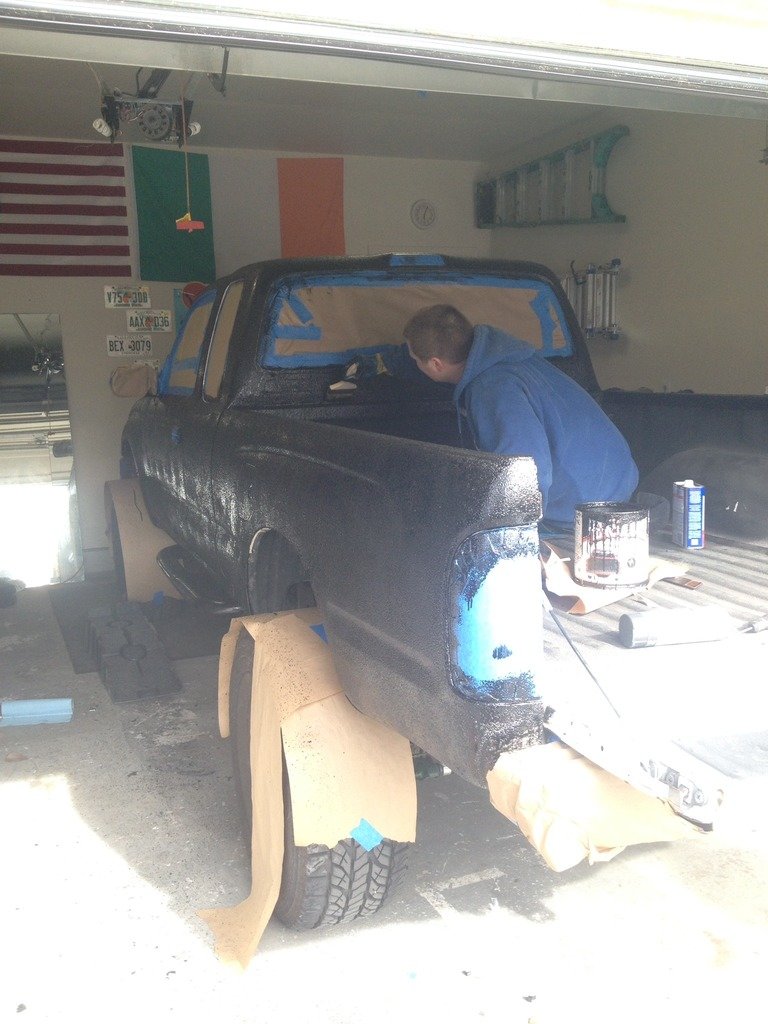

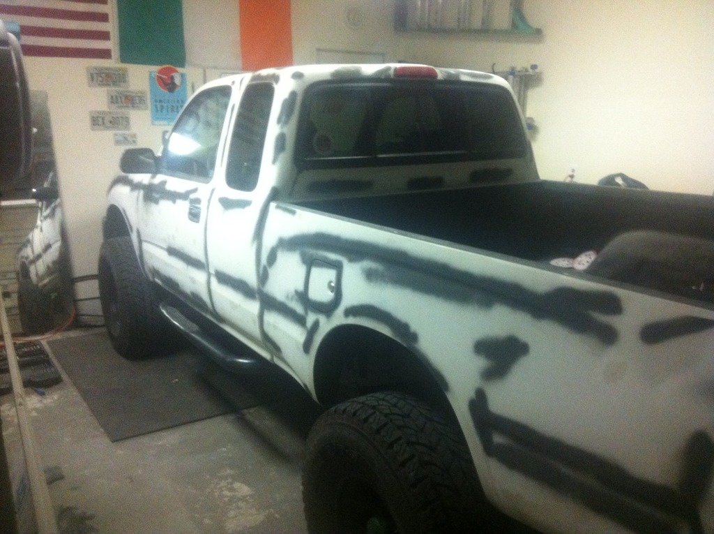

    Then she was black...
    IMG_4349_zpssbbv5ybz_8429d58c48c494f5e1e4e2daacc9ba82880b3593.jpg 0115161607-00_zpsqk4jf16x_80c18b590d6a2c32e88c4612098c00d64bc3a307.jpg IMG_4370_zpsg0nqifje_c9fc46f28e3f7f55c58ea34b7655e37b9088b72d.jpg IMG_4368_zpsoakurv1t_c062cdfdbb3b550b3e46a89019aaae7f7d793c97.jpg 0115161043-00_zpsocnz1qw7_d999ca3257f7b7c898200f5d94c18129c512153e.jpg
    This was the first coat I believe. You can still see a bit of the white.

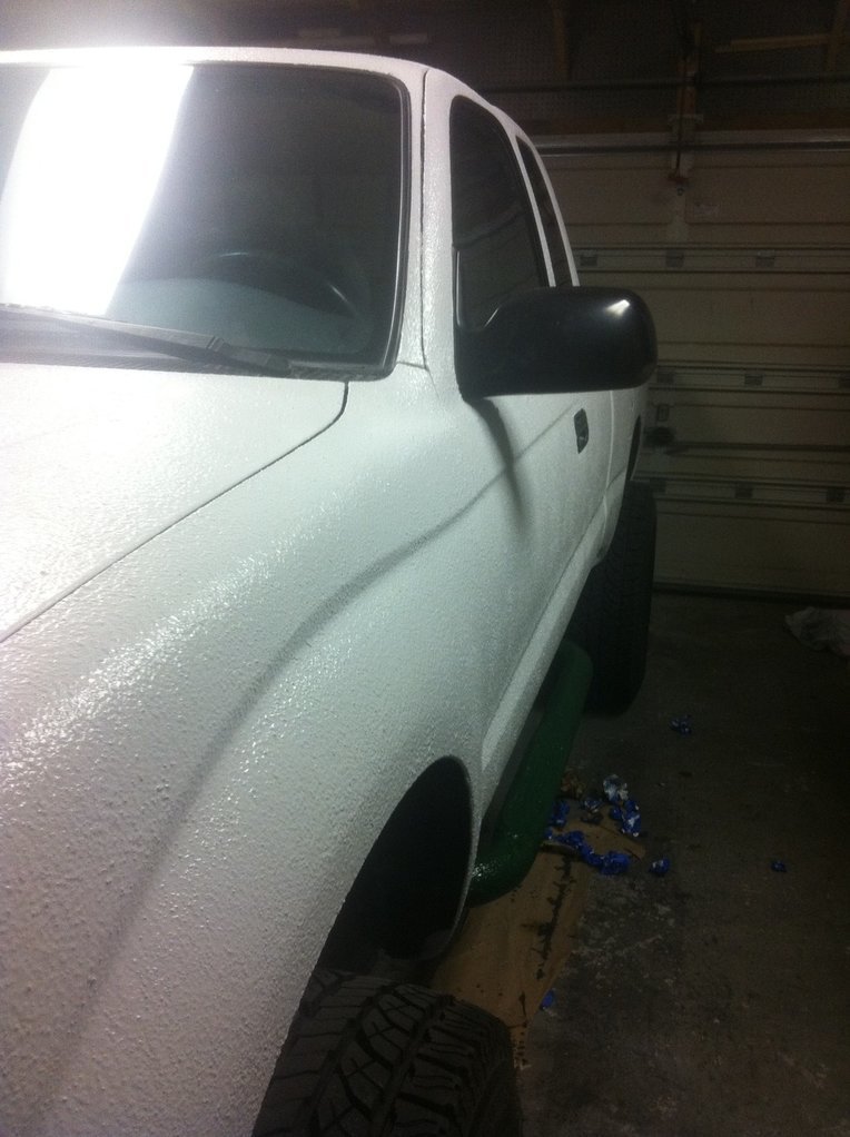

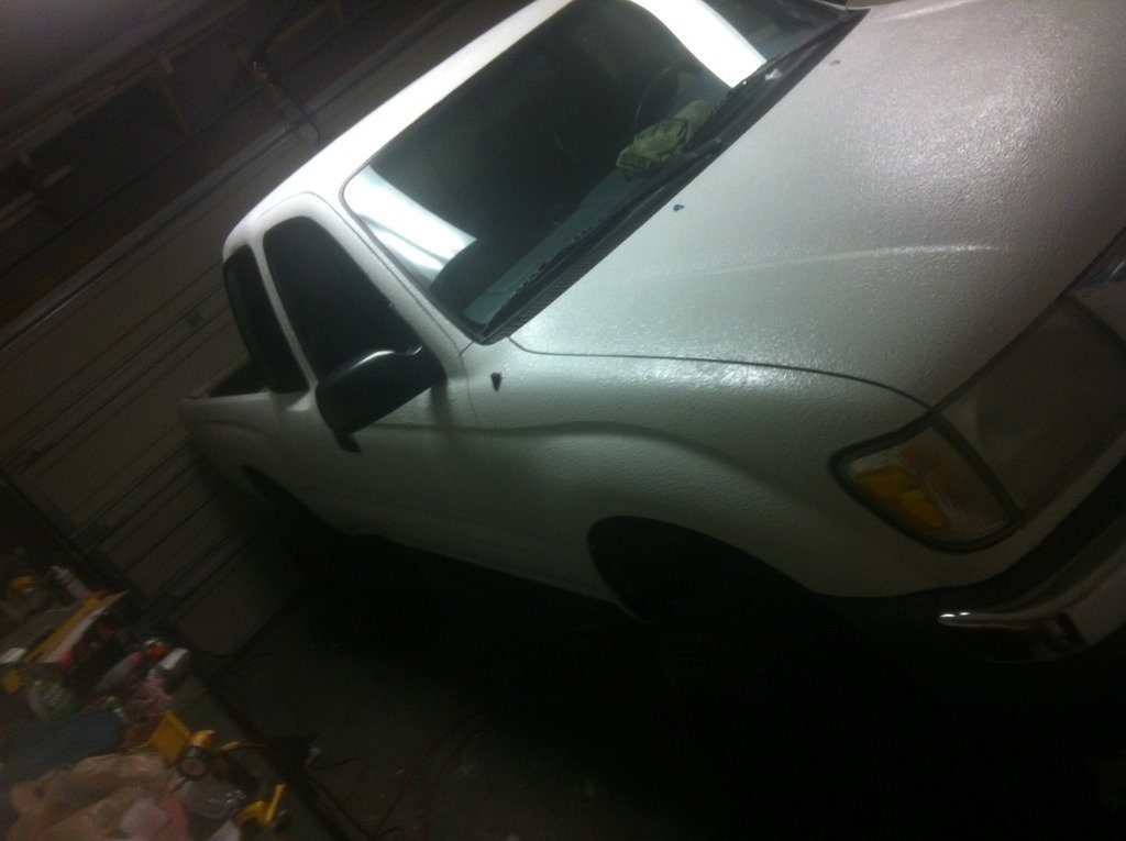

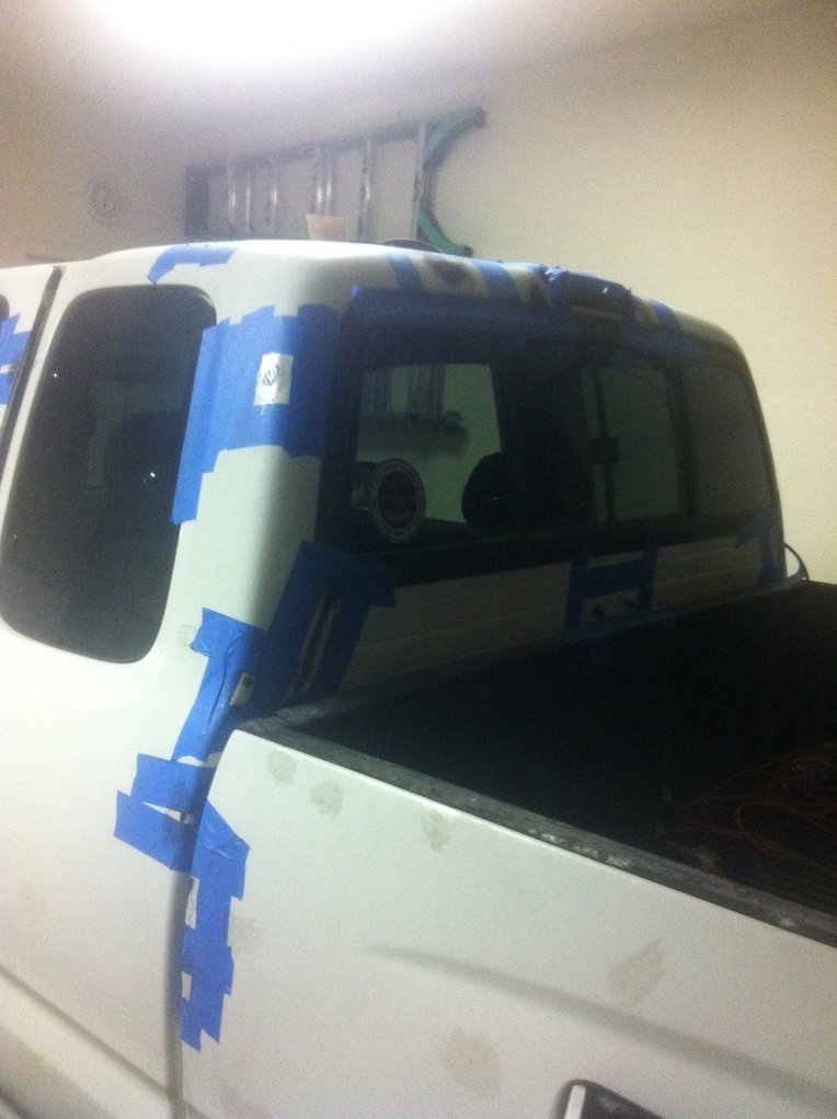

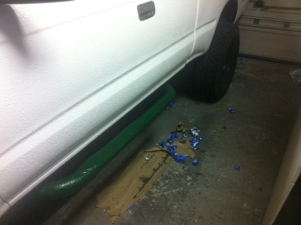

    And shes white again.
    IMG_4351_zpsisesomco_c455c917e7f12922251c2a98152afb7864a34f30.jpg IMG_4352_zpsxdbmmemj_3ee6d5ff631a97f69b8918d743738d630a4b067c.jpg IMG_4353_zpsydw9o5ky_e4e781aef1e5aeff2ba67a982c88b25495b3c878.jpg
    Also in the process got rid of the badges and the stupid fender flares. My over all goal is to get rid of ALL chrome on the truck.
