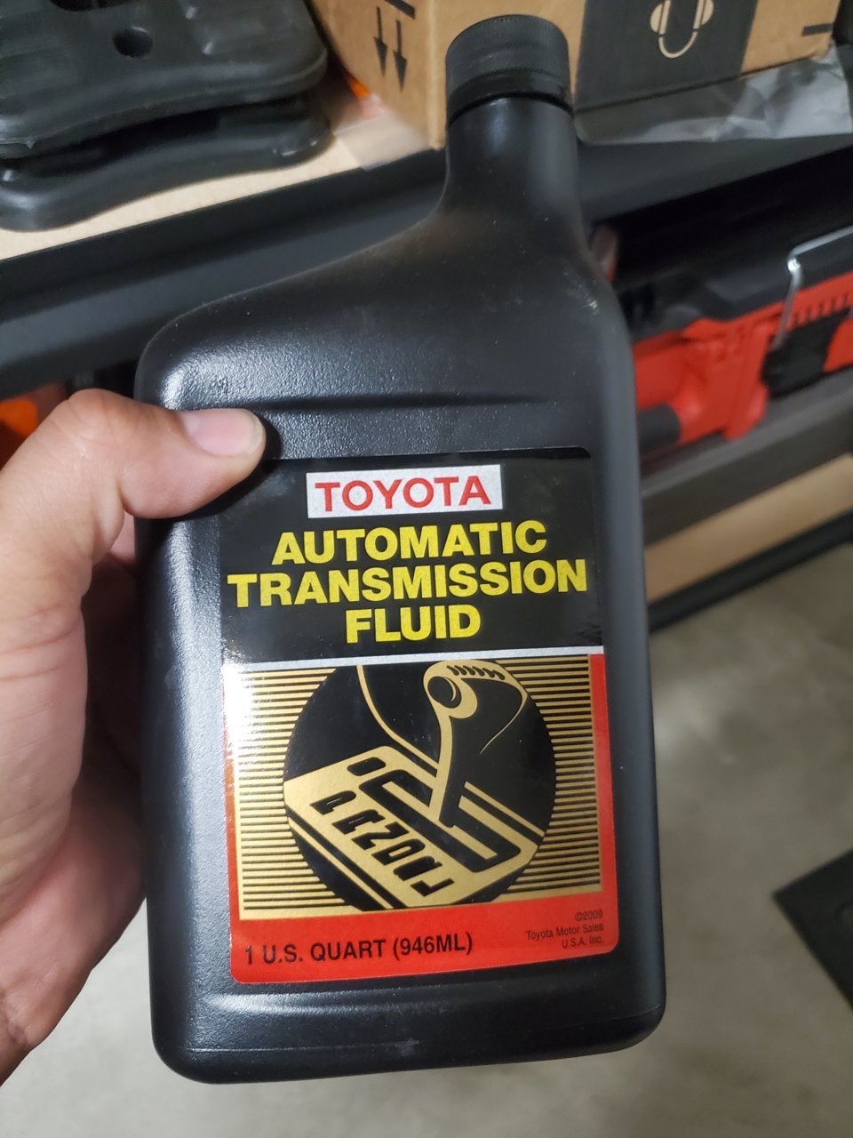

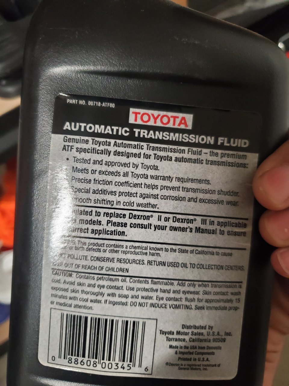

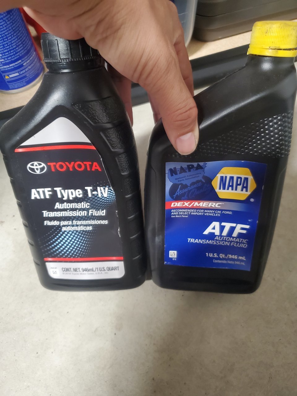

    4 run, 2 don't
    I still find it locally
    Interesting...I've got these in my shelf too
    But the first bottle is what I've used in my Tacoma and 4Runner
