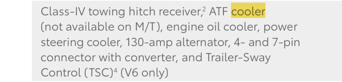

    So, I’ve heard and seen videos that say the ATF cooler on the third generation tacos had been removed at some point … yet on my 2022 sticker and brochure it states clearly that it has one. Anyone have any info on this?

    Are you referring to this?....

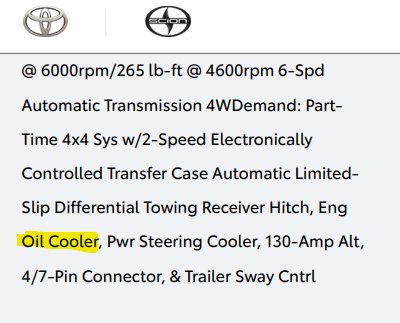

  8. Sep 18, 2022 at 5:20 AM
    chstaco
    chstaco Well-Known Member
    Jan 1, 2020
    #314837
    548
    SC
    2020 Tacoma

    All of the window stickers i've looked at all say transmission w/oil cooler. Just want to know or if anyone has added an external cooler just in case for towing. I guess extra doesn't hurt but just curious. Sorry to ask so early on Sunday. Enjoy the day.

    My confusion is more around whether the “ATF cooler” comment in the brochure (and my vehicle spec sheet) is accurate—whether it refers to the old external cooler (which was removed) or whether it refers to the radiator cooling.

    Yes, it is accurate; the fact is, regardless of whether the ATF cooling is done via a stand-alone mini-radiator, or a liquid to liquid heat exchanger inside of the engine radiator, you have an external ATF oil cooler in your Tacoma.
