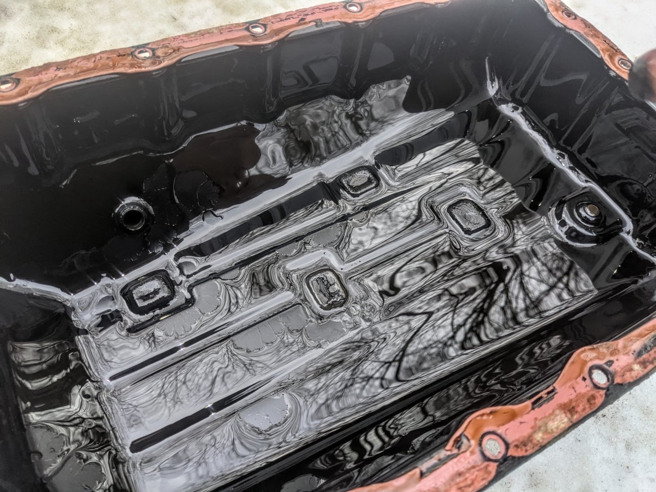

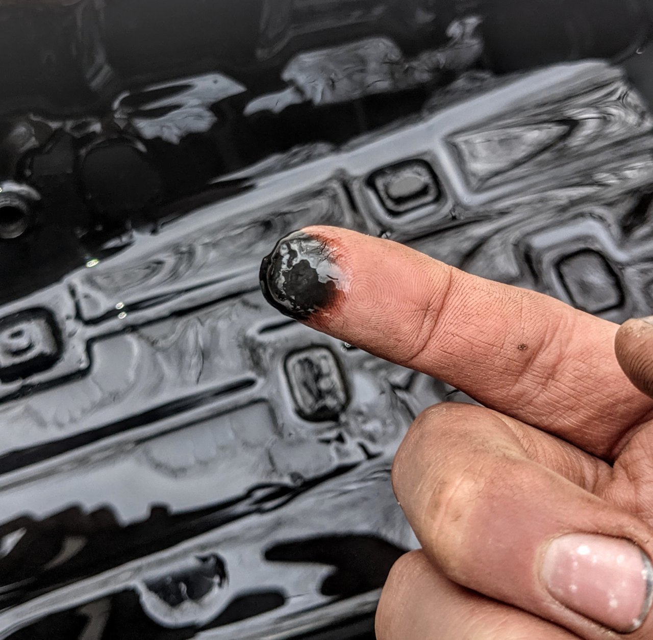

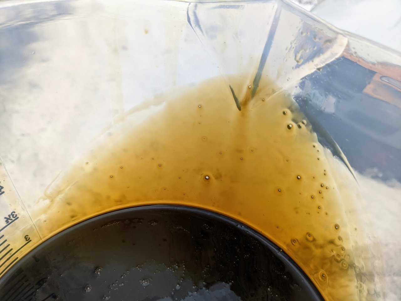

    Finally got around to dropping the pan...breaking that FIPG seal was a PITA without the special little tool but i finally got it.
    Drained almost exactly 5L of fluid from the pan and return line. Havent removed the filter yet (ran out of daylight).
    Overall, im pretty happy with what Im seeing.
    - No non-ferrous metal flakes of any kind in the fluid/pan.
    - Magnets have a sludge on em, which I was expecting.
    - Fluid is a brown with a slight reddish tint to it.
    Im leaning towards replacing the filter and refilling with new fluid, then driving it and see how things feel.
    If all is well, revisit the flush option this summer when I dont have to roll around on the ice/snow/dirt in 30* weather (id KILL for a garage right now...hell, id settle for pavement! ha).
    Here are some pics of the situation (@gearcruncher), thanks in advance for any comments/suggestions!

    Well thats great news . Thanks for posting pics . Surprisingly clean for unknown mileage :thumbsup:
    I think you will be fine cleaning up the filter and adding fresh fluid to the pan .
    I hate the formed in place gaskets . such a pain .
    This is why i go with the cheap cork gasket . Easier to clean the next time you have the pan off .
    I like your idea of flushing this summer .
