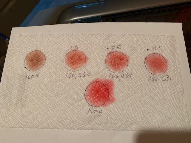

    I recently did the drop pan, replace strainer, clean magnets and been replacing 3 quarts ATF at a time. I was at 160K and tranny had never been touched. Magnets & pan had very little sludge. Here is a photo of the progression. Tranny shifting great with no issues. Reminds me I need to do 3 qts soon.

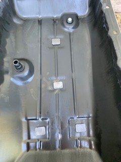

    Toyota puts 3 magnets in the bottom of the pan to catch fine steel particles. Same idea as magnetic oil plugs.

    Mine has 4 magnets!

    You're right, I just remember it being in a triangle pattern. Forgot about the center one.
