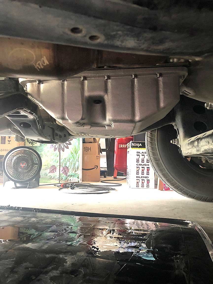

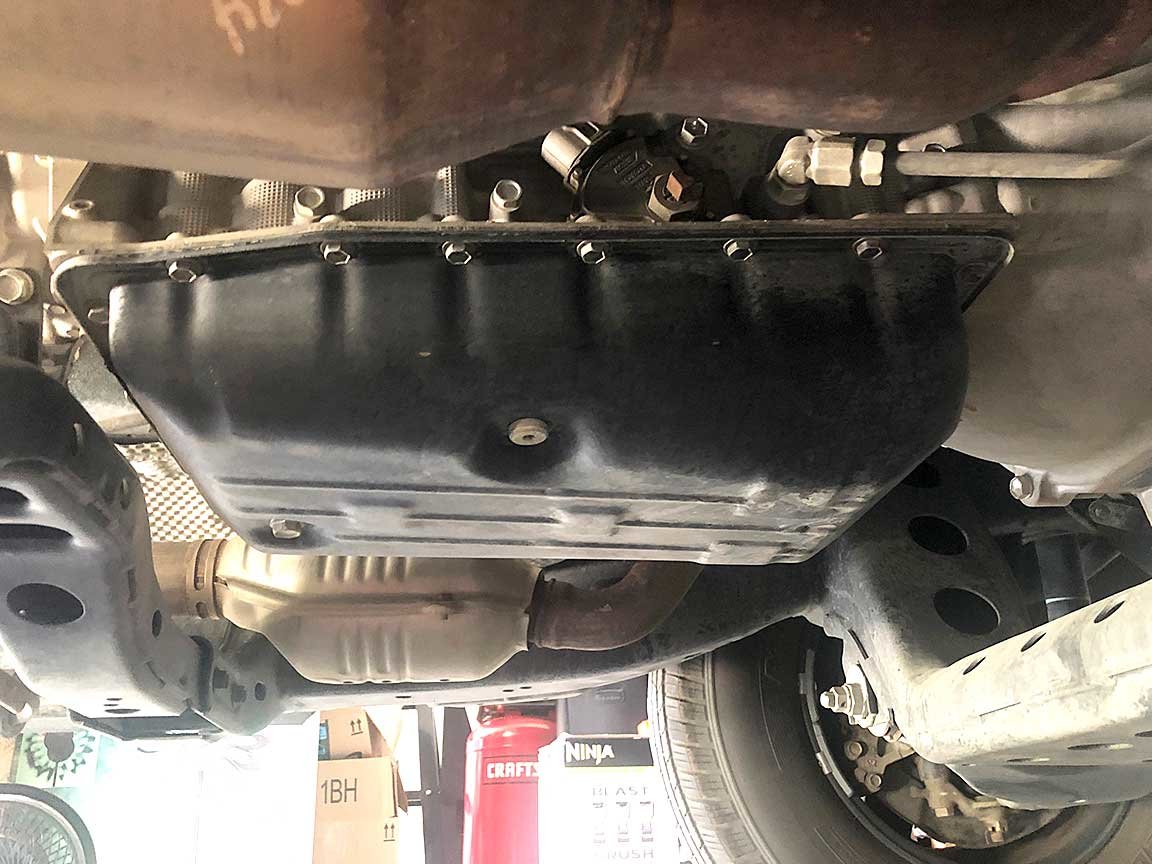

    8A9391D4-031A-488E-BA05-C6236BF55B86.jpg DA4155B8-B5F0-4EA0-B270-BCFD22BD1C2C.jpg I’m a bit anal. Bought my 15 with 30K. I did a full flush by removing the return hose back to the transmission. Used a gallon jug and measured 3.5 qrts. Filled it with 4 qrts. Used the pump from the transmission to get the fluid out. 12 qrts of Maxlife was used. Every 30K after that I drained what was in the pan. 80K I installed a deeper pan which gave me 3 qrts of extra fluid. Currently at 115K and won’t touch it till 150K.

    @ARB1977 Where did you get the deeper pan and about how much more ATF does that add? For your catch container, consider the graduated buckets, usually in the paint section. They have quart and liter marks and you can get three or five gallon buckets.
