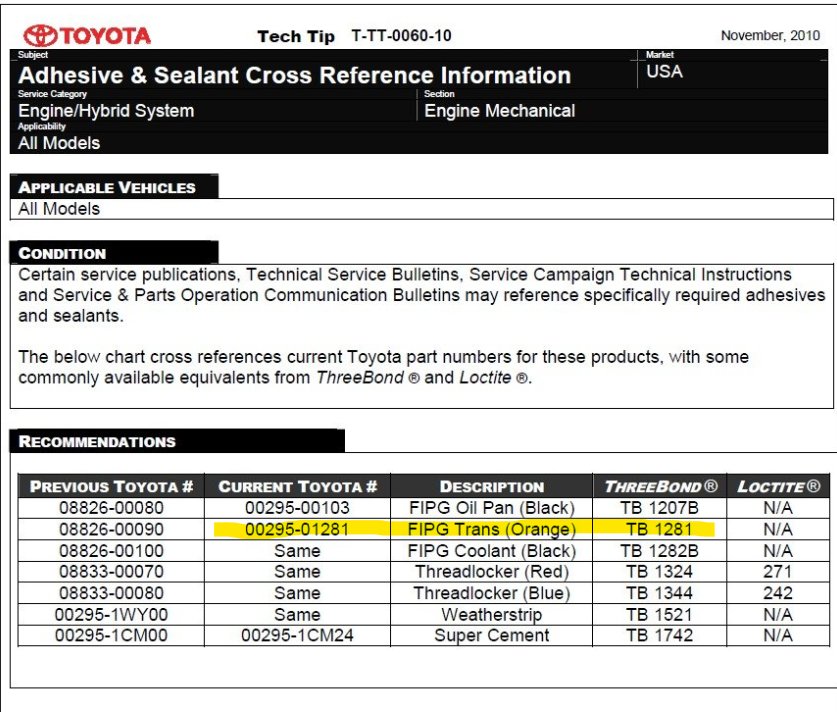

    A stiff putty knife works great as well. Wire wheels are great at getting the fipg off the lip of the pan where the scraper can't get.

    For the transmission, it's oranges. Merry Christmas.

    The easier it gets… :thumbsup:
