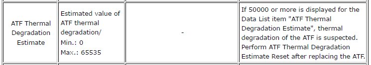

    Hello, I have been working with the Torque App developer team and we found that the 2gr-fks outputs an ATF Thermal Degradation Estimate. The range is 0 to 65535. Does anyone know what this means or what the output signifies?
    OBD2 Mode and PID: 22162B
    Long name: ATF Thermal Degradation Estimate
    Short name: ATF Degrad
    Min value: 0
    Max value: 65535
    Scale: x1
    Unit: –
    Equation: A*256+B
    OBD Header: 701
    Diag. Start Comm: 1001

    2016 Tacoma Service Manual lists this:
    tow-coma[OP] likes this.

    Service manual seems to indicate only 2TR-FE. I haven't tried looking for it yet (through torque app, or techstream).

    Tech Stream shows this as an output for the 2gr-fks
