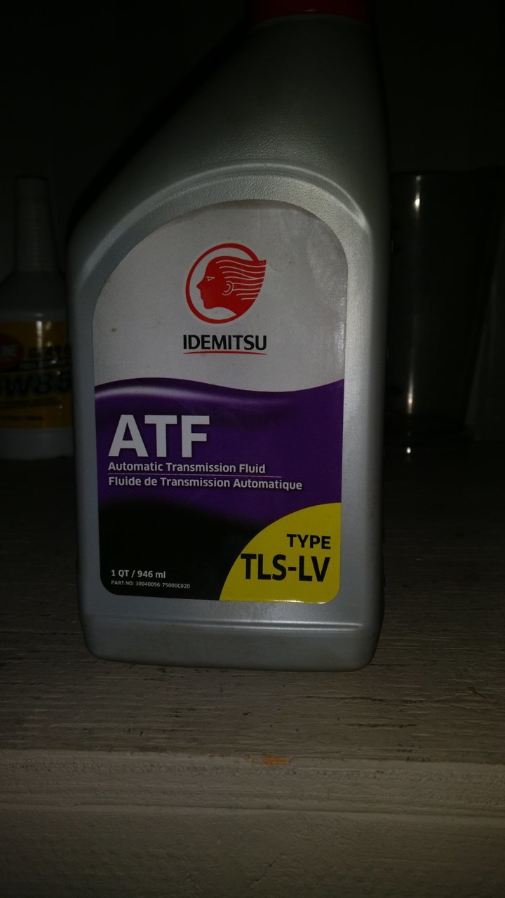

    Hi, I'm fairly new to the forms, been searching through and unfortunately still have not found the answer I was looking for. Recently did a transmission fluid change on my 2015 Toyota Tacoma TRD Sport V6 4.0L. Had a buddy help me at his shop and we used IDEMITSU TLS-LV fluid for the change. Since then I've been experiencing weird issues with my transmission and it's shifting. For the most part it's still relatively smooth, however it seems to downshift irregularly. If I am accelerating and revving between 2.5-3 Rpm it will not release even after letting off the gas. The other issue that has been occurring is that I will be heading down hill and while I'm braking it will shift from 1.5Rpm up to around 3 again. I'm wondering if this is due to the fluid we put in or possibly another issue. If anyone has experienced this before or possibly has an idea of what could be the cause please let me know.

    Hmm okay that's good to know I didn't get the wrong fluid in there. I didn't think I did but wanted to double check at least. As for the levels it should be accurate, we double-checked last night and it's just barely dripping out of the fill level plug.
    So at this point I don't think it's necessarily the fluids being wrong just really don't know why it all the sudden started acting the way it is
