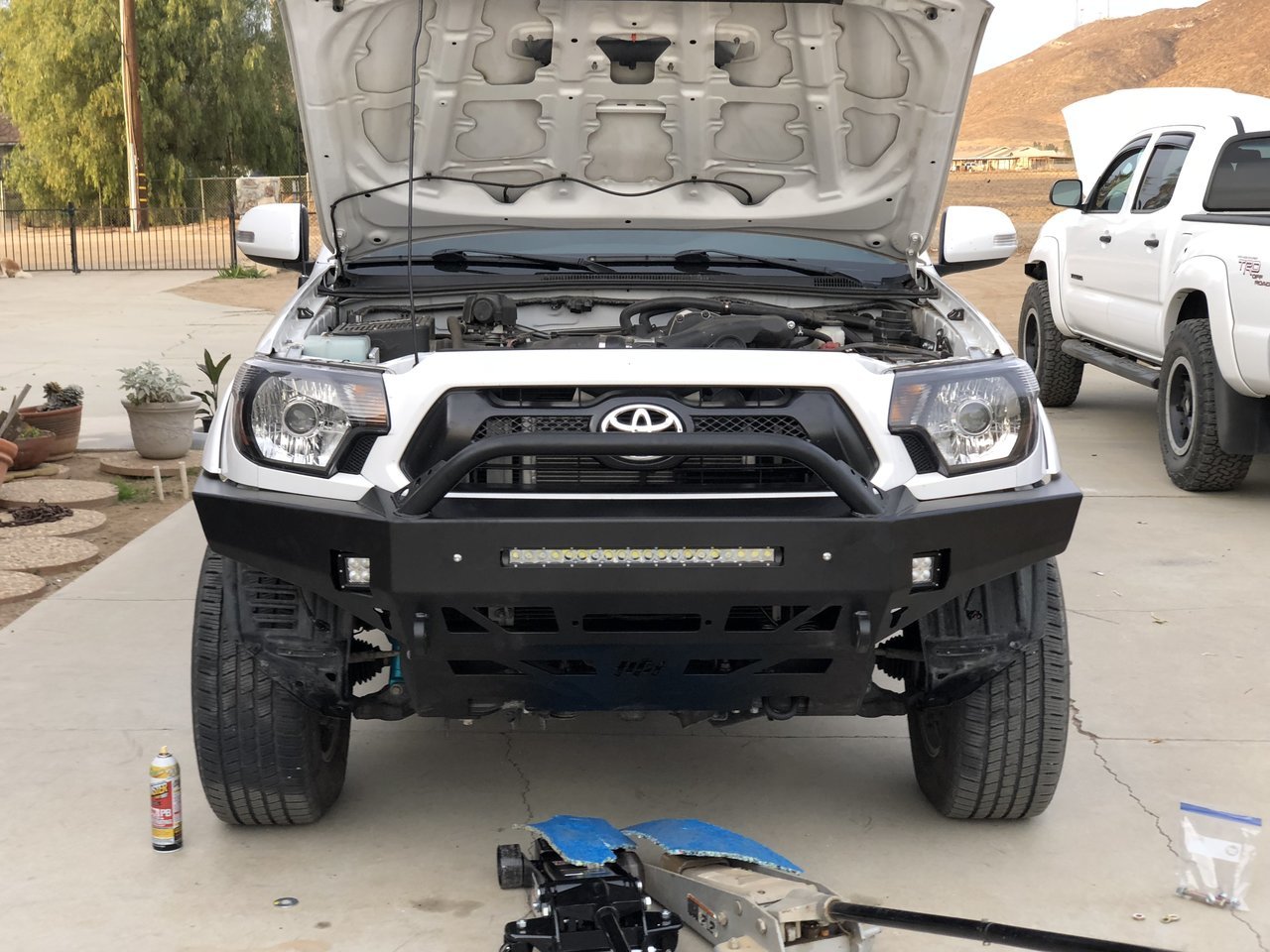

    @At The Helm @GDOLBOI Can you guys post any pics of how the hitch is integrated in the bumper? My bumper is going on this weekend if my cali raised lights show up or not :mad:

    There is pics of his on @GDOLBOI ’s truck on page 9 I think
    Edit right here

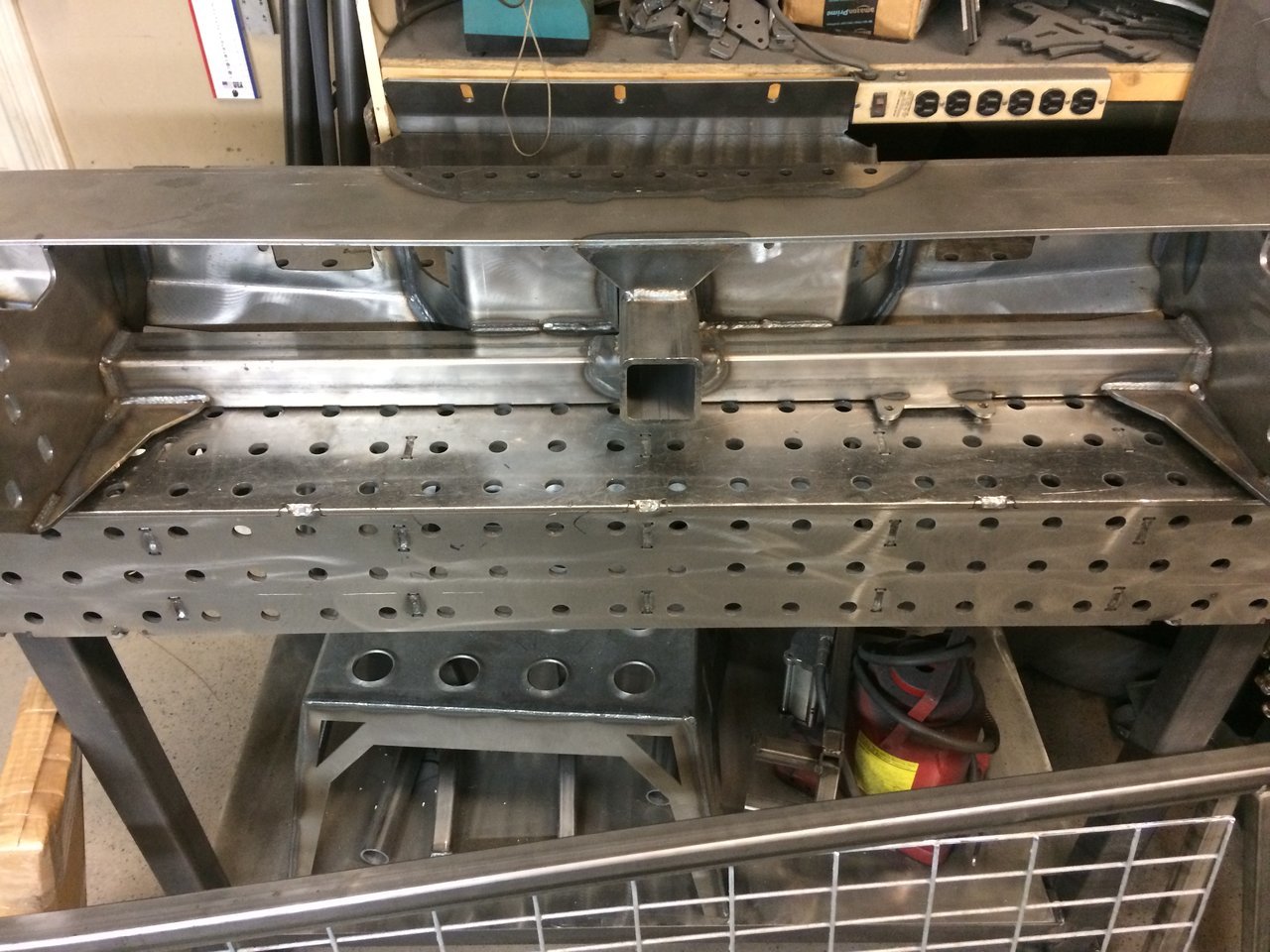

    It's tied into the 'shell' and reinforced with 2" square tube tied into the mounts and gusseted. Here's a shot of the hidden receiver.
    High clearance rear bumpers and swing outs are in the pipeline, but it'll be a while. (I do the fab work aside from a full time job)
    About 85lbs...I think they're lighter than the stock bumper with receiver somehow lol.

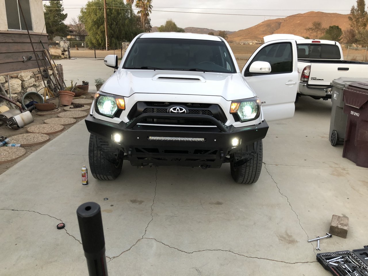

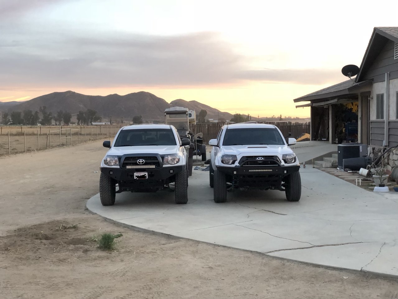

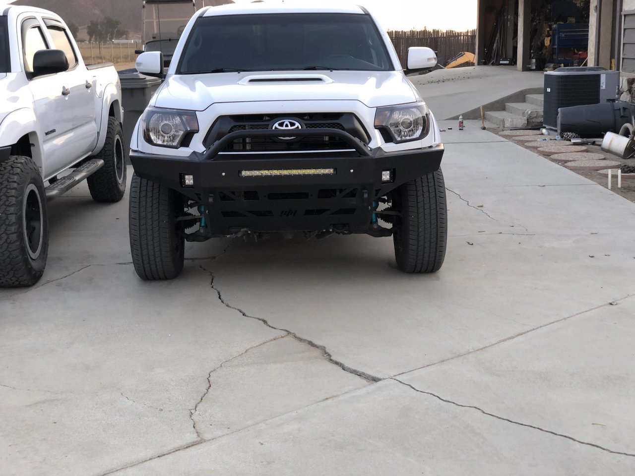

    0B385EBA-CE81-4D0B-8D58-5B7A806F6BD1.jpg C3EE5AA3-931E-4BD6-BFDA-FDDACD031B3B.jpg 8390B30C-B4B9-4525-8090-2C06273E71FD.jpg
    These tires look so goofy now haha, time to upgrade! Also need to get a real skid plate. I am debating on even putting the stocker back on.
    Edit: before anyone says it yes I know it’s not 100% level. It’s not easy to get it level haha and I am waiting to finalize it when I install the frame tie ins. Ran out of daylight and I need more black spraypaint to paint my resi mounts.
