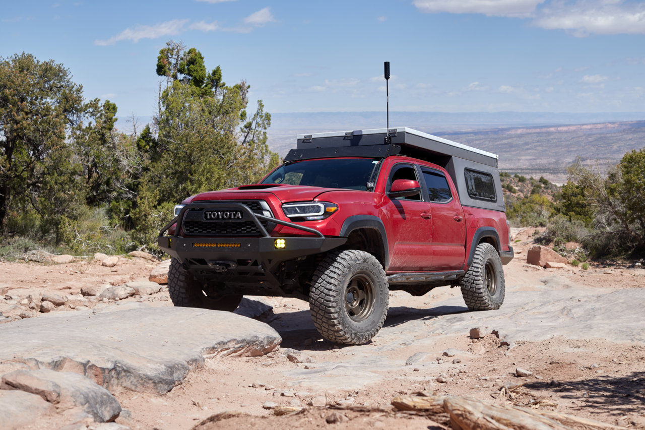

    Alright, giving some feedback here. I got to test this thing out in Moab and couldn't be happier with the results. Took some hard hits and was surprised by clearance and the points of contact on the trails we did. Cheers again to Morgan for such fine craftsmanship!
    P.S. the r4t bumper caps fit perfectly with the bumper if you're afraid of trimming anything up front. I wanted a cleaner line look and it came out perfect, I just had to to trim the fenders and we were good to go!

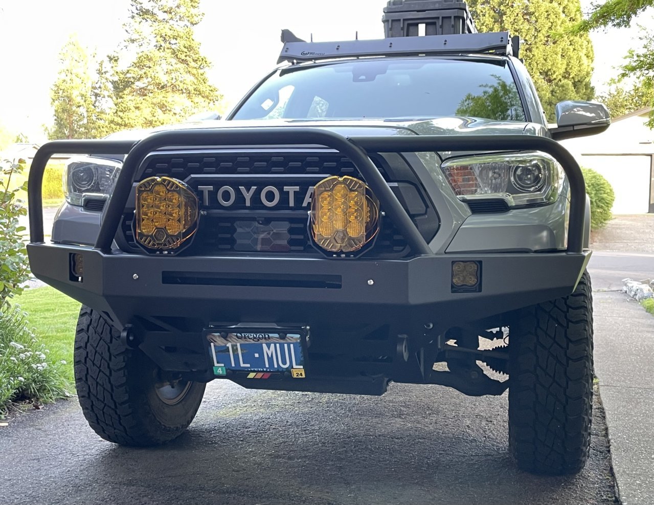

    A few weeks after placing my order, I finally got Baja Designs’ LP9s installed on the bumper. Bright AF.

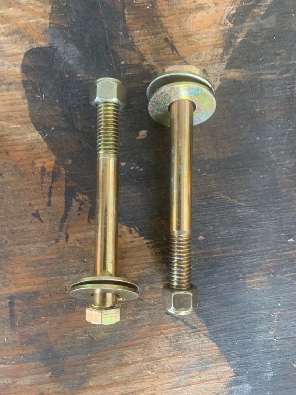

    Finally got my bumper on yesterday. Two remaining questions, I did email Morgan but wanted to check with others too.
    He gave me four of the 4" grade 8 bolts, but I can only find places for two. Only two get used, right?

    He sent me four of these. One goes on each side through the bracket he provided and through the frame. No mention of another pair in the instructions and no obvious other place for them.

    Where the other two bolt holes are in Morgan’s bracket you will have a plastic clip on the frame on either side. Just pop those plastic clips off in the bolt goes right through

    I did that. I’m saying he sent me four. Two like you said, the other two I think are extra im just trying to confirm I didn’t miss anything.

    Morgan set me straight. They weren’t extra, they go through the crossmember from front to rear. I read the directions 25 times and still missed it somehow

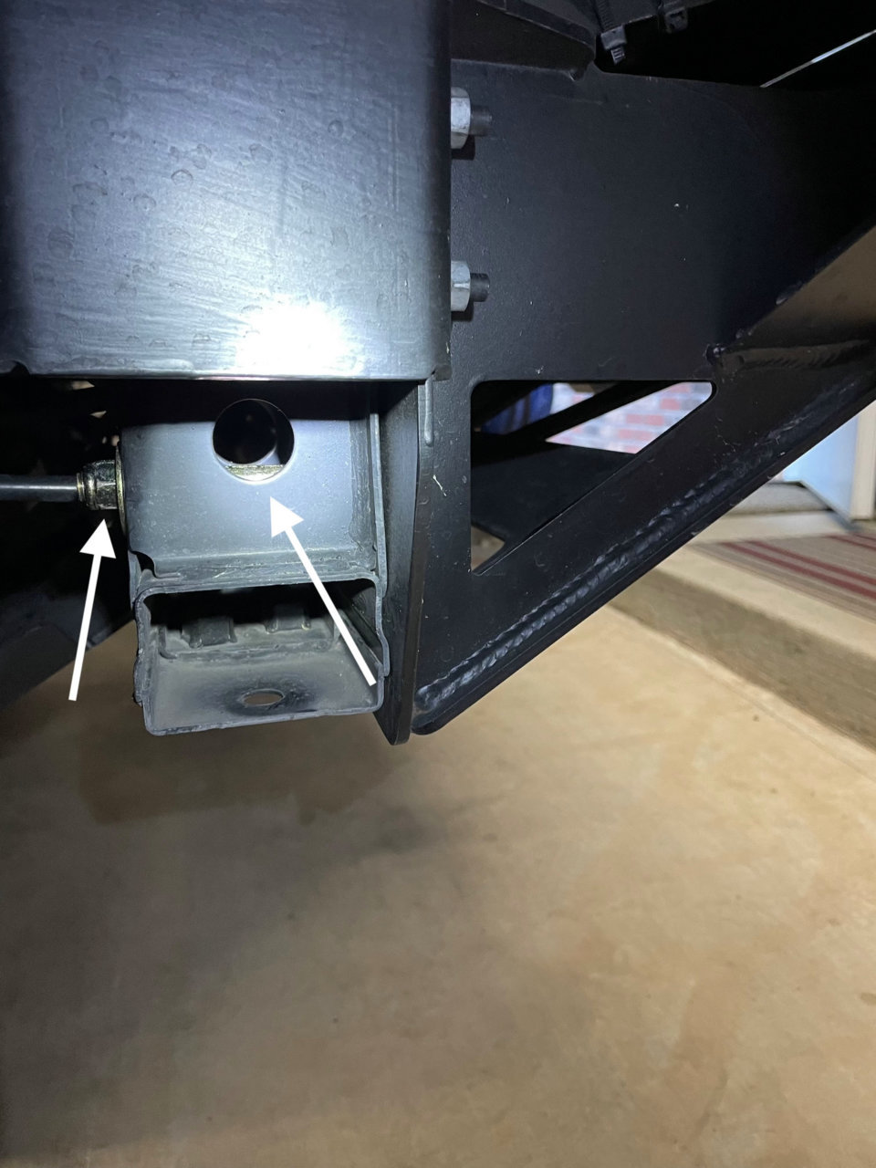

    Here are pics of where I put those two bolts. Morgan @At The Helm can correct me if I put them in the wrong spot, lol.
    From the front (right/passenger), looking through the lower opening in the bumper.
    From the side (right/passenger). You can see the bolt through the hole going through the cross member and the nut (arrows).

    You got it correct Bruce. Me and @littlefish got it sorted out too :thumbsup:

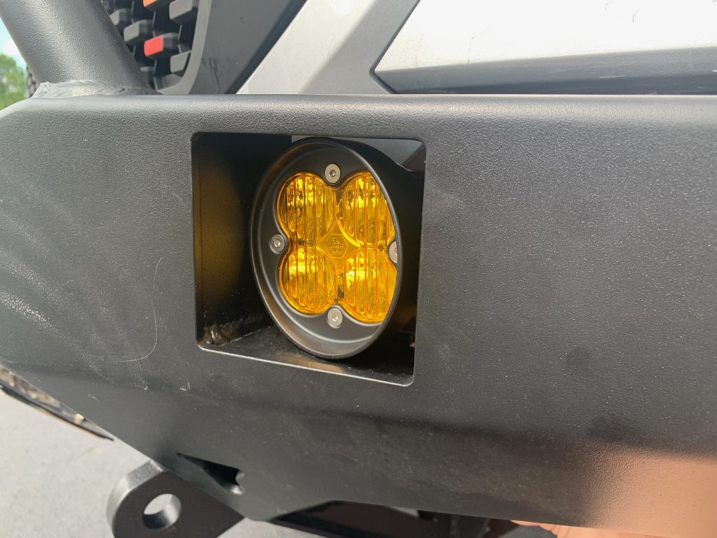

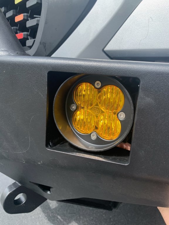

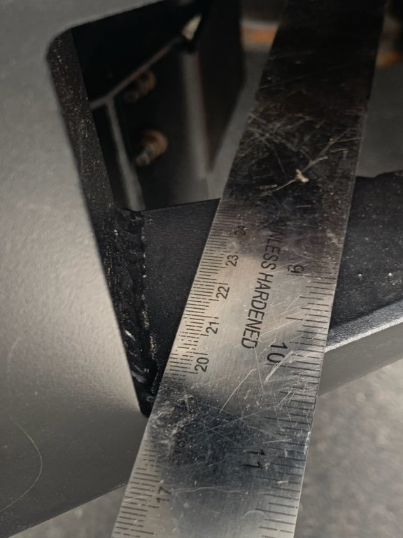

    Got my BD brackets today but I’m back with another fog light install question.
    The foglight cutouts are not parallel with the direction of the truck, rather they’re angled outboard. My BD squadrons came out of the stock bumper, so they have the angled bezel. Weather I put the bezel on the inboard or outboard side I can only have the lights angled outboard, not directly straight ahead.
    Is the bumper designed to angle the fogs outboard (totally fine if it is but want to make sure I know all options), or is my bezel at fault? I can try rotating the bezel to the top.

    Call BD. They’ll have the flat bezels to you in 3 days

    I have another pair of squadrons with those bezels so I just tested it out. Even with the flat bezels I can’t get the light to be directly in line with the direction of the truck. The light can’t be moved forward enough without creating a shadow / dead zone in the middle of the light pattern anyway so I don’t think the $33 bezels would be worth it.
