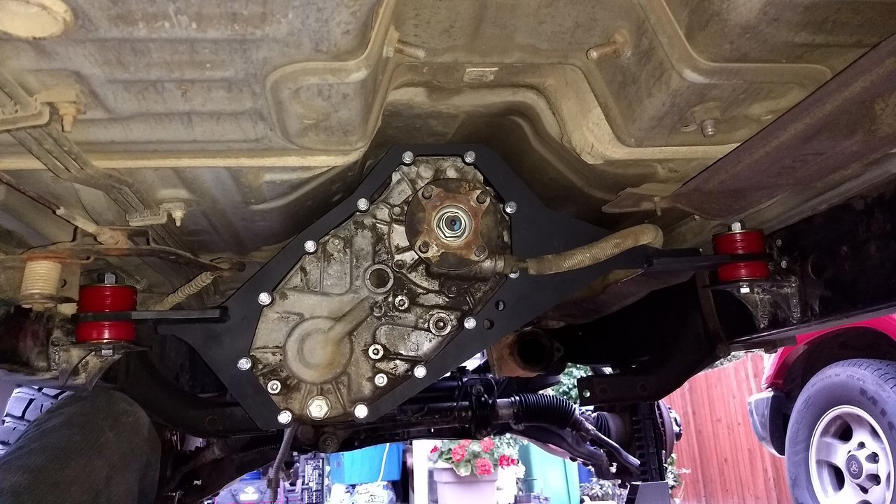

    Putting a divorced style transfer case in may be a bit tough, might have to use a 2WD tail housing for the trans to make it happen. My question is what is the end goal, ground clearance, FWD capability, extra crawl ratio? As it is your exhaust is one of the lowest hanging components, that and the trans crossmember. You can do like I did and get rid of your trans crossmember and push the t-case up higher. I have a flat belly now and it cost lots less than adapting an atlas. Pic to give an idea...

    They aren't Chryslers, I don't have that much confidence in the 3rd gen drivetrain but it isn't that low haha
