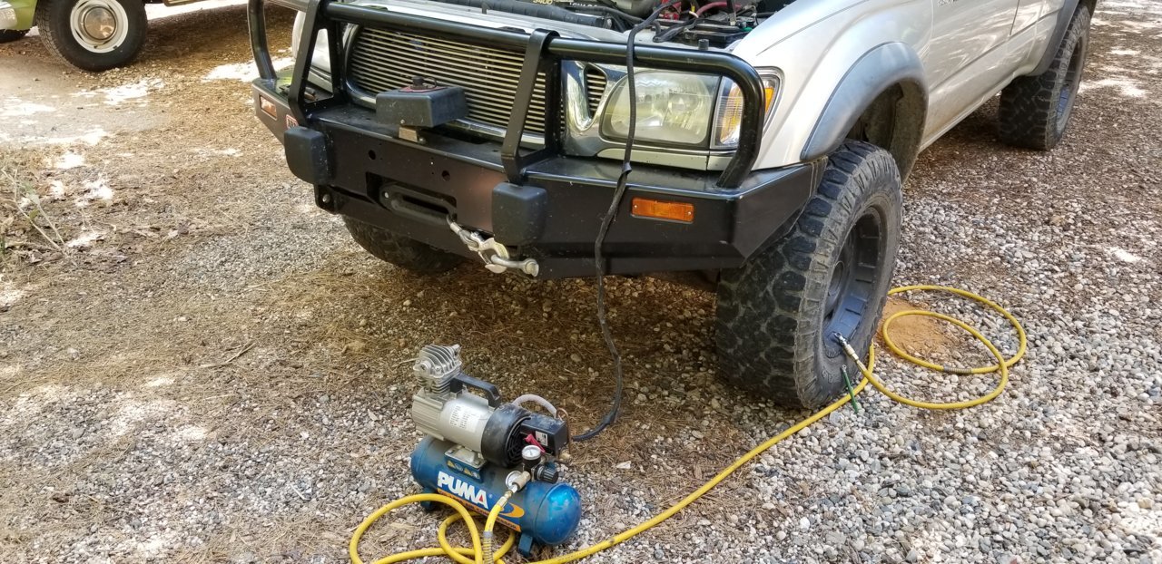

    This set up works ok for the time being. It would be nice to have a dedicated on board air system, but that will have to wait for a later date.

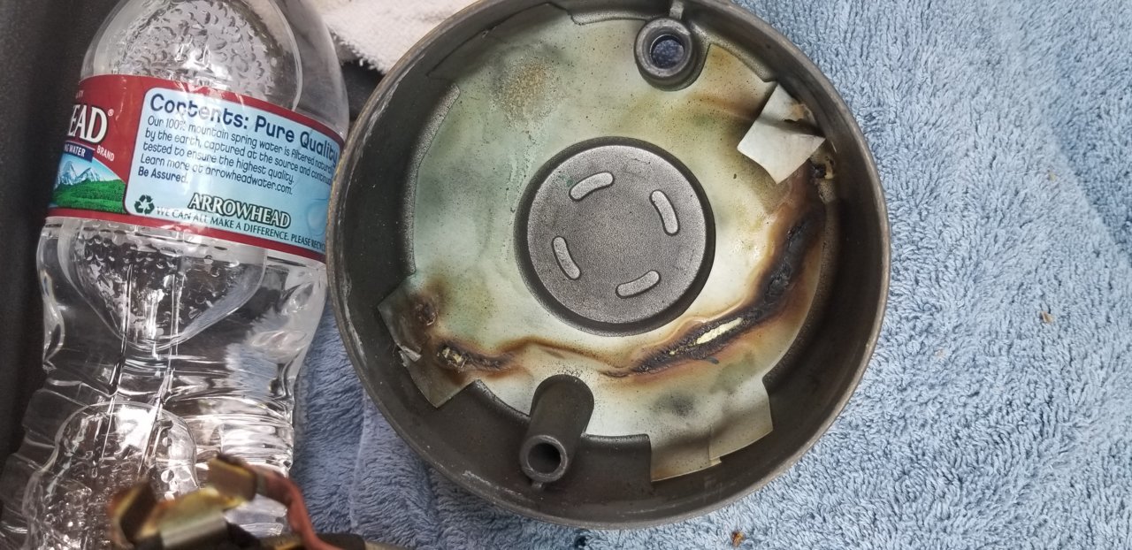

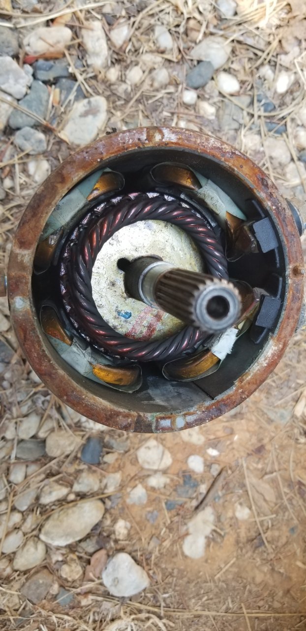

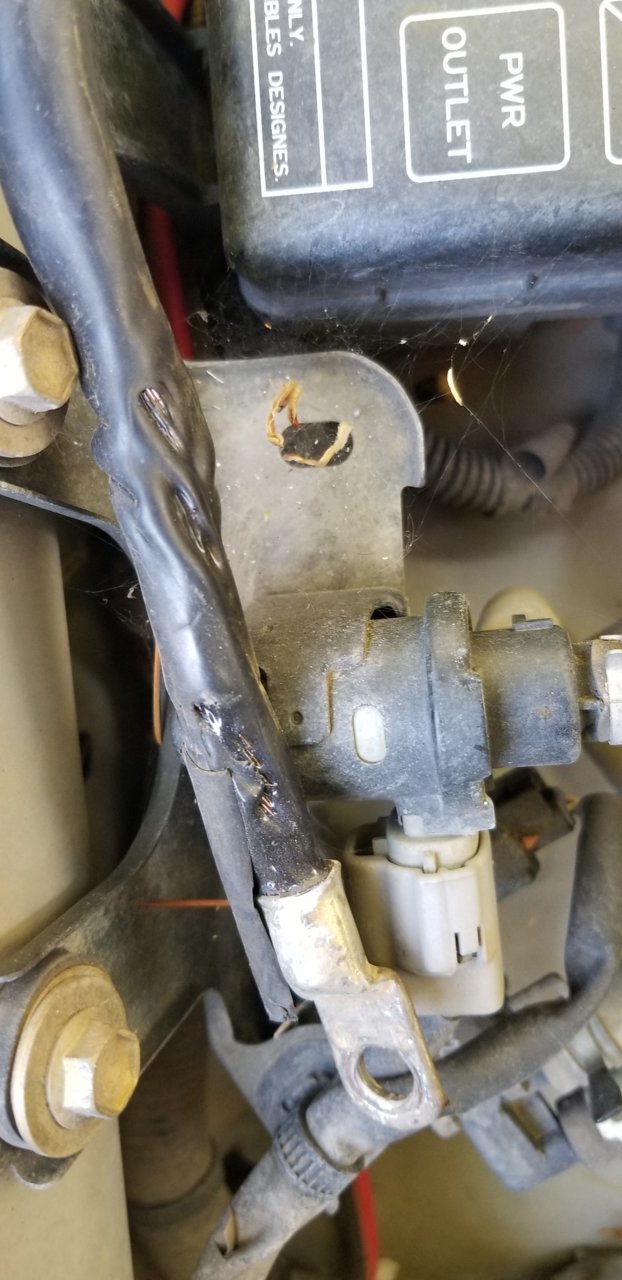

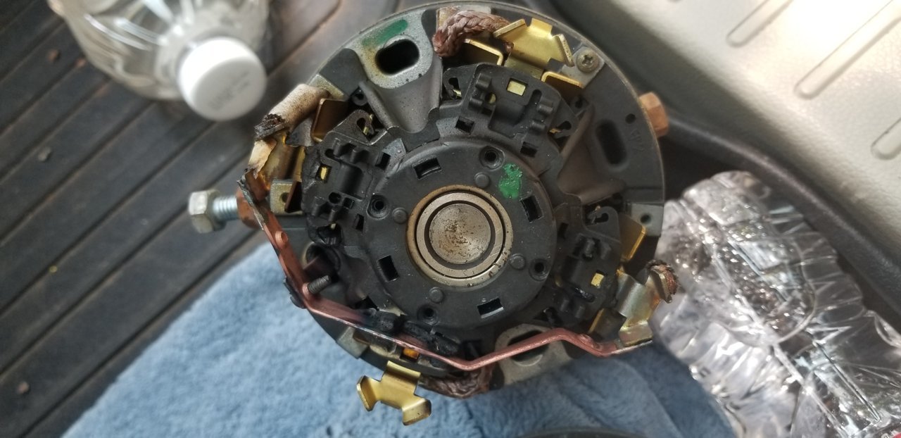

    I might have fried my winch yesterday. If anything I learned why fuses on both wires to the battery is a good idea. I was winching and the dash gauges went dead. I thought I might have been killing the battery so I stopped and ran the rpms up for a minute. The gauges started working again. I decide I had better open the hood, so as soon as I popped it up I noticed the wires were smoking.
    I'm going to pull the winch off today and see what's up. Has anyone had to rebuild the motor on a warn winch before? Is it worth it?

    What model winch? I use a local starter and alternator shop. Last one they removed the brushes and tested for 60 buck
  17. Aug 22, 2018 at 1:33 PM
    #37
    Atlastrekker
    Atlastrekker [OP] Well-Known Member
    Jan 19, 2018
    #241701
    139
    Clay
    Sierra Foothills
    04 taco
    I just called the local electric motor shop, they said they can fix it. The winch is a xd9000 that I've had for 15 years or so. I see that there are new motors on Ebay for $200, so as long as it's cheaper than that I guess I'm ok. The insides definitely stink like burning electrical.
