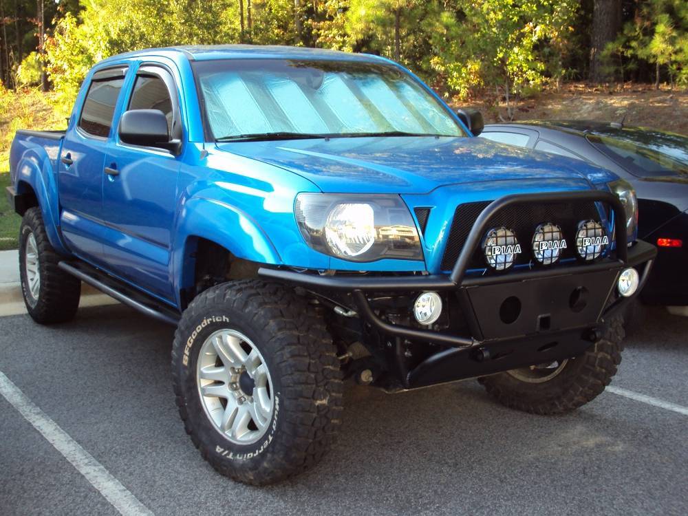

    3rd PIAA:

    i love and want this bumper

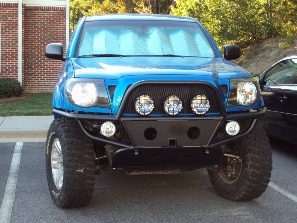

    Better head on view:

    Looks better with the 3rd piaa. Ever thought about plating where the fogs are?

    That was the original design. Ask me why it can't be done.

    I love that the hoop lines up with the grille surround

    That's actually misleading - it can be done, but it's super expensive. The "wing" tubing bends along a different plane from the crossbar that it connects to (the one running fender to fender). In order to plate that section, there are two options:
    1) Pick a thinnish metal, say 1/8th steel and have it shaped appropriately. Because this could not be done through normal cold-bending processes, be prepared to pay out the ass.
    How much exactly? Off the top of his head Kevin quoted me around 3 grand, although that number could give or take a little. It would look better, but it wouldn't look THAT much better.
    When I've been working with Kevin in the past, I've always been pretty flexible on price, because I want things done right. This time, I was flexible on my vanity.
    The small aesthetic change I chose instead was to run tubing down either side of the front plate. If you go back to the OP, you'll notice Dennis's bumper is just the plate. I like how the extra tube finishes off the fog light sections.
    2) Make the entire upper section of the bumper out of it's own enclosed section of tubing. This results in tube stacked on tube where the upper section meets the lower section (just above where the recovery points are) and looks like ass. It looks like your truck has Angelina Jolie's lips. Kevin actually called me when he was considering this option and was like "I need your input. I've been staring at these fucking tubes for like two hours."
    So there you are
    That ATO guy just has an eye for elegant but not over-the-top designs...s'why I keep goin' back to him :D

    Makes sense. Looks good as is!
