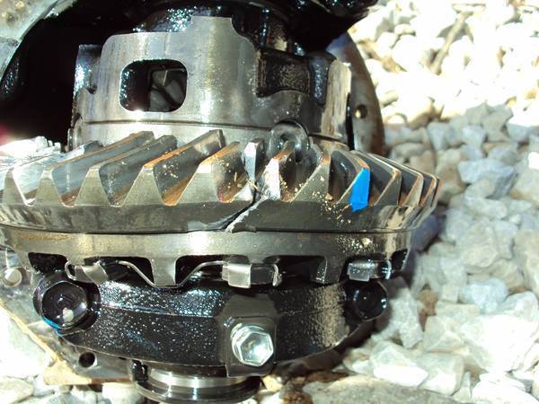

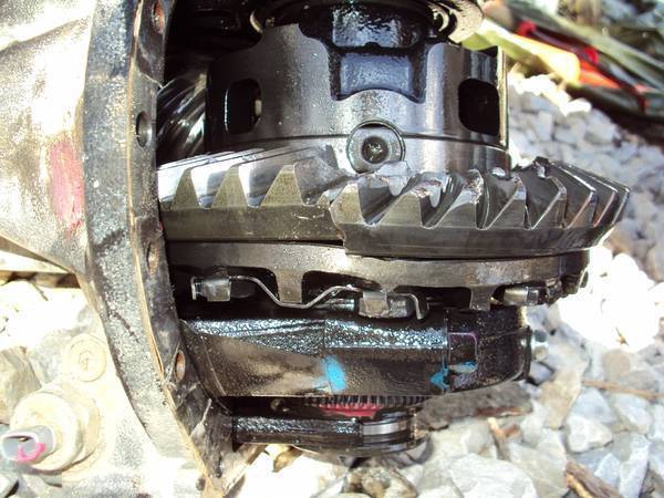

    This is correct.
    I *think* this is correct as well.
    When we recovered me in reverse, I was running 4Lo with A-TRAC. I gave the truck very light gas in reverse and let the strap do the rest. When it came off the log, one rear tire came down on another smaller log while the other hit dirt.
    I think the difference in traction with the wheelspin just goosed the ring gear the wrong way at the wrong time. That's when everyone who was outside the truck said they heard the first noise.
    Then it drove fine downhill for a hundred yards, and started acting up severely on the uphill...Im guessing since I was mostly on the brakes downhill, the driveline load was less.
    I already have two e-locker 3rd members. I can have them built for less than the cost of purchasing a used 8.4 3rd and ARB setup, meaning for the same money I can have a very strong rear end plus a spare. Plus, the trouble of running the electrical and air wiring for the ARB is eliminated.
    Going to 4.56 does a few things:
    - First and most importantly you can SWITCH GEAR MANUFACTURERS. This problem is with the Toyota gear manufacturing process, not the design of the gear. A same sized ring gear could be made much stronger by use of a gear made from a stronger alloy.
    - Cryo treating helps eliminate weak spots.
    - 4.56 ratio means the truck is less sensitive to skinny pedal...more engine revs required to turn the wheels once, so you have an extra "margin of error" if you tap the gas at the wrong time...the wheels will be spinning less, which means less force to shockload the drivetrain if one of them grabs.

    The issue is the Toyota gears, not the size. I've been talking a lot over the past couple days with the guys at ECGS. They've seen a LOT of blown stock Taco rear-ends, have replaced them with Nitro gears in a number of ratios, and have seen almost no failures with the aftermarket gears.
    The problem is not in the gear size - it's that Toyota's supplier is building shitty gears for the 8 inch third.
