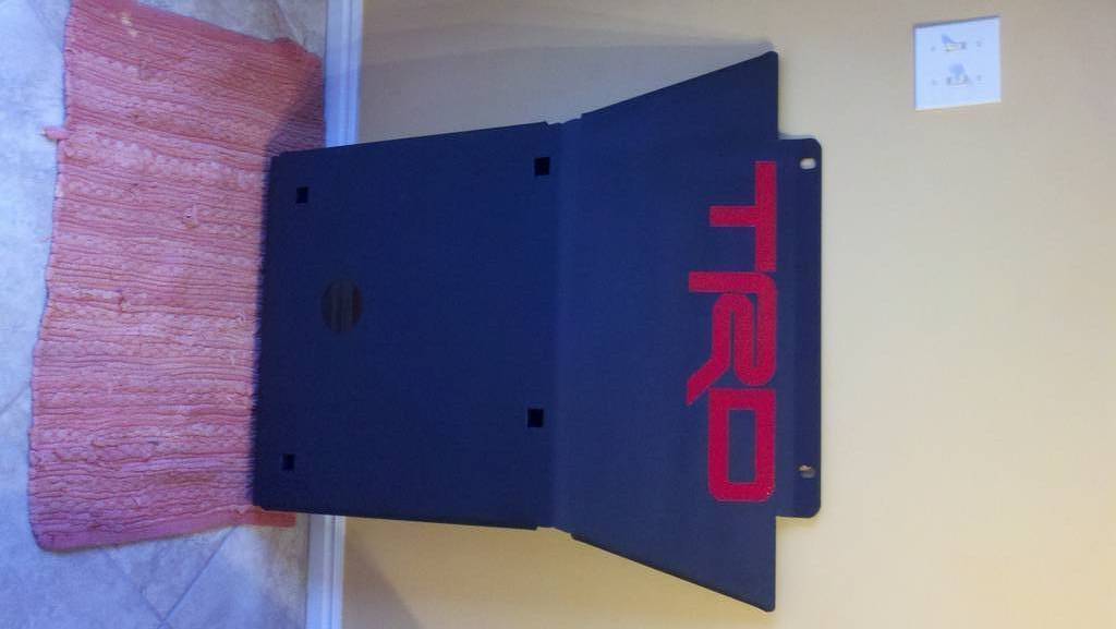

    I’m still prepping the skids for the install but here is a sneak peak.

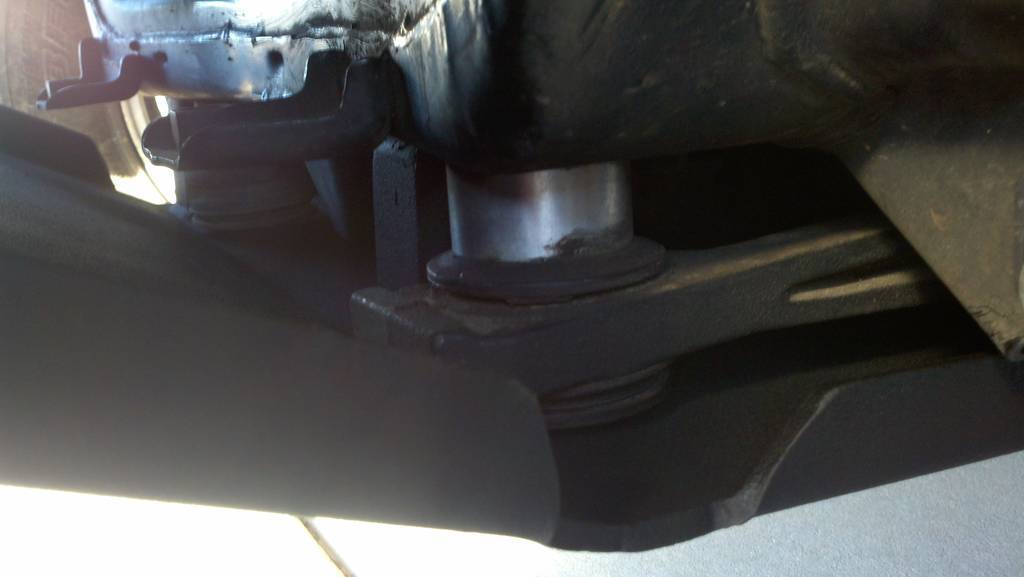

    I got the front skid on today. I was thrilled at well the skid fit with the diff drop installed. I know there a lot of diff drop haters out there but it’s giving me good CV angles and with the skid I have not lost and clearance.

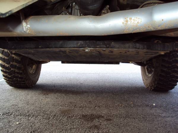

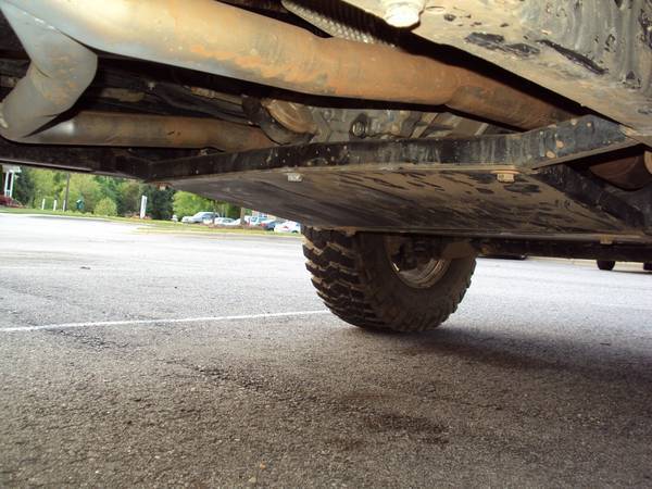

    That was from some trip this past year, I forget which except that it was in Uwharrie NF in NC. I don't know when it happened...found it when I was doing a post-trip inspection.
    That's the trans skid, so it's 3/16, not 1/4 like the IFS skid...but anything'll bend if you punch it hard enough.
    MJP2 wrecked the shit out of his whole front end because of having a diff drop installed and (poorly) modified budbuilt skids trying to protect it...but then, he also tagged the rock at 30mph.
    I also set the whole truck on the transfer case skid once with 3 wheels off the ground. It bent the add-in crossmember, and I had to pull it out and beat it back in shape with a sledgehammer:
    You can see it's clearly bent upwards around the middle bolt. And no, it's not camera lense effect...look the the bottom of the front skid hanging just below it and how it's perfectly straight and parallel with the ground.
    This stuff is why I tell people to buy ATO skids. I did my research and didn't bother shopping anywhere else, because no one else's products would've held up to my bullshit...heh.
