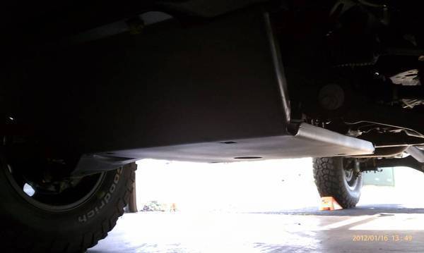

    Just put mine on yesterday. That thing is thick and heavy (and yes, that is what she said). I used my floorjack to lift it up then got all the bolts lined up. I left my diff drop on :anonymous::crapstorm: but my ass was freezing to the garage floor so I wanted to get done as soon as possible. It went on well and cleared the diff drop by maybe an eighth of an inch. I'll be taking the diff drop out when I do my 30k maintenance which will be in spring probably. Thanks again Kevin! I look forward to saving up for the rest of the skids in the future but this was a good start :)

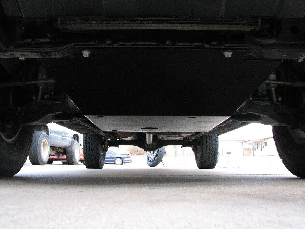

    TRD skid painted black,
    Agreed, I ended up using 4 couplings to extend the studs and left the plastic stocker on. Then used some bolts to add the plate.
    Had to use a spacer in front to attach the two large bolts.
    It is on and will do it's job as intended.

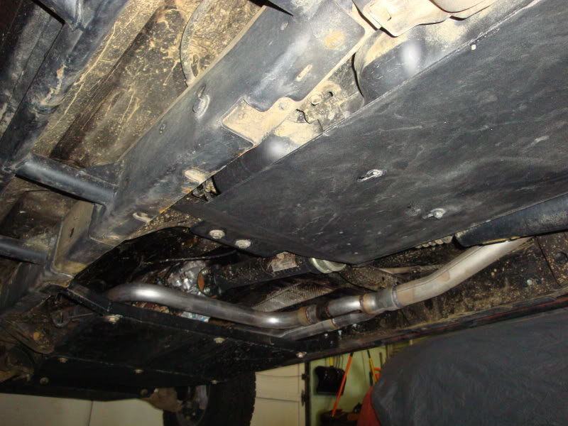

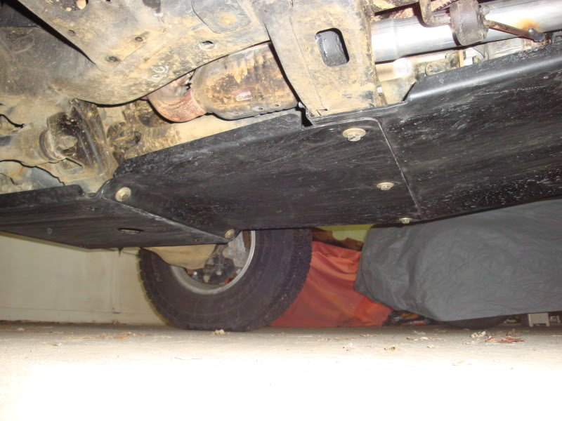

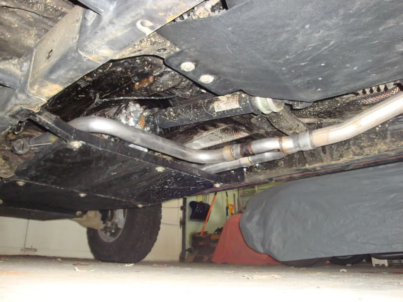

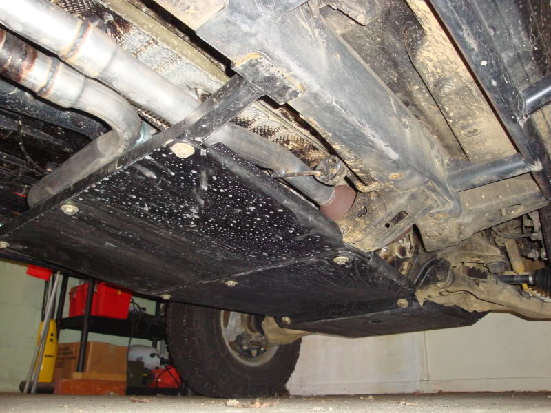

    Got mine installed finally. Had to get the exhaust re-routed but that was not to bad.
    They look like they could hit just about anything and survive!
