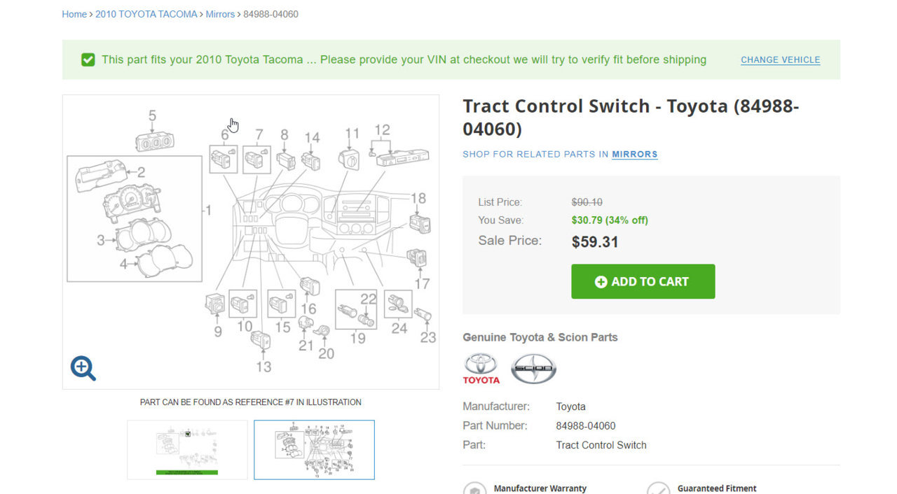

    Awesome thank you so much! Just to confirm on your '11 the ATRAC switch is under the HVAC controls right?
    That's the PN I came up with earlier but the diagrams confused me (part #7) because it looks like it's to the left of the steering wheel but I trust you alot more than the diagram.

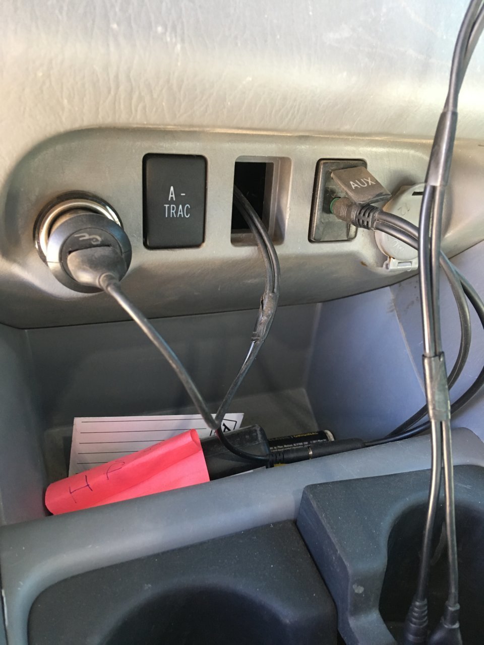

    snowsk8air2
    snowsk8air2 how hard can it be?
    Sep 16, 2011
    #63607
    10,542
    Flagstaff, AZ
    Supercharged TX Pro
    2011 S/C and basic mods
    Yes mine is under the controls on the center console and looks like this 8B6BBEFD-A8F3-4EB9-934F-5E62F55876D8.jpg
  4. May 5, 2020 at 10:24 AM
    #24
    plurpimpin
    plurpimpin [OP] Well-Known Member
    Jul 31, 2011
    #60895
    2,971
    PDX
    2010 TRD Off Road 4x4
    PERFECT THANKS! I really appreciate all the help! This is a weird one and I definitely would've been checking transfer case switches before the dash one if you hadn't chimed in.
    There's a PCB in the OEM switch so I think there's alittle more to it than just a simple switch.
