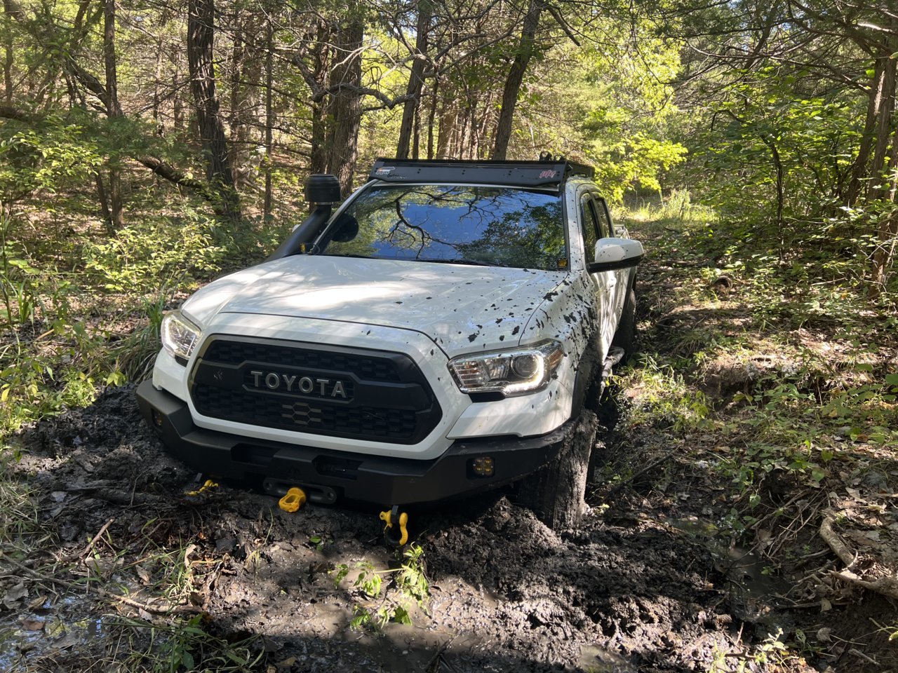

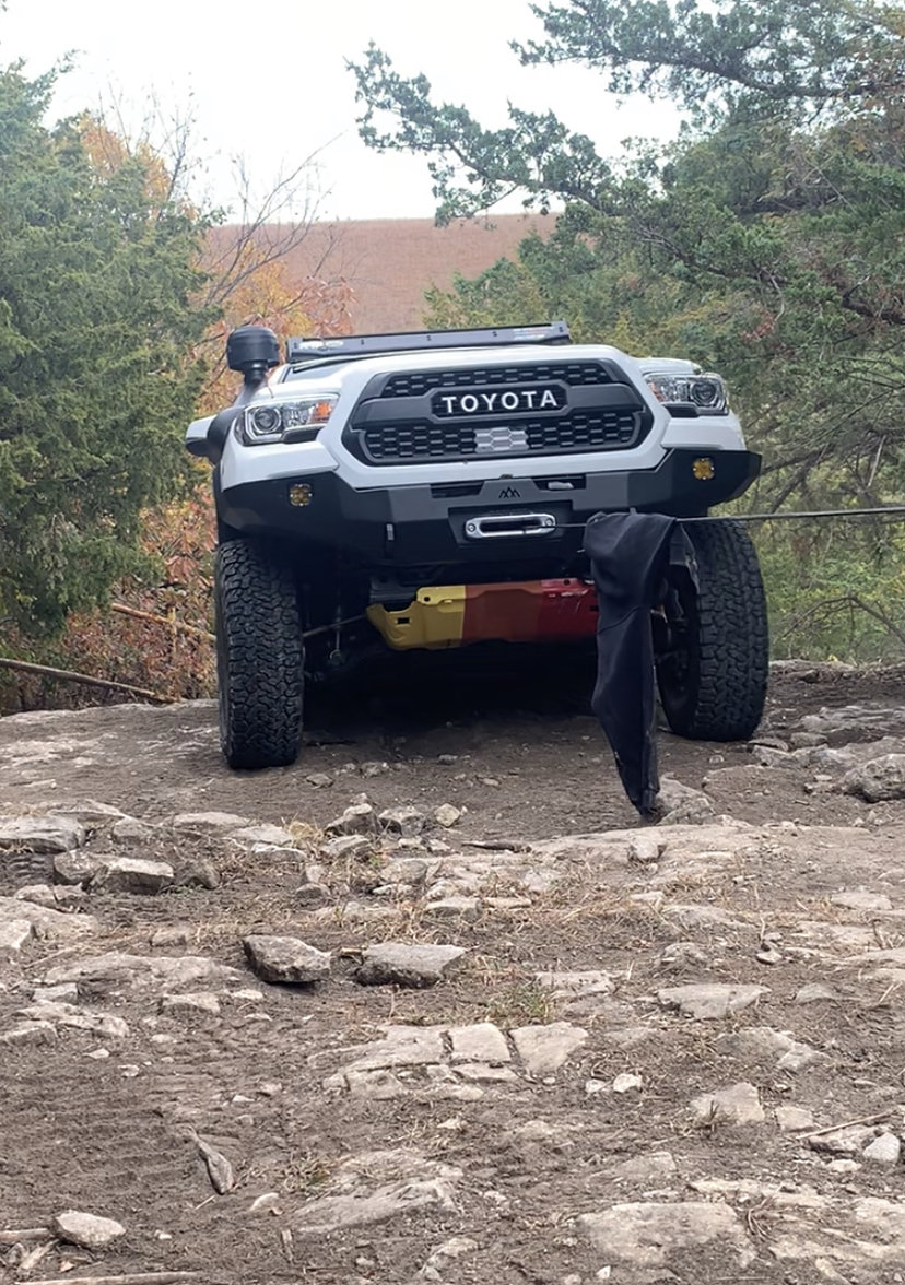

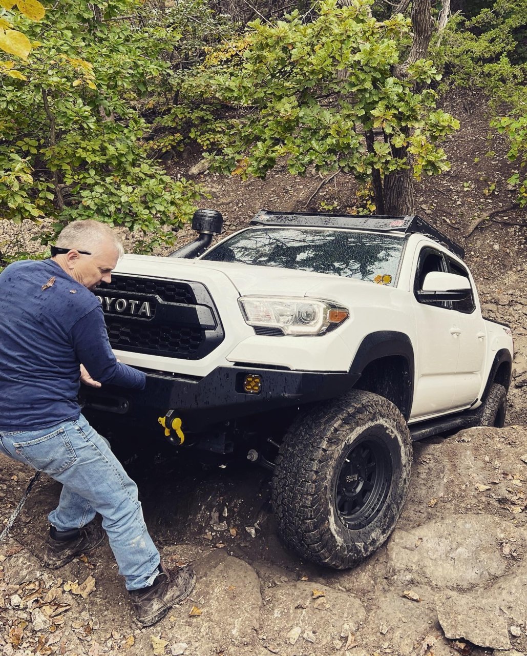

    It’s all from wheeling pretty hard. Getting turtled on obstacles, 33s not big enough to climb ledges but can’t backdown, longer wheel base on short obstacles, unexpecting depth of mud.
    Framed out in mud. It had grass on the top and I just sunk as soon as I hit it. KO2 aren’t great in the mud either.
    I was resting on my sliders. Front tires weren’t biting. Since I don’t have a high clearance rear bumper my bumper was resting on the ground not allowing me to backup without destroying it and it was taking a lot of weight off my rear axle.
    This one was two three ft ledges and about a 3 1/2 ft ledge that’s pretty straight up. It had rocks stacked but I kicked them out and ended up on my front bumper. It wouldnt climb and back tires were over the second ledge. I got the truck backup enough to re stack rocks high enough to be able to winch to start the climb on the front end. (Stock skid is destroyed and long gone)
