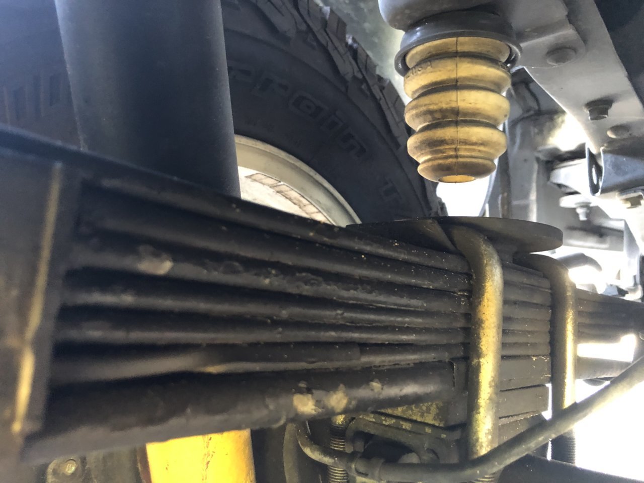

    I have a 2015 DCSB O/R 4.0 Auto. It has the original 3/1 leaf springs with a 3 Leaf AAL, a 1/2" Toytec spacer, OME Nitro shocks & Chevy Silverado bump stops. The ride with this set-up is fairly harsh & seems to be getting worse over time & are squeaking more over time as well.
    Basically my truck bed is almost always empty. When it is loaded it's about 1000 lbs and it's twice a year. The off-roading I do is trails, light mud, light rock crawling. I plan to replace my current bump stops with Timbrens for any heavy loads.
    I've read that OME & Dobinsons ride pretty stiff when the bed is empty & it's hard to find an OME review where someone does NOT complain of the leaves squeaking. I've seen mostly positive reviews on the ATS leaf springs but those reviews are a few years old. I also read that they can add more arch to the drivers side leaf springs to compensate for taco lean.
    For those that have ATS leaf springs how do you like them compared to OEM, OME, AAL's or any other brand you had before?

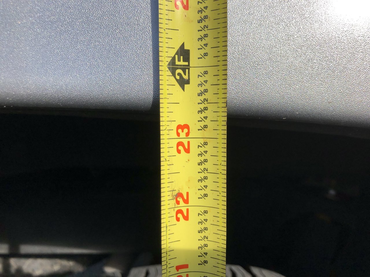

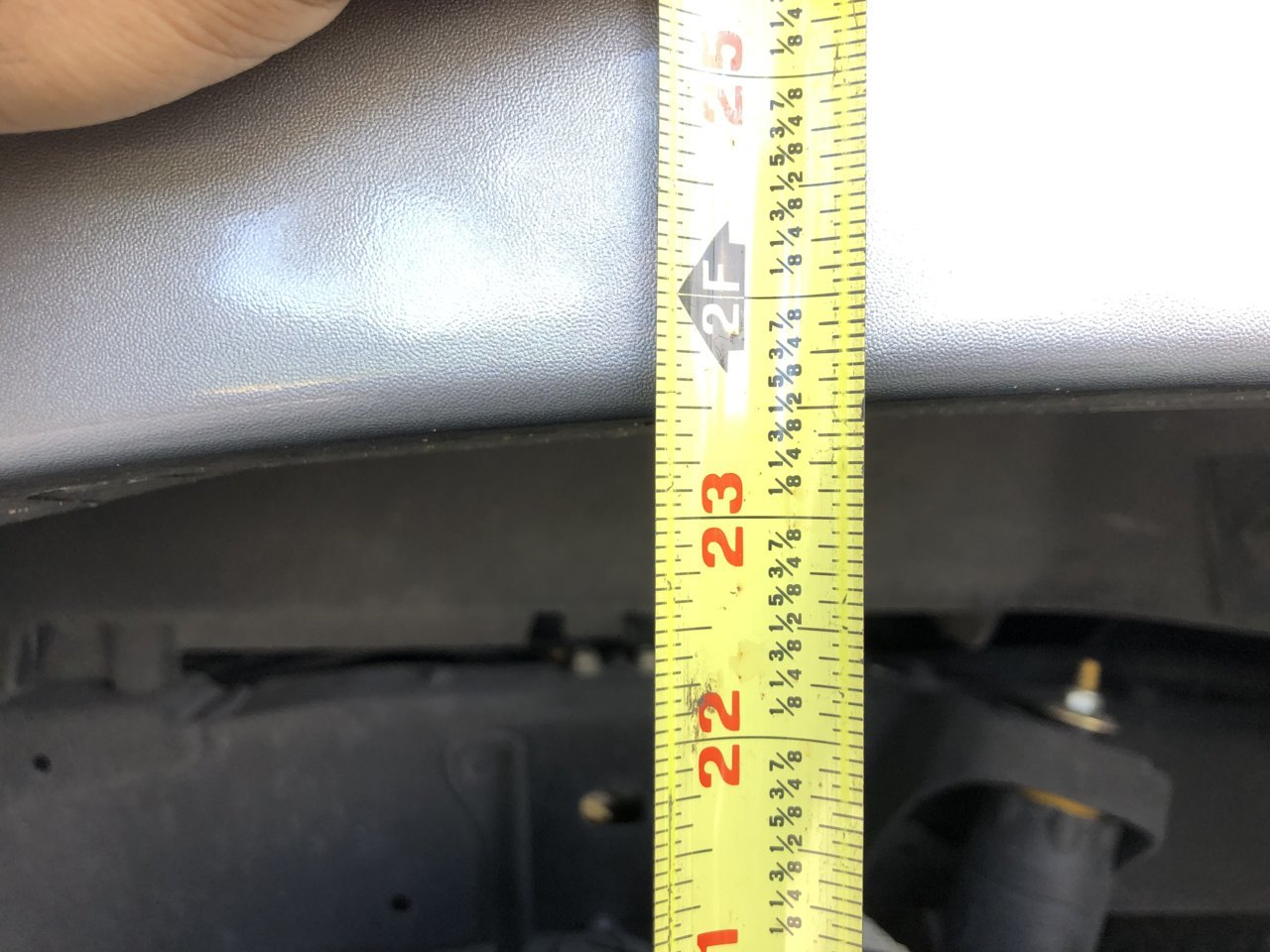

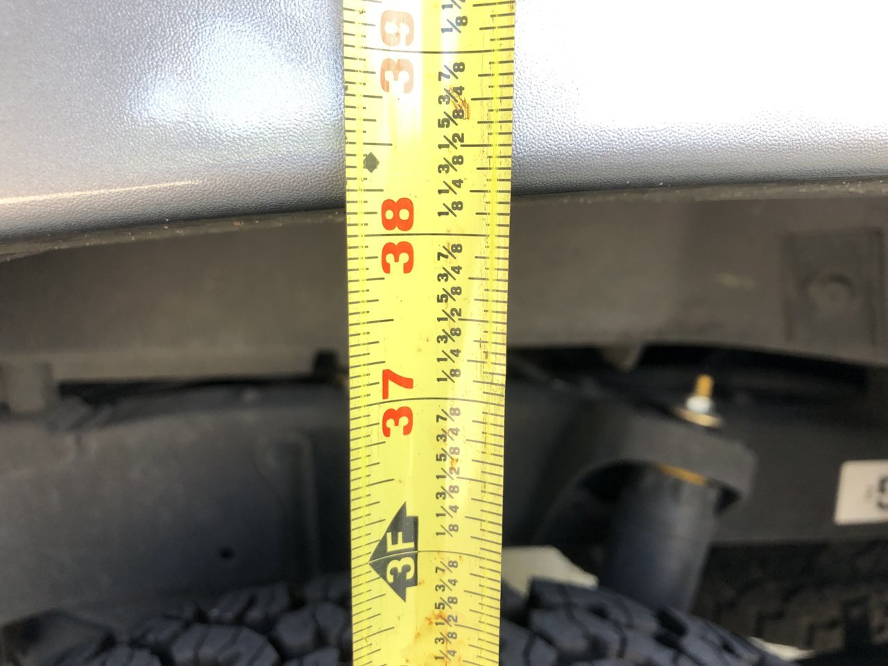

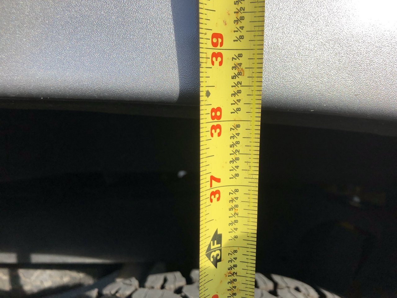

    Pics of my suspension & truck.
    left rear:
    right rear:

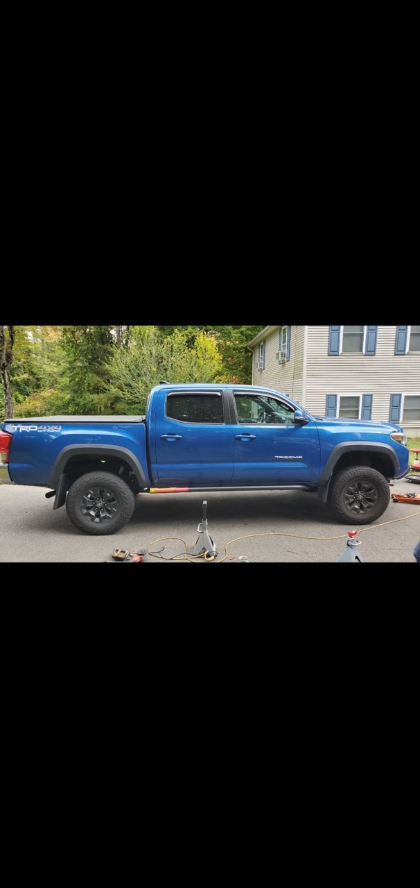

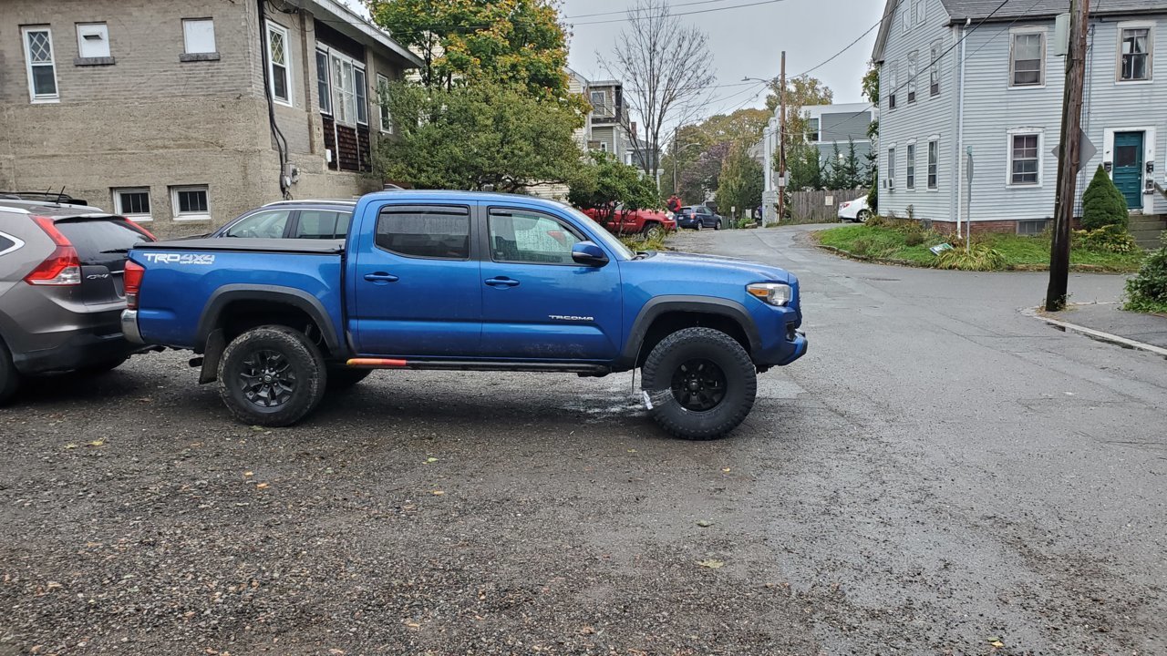

    So I bought the HD springs from them and have had them on for about a month now. The hd springs are basically stock geometry with thicker leafs i think, and I've got at least 2" unloaded, maybe even 2.5". The ride is much more compliant compared to stock, combined with 5160s the rear feels much more planted and stiff in a good way. And they were like 350 shipped with bushings in already, would absolutely recommend them

    3/1 I believe, thank you :D I love the setup, super comfortable on road and tons of extra clearance off road
