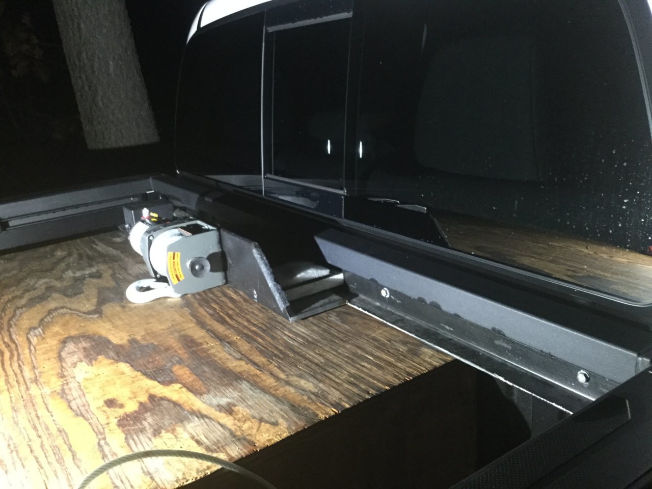

    I run a remote controlled winch mounted to the front rail using the 5 threaded inserts on the rail for attachment. Ran 1 1/2” angle all the way across to spread the load. The cable is run into a fairlead attached to a bar that slides into the side rails. I use this setup to pull deer into the back of the bed. I also have a piece of plywood as a ramp. Not a very good picture as it was taken at night.B1AF97C7-6105-46EF-9240-8A26711C4D02.jpg
