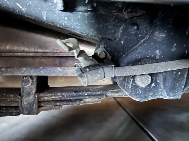

    Leaving it dangle makes a fun noise to diagnose what is going on (if you're the type to pay attention to your vehicle noises). Mine sounded like coins in a metal can being shaken around. I zip tied it to the front mount where the parking brake cable comes off the frame:
