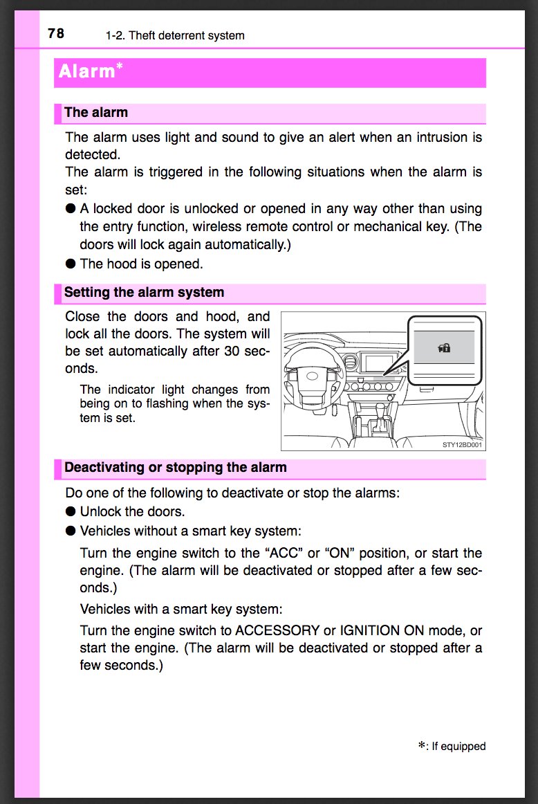

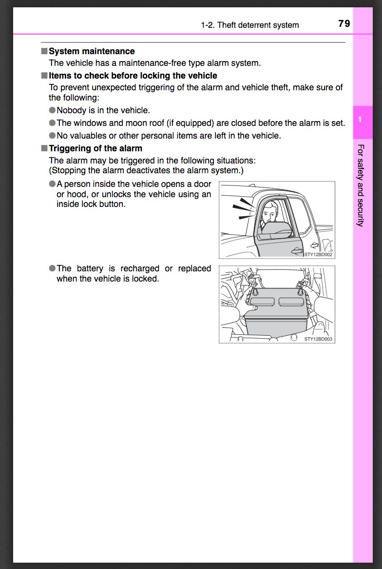

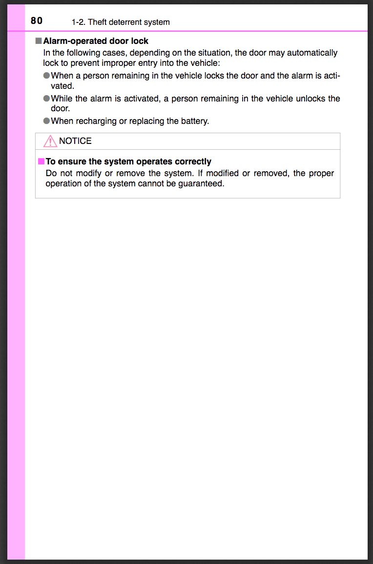

    Owners manual pages about the factory alarm. I didn't know how it worked either until just now:
