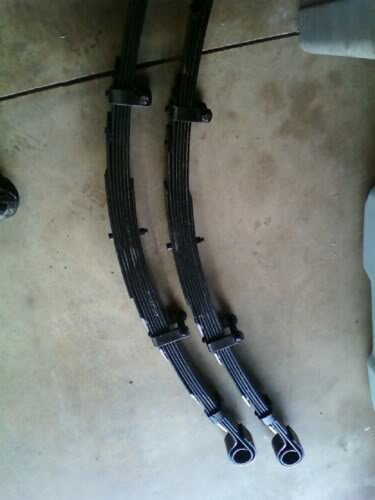

    Just picked up my AP 3" standard leafs.

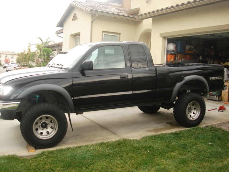

    Just finished my install today here are my measurements with the allpro expos 3" w/ 10" 5150's and extended brake line before and after.
    allpro 3" w/ 10" 5150's bottom center tire to bottom of fender 41.5"
    Stock leaf springs w/ stock TRD shocks ive had since i bought this truk bak in 04'. 36.5"
    So there u have it i hope it settles bc its a little raked so the allpro 3" expos with the 10" 5150's gave me 5" of lift in the rear. like my chalk block a piece of wood lolz..it worked though.
