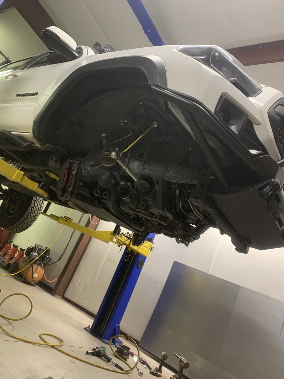

    Updates:
    These build threads are hard to keep updating when you work on your truck often. I’m down to the last few things on the truck. Will update the mod list in the next few weeks. Until then here are some teasers:
    BugJuice likes this.

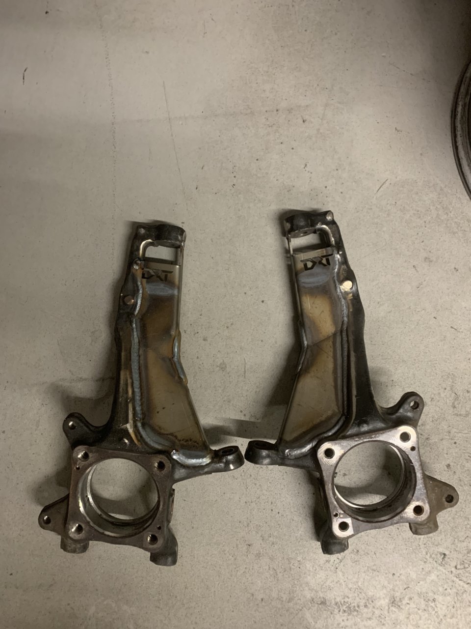

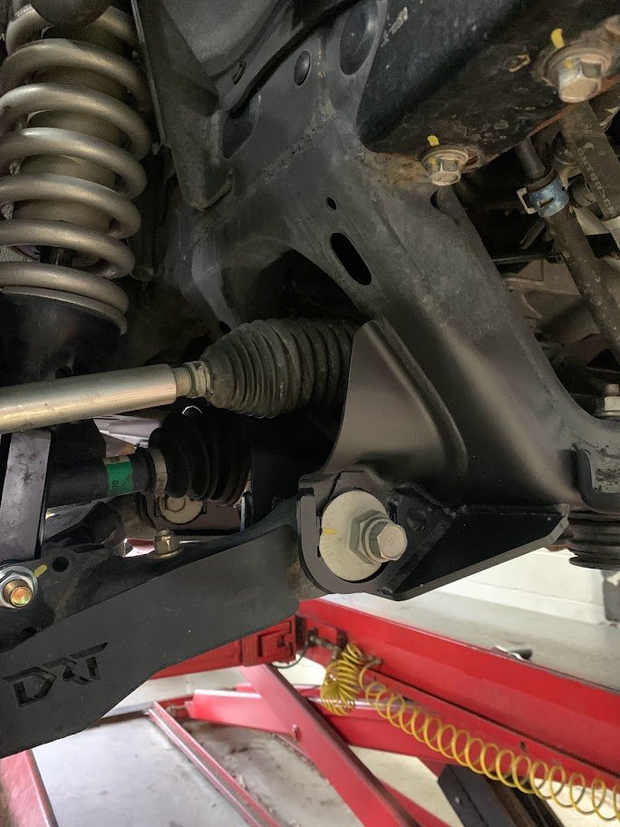

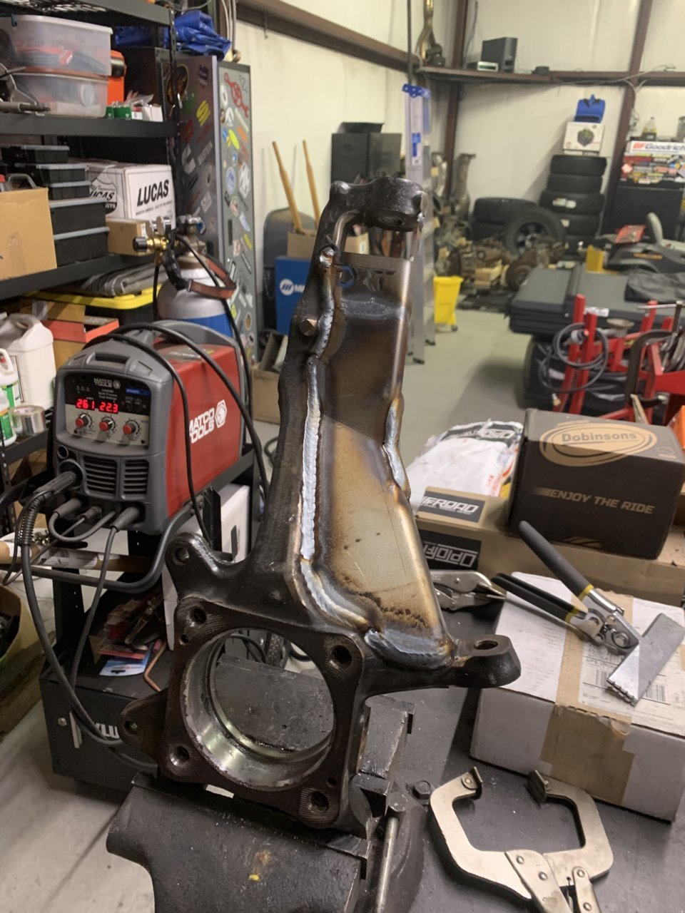

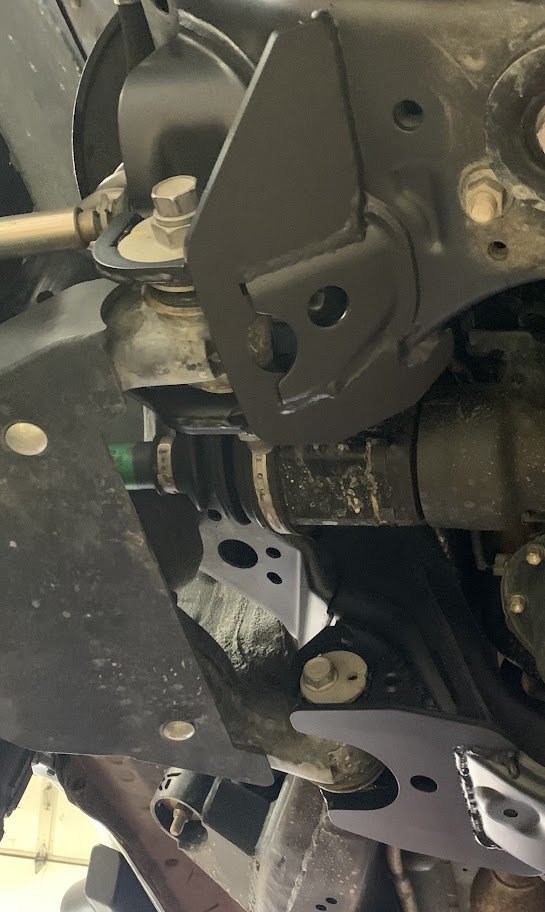

    These mods aren't the most fun, as you don't gain much except some piece of mind on the trail. Plus they are a ton of work.
    But this round of mods I added the following:
    DRT Spindle Gussets
    Marlin Crawler LCA Braces/Cam Tabs
    Tenmile Tacoma, BugJuice and RyanDCLB like this.

    Also -

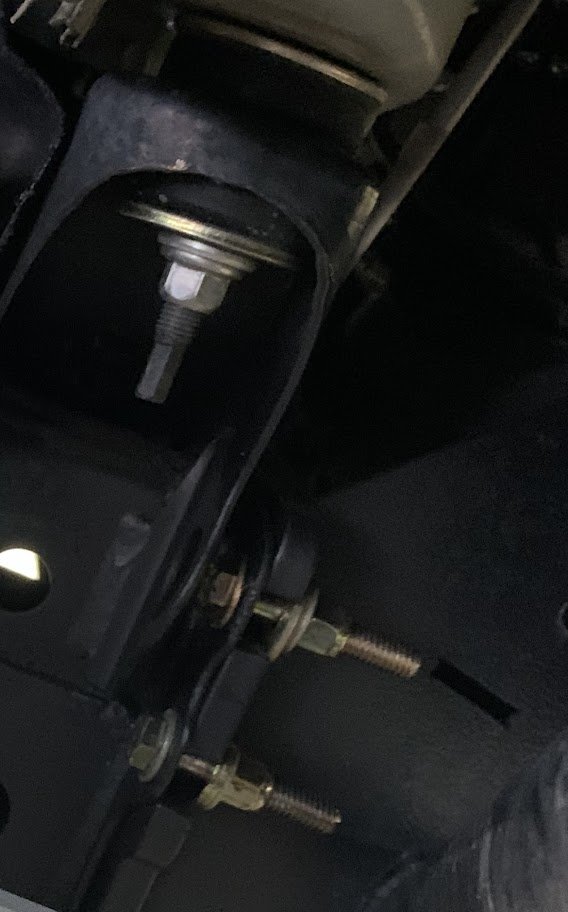

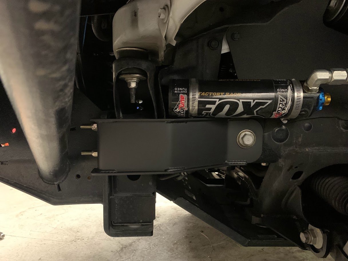

    While I love my SSO Bumper, I never liked the mounting style. It uses the factory frame horn bolts, but their plates are a bit thicker than everyone else's so you only get a few turns of the factory nuts. Add to the fact that the adjustment holes on the bumper plates are nearly the same size as the factory nuts, it made me a little nervous if I would ever need to be pulled hard.
    Cut off the factory frame bolts, replaced with a Grade 8 3/8 by 2" bolt, with lock nuts.
    Added a frame brace that tied around the front frame horn bolts, and tied in further back on the frame. Used a leaf spring hanger bolt and some giant washers that were lying around. Not going anywhere now, LOL.

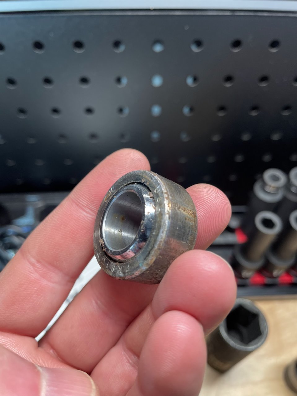

    My front lower bearings on the Fox's were starting to squeak terribly. Got a replacement kit and better lower shock bolts from 303 Shock Services. Added some grease between the spacers to make sure it stays quiet for a little longer. Pic below shows the rust and some wear.
    Added a strap across my bedrail mounted spare tire, just a little more reassurance.

    Yup, what’s most impressive is that rear frame bracket bolt goes through my shock reservoir brackets (which are steel).
    The resi brackets are bolted to the bottom of the frame with two big 1/2” bolts.
    Sooo just the sheer strength of the three 1/2” bolts is a giant number. I’m pleased.
