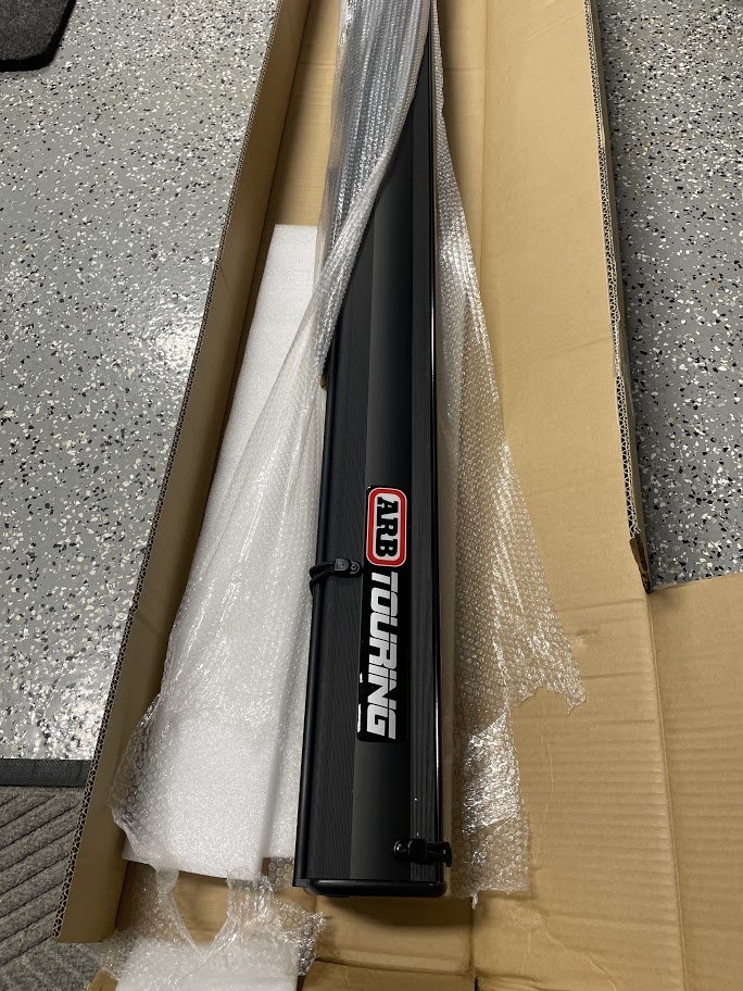

    Picked up an ARB awning with the black aluminum case and LED's for an upcoming trip.

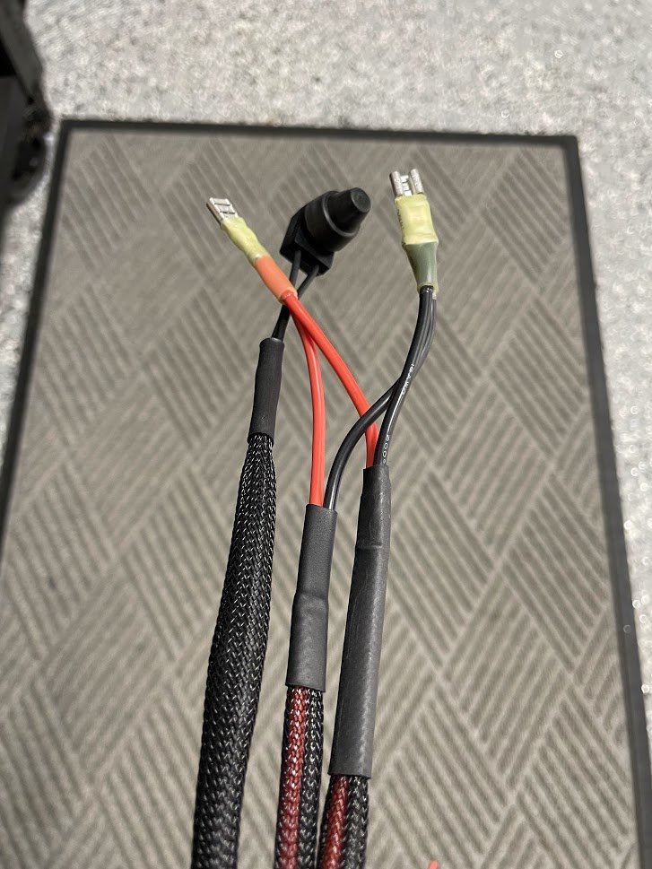

    Also, I'm OCD about wiring. Here's an example - this is for some 12v stuff in the bed. Techflex loom and Shrinkflex heatshrink. Not as fancy as Raychem heatshrink, but a little cheaper for us regular dudes.

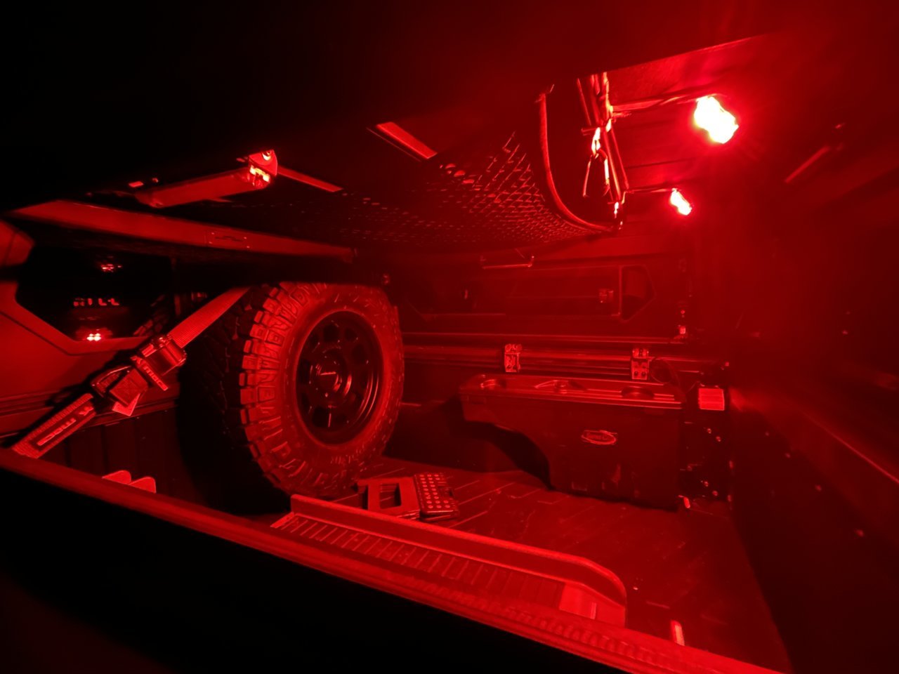

    Finished up my bed 12v wiring.
    2 surface mount switches. One for regular white LEDs and one for red LEDs.
    I only wanted one 12v port in the bed but my first 12v socket from Amazon had an internal short in it, so then I bought a Blue Seas version plus a Blue seas switch panel with 12v and USBs.
    All of this is ran to a fuse block behind the tail light. The fuse block is fed via 10gauge from the battery.

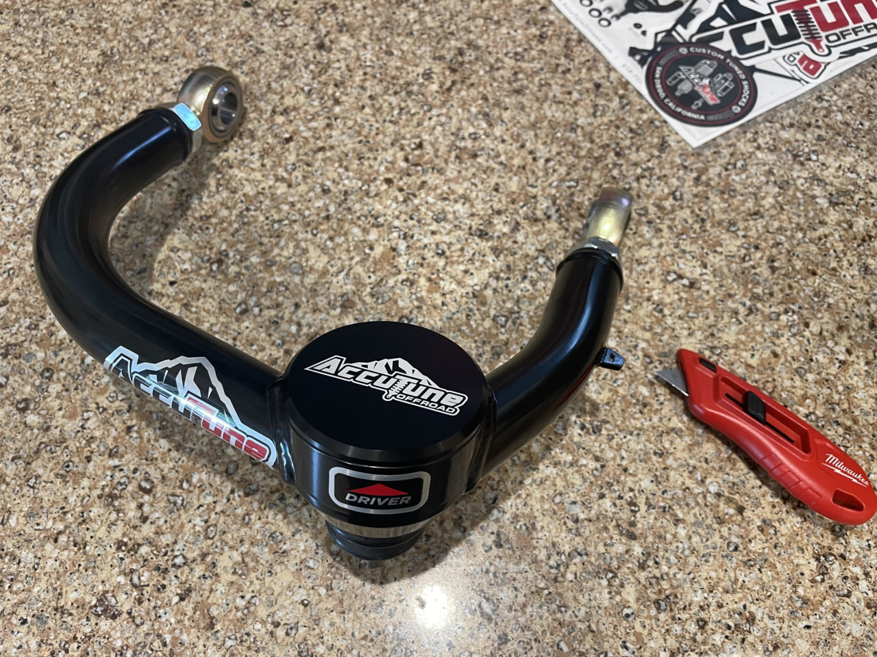

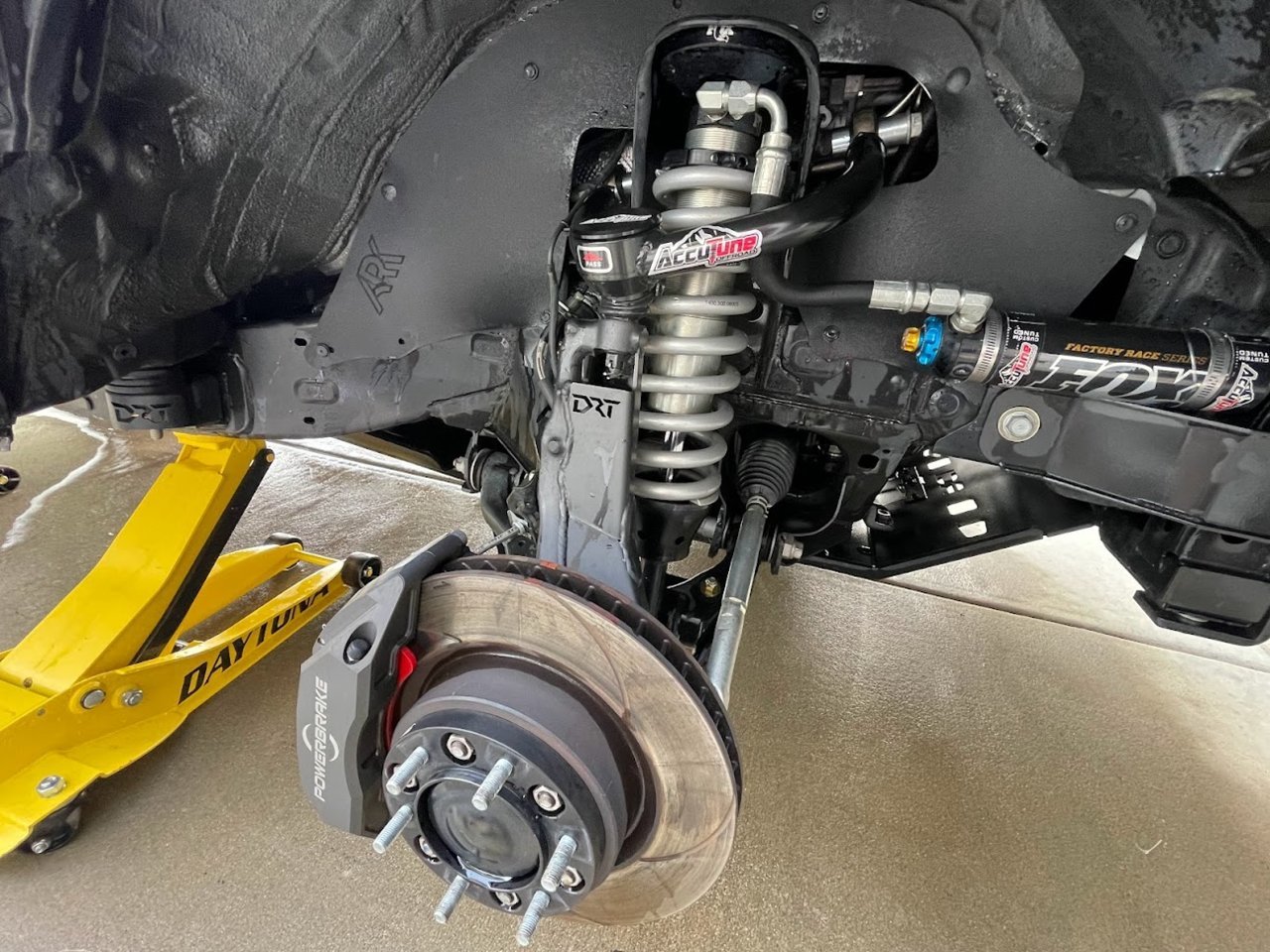

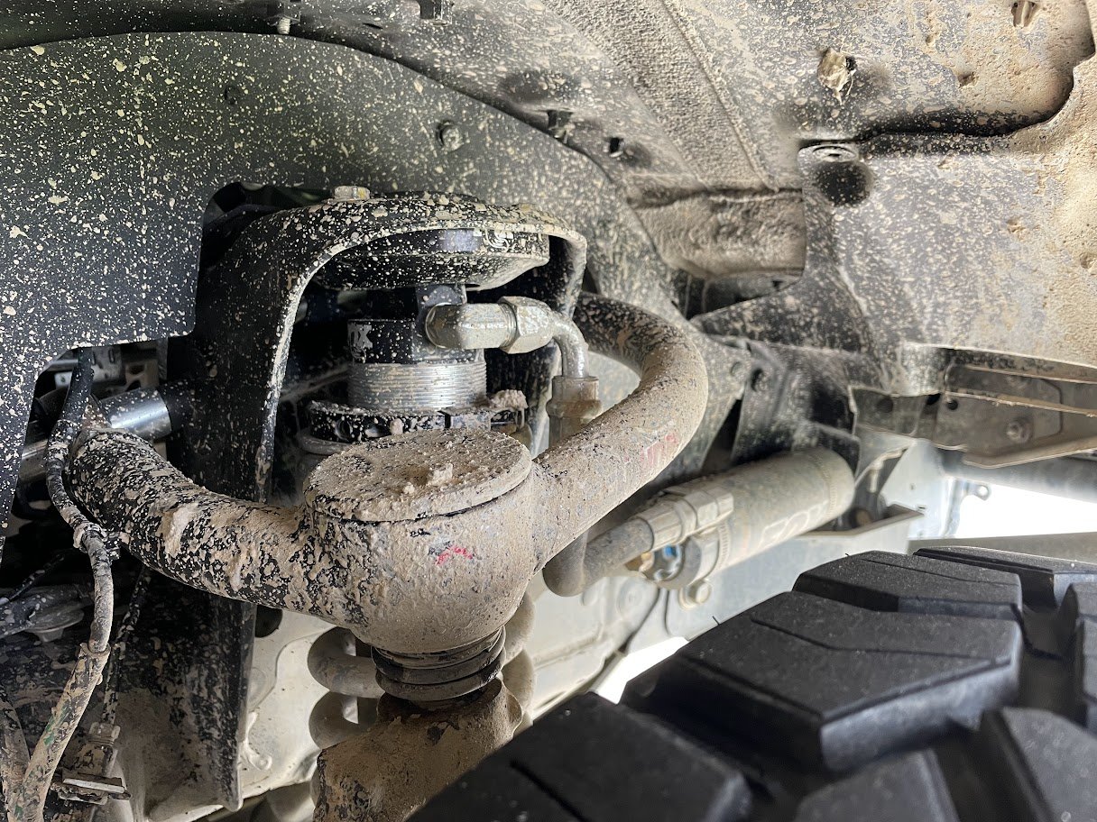

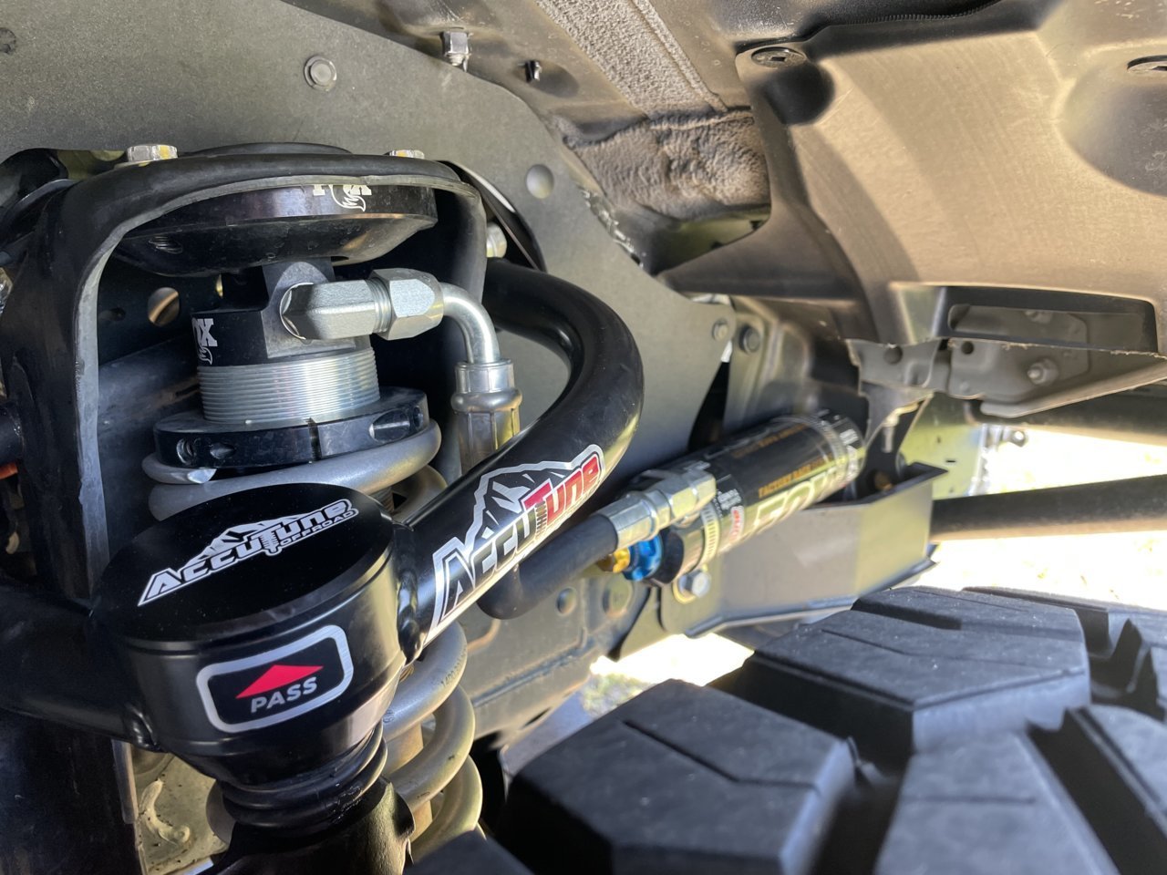

    Didn't have a ton of luck with SPC UCA's. First set lasted 12k and the X-axis bearings were toast. Giving me a shitty clunk noise at slow speeds when the suspension would weight and un-weight. Typically only pulling into my driveway. Second set lasted 9k, same thing. SPC will warranty them, and cover your expenses for install/alignment, which is stand up. But it still costs me a day off work.
    Put a set of the new Accutune arms on and hoping for better luck. Broke them in over the weekend.

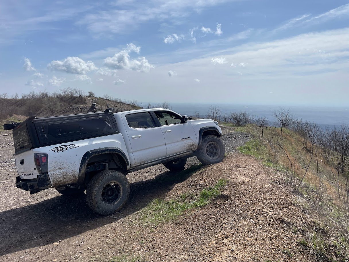

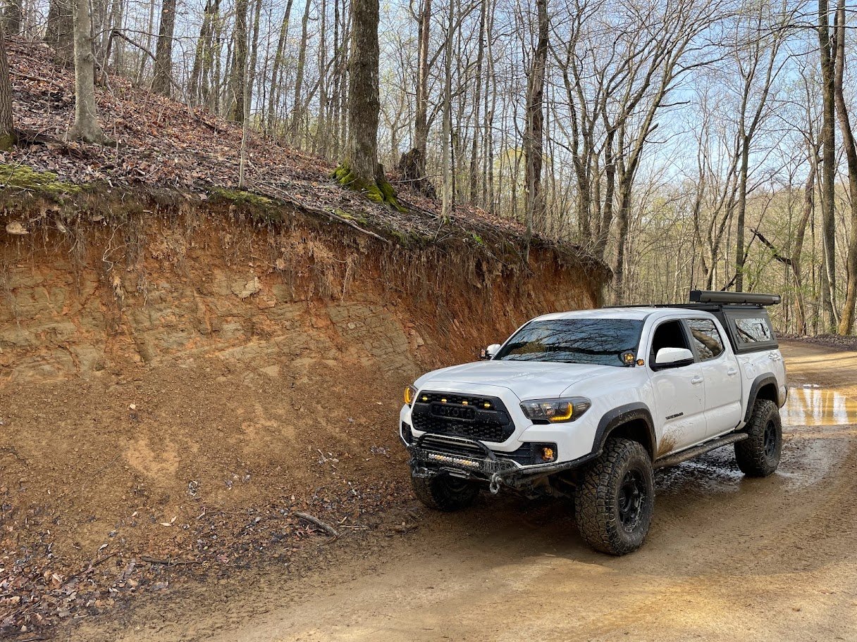

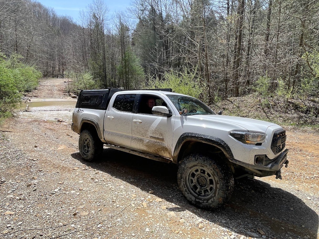

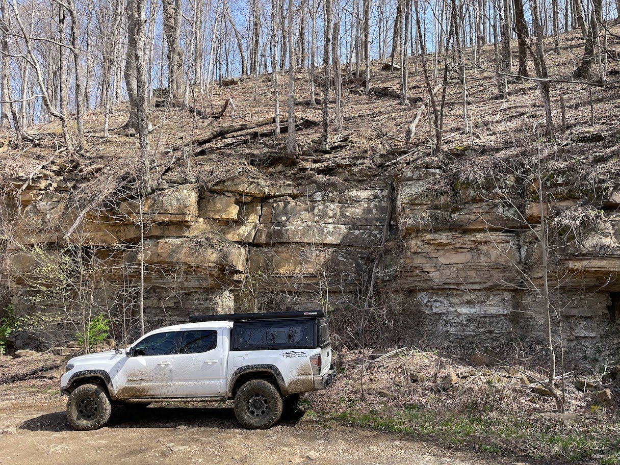

    Spent the weekend up at Windrock in Oliver Springs TN.

    I don't envy having to re-install UCA's. That bolt was a headache.

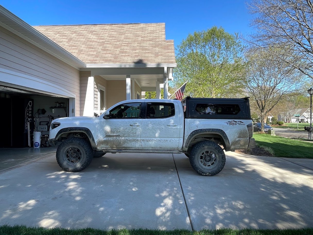

    Truck was the dirtiest it's ever been after Windrock. I do plenty of days per year of wheels off detailing, helps keep everything clean and helps me to find issues. This one was a pain.
    I have about 2 hours of pressure washing the body and undercarriage, and about 2 hours pulling the wheels and manually scrubbing out the wheel wells. Will have another hour or so actually washing the truck.
    Lots of rain this weekend should soak the rest of whatever mud I missed from the undercarriage.

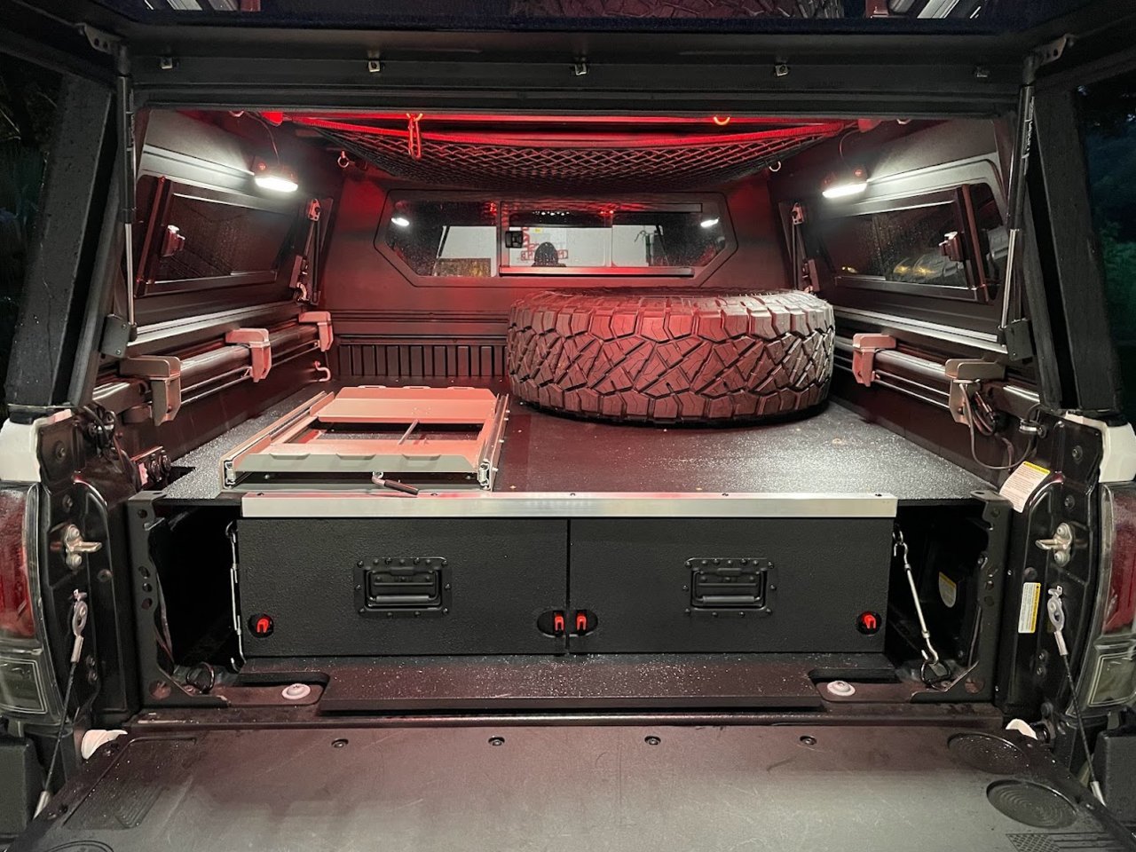

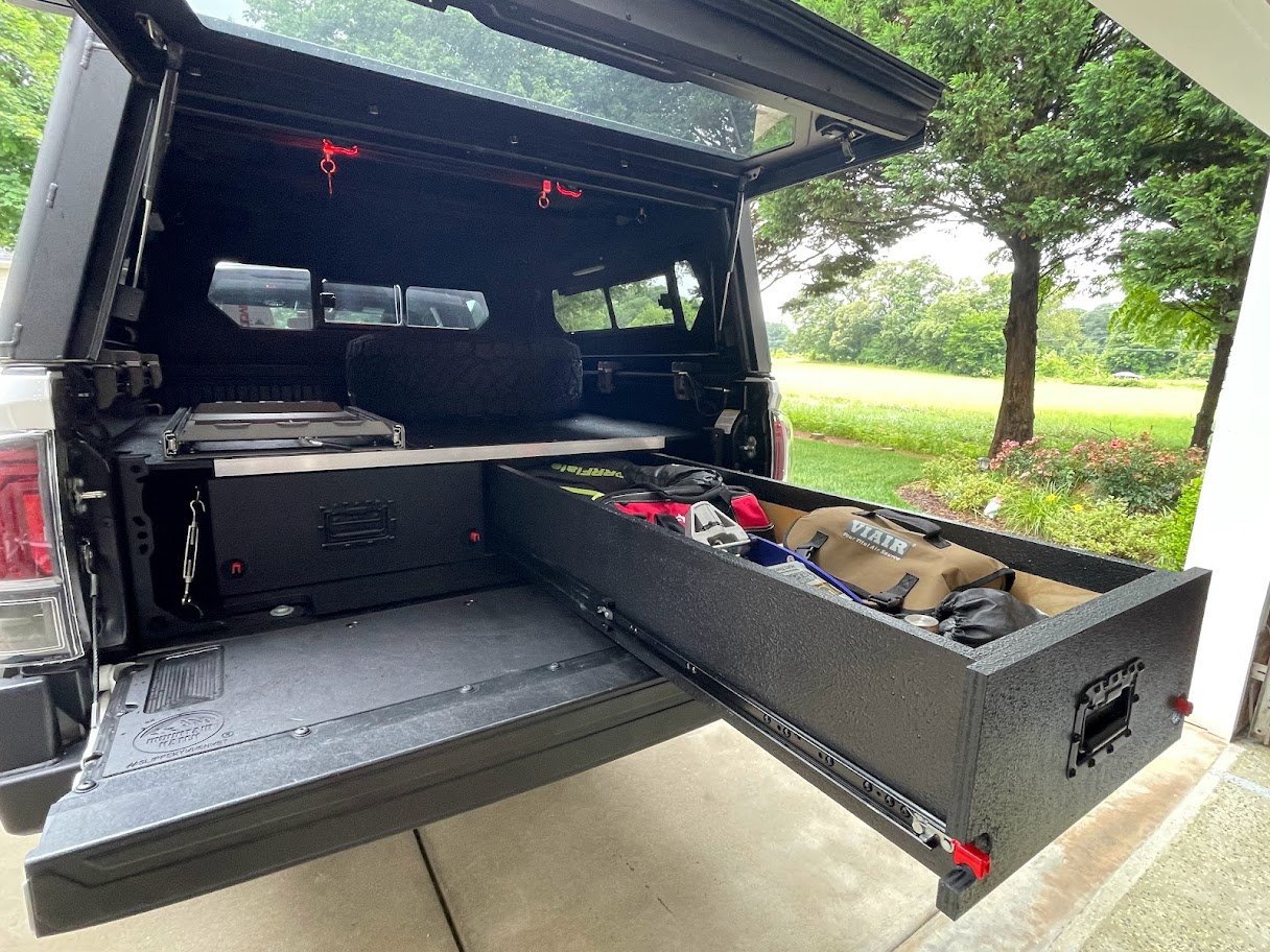

    After last weekends camping trip, and fully knowing I'm doing a cross country trip this year, I started asking some local cabinet builders to see if they are interested in building some drawers for my bed. Decked system is nice, but everyone says its heavy and isn't a great use of space. I could DIY, but I don't have the tools to make it super pretty. I'd have to bump up the wood a few sizes to make it strong enough, and end up losing out on space and take a weight penalty.
    This would mean my spare tire mount would change, and I'd lay it on top of the platform. But then I could run a fridge and proper fridge slide, and some other stuff.
    We will see what they come back with.

    It's hard to accurately rate suspension unless you can drive identical trucks on the same day and same terrain. The Fox's are nice most of the time, but the harsh bumps and washboards leave something to be desired, but my Eibach's were even worse.... Just a big chunk of money to still be a little turned off by it all.
    Accutune UCA's are great so far. Not a hint of noise or play. But it's only been 3 months or so. The SPC's were already making noise at this point on both sets. As far as the SPC's, if you run a front swaybar you're probably safe. My master Toyota tech that lives and breathes these Toyotas and does hundreds of lift kits per year, only has seen the SPC UCA's fail on trucks without a sway bar.
    There are some other arms out there that should be similar and on your list such as the JD Fab UCAs with OEM upper bushings.
