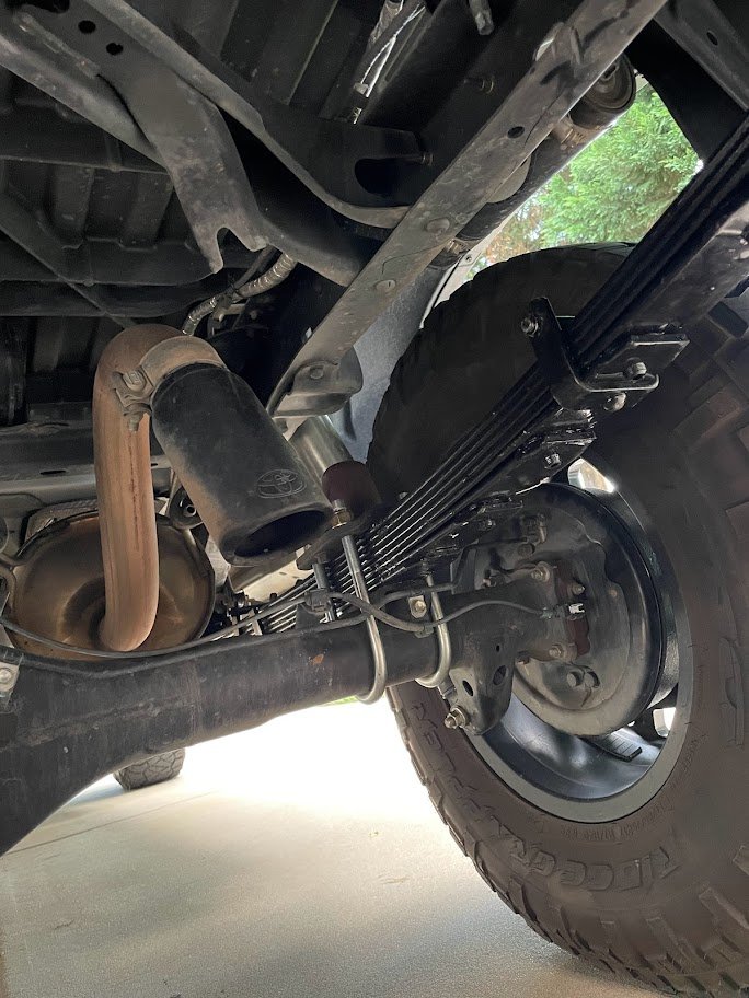

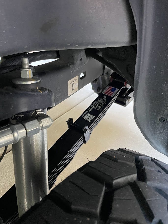

    So I've had my truck "built" for a while, but it hasn't been used or abused much. 10-15k miles of daily driving, a couple mild trips into the woods.
    I've been through a LOT of parts trying to eliminate noises, clunks, failure points.

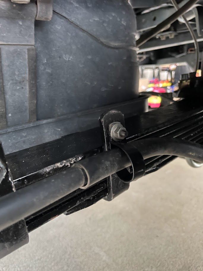

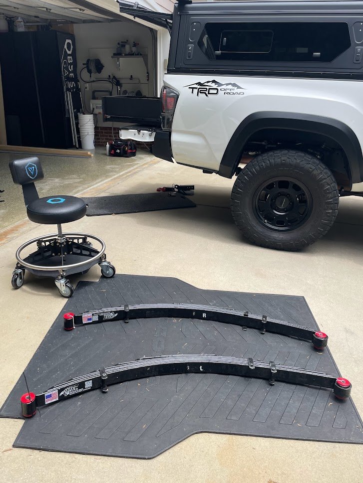

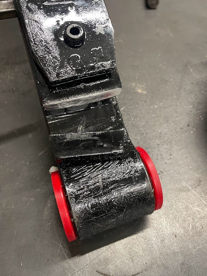

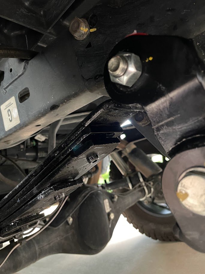

    More recently, my Icon RXT's started to make some awful creaking noises from the front and rear bushings. I also had a clunk that sounded like the leafs were shifting in the packs and hitting the leaf pack clamps. After waiting for about 3 months for Icon's customer support to give me any direction, I started looking into other options. I had added drawers, and would need to take my Icon leaf pack from Stage 2 to Stage 3 due to the weight. Unfortunately I wasn't feeling great about the leaf pack long term, so I decided to go with Alcan's.
    Alcan will make you weigh your truck, ask for an exact lift you want, and build you a custom leaf pack tailored to your weight and lift. I keep my truck low in the front (2" of lift), so I went with 2" lift in the rear. He already accounts for the 1" of rake the truck has from the factory. I wanted to retain that.
    Not many posts about these leaf packs, but they are made incredibly well and are coated in a thick paint like undercoating so I'm hoping the coating lasts a little longer. The leaf packs are supplied with Prothane bushings that are grooved on the inside for extra grease holding. Superlube was used to repack all the bushings in both the leaf pack (they come without grease) as well as my Archive Garage shackles.
    The bad:
    The second leaf in the pack is a little long. My buddy has done a few installs of Alcans on trucks equipped with hammer hangers and the second leaf rubs either the shackle or the hammer hanger slightly. I have the latest hammer hangers, the above might be true on all versions or some older versions, but it was far easier to just cut an inch off the leaf instead of throwing them on, seeing if it rubs, taking them off, repeating, etc. We spread the leaf pack to not cut into the other leafs accidentally, and used a porta-band to cut the 1" piece off. We then ground and smoothed the edges so it won't rub/cut into the other leaf. Quick blast of spray paint and we are good to go.
    The good:
    The Alcans ride great. I only have about 70 miles on them, but they are firmer and more controlled than the Icons, which trends into much better road manners. The difference is definitely noticeable and I'm very happy with the new ride. The Alcans also have a bracket for the ebrake cable. Used a large cushion clamp to secure the ebrake cable to the bracket on the Alcans. I never had a bracket on my Icons, and had zero issues running them that way, but it was always something I wanted to do right.
    I will retorque in a few hundred miles and re apply my paint marking :)

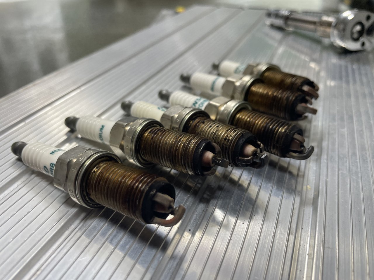

    Got my plugs changed. Long list of little things to get done over the next month.
    Passenger side took about 10 minutes.
    Drivers side way tougher, took about an hour and lots of swearing.
    Did not remove the intake manifold brackets, but would recommend doing it. You’ll have to get the bottom bolt through the fender well which makes it a little more of a PITA.

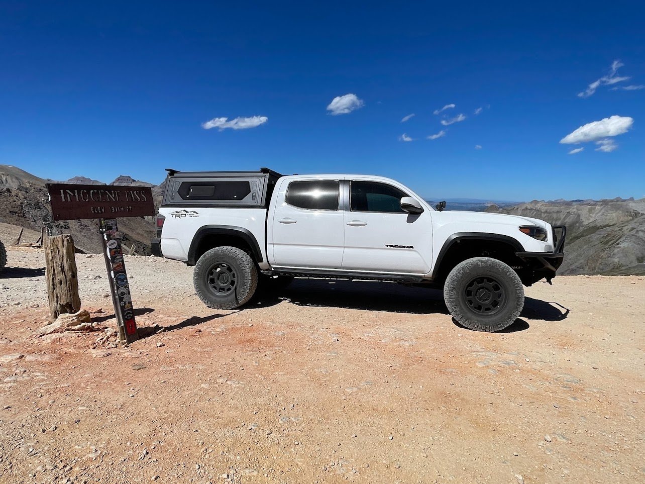

    So a couple of weeks ago, wrapped up a 4820 mile road trip.
    Charlotte to Denver, couple days in Denver and jetting up to Rocky Mountain National Park
    Denver to the San Juan area (Ouray and Telluride)
    Ouray to Moab, Arches National Park
    Moab back to Charlotte
    We budgeted for 15-16 days door to door. 2 days out to Denver, 3 days home from Moab.
    I ran some famous trails like Imogene pass in Colorado, and a few of the popular trails in Moab.
    I had done a lot of truck prep a month prior to the trip. New C4 bumper, C4 fender liner kit, lots of little maintenance things, etc. Happy to report I had no mechanical issues and didn't have to work on anything.
    I got home and basically had to redo all of my maintenance all over again, so that's been the last few weeks. Will be sending out the Fox shocks to be re-valved, I should have done this early on, high speed is way too stiff and jarring. We don't have enough rough fire roads for it to be really annoying out here near Charlotte, but out west it was very apparent.
    Here are some pics:

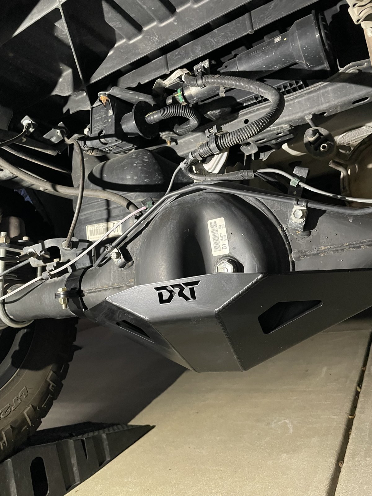

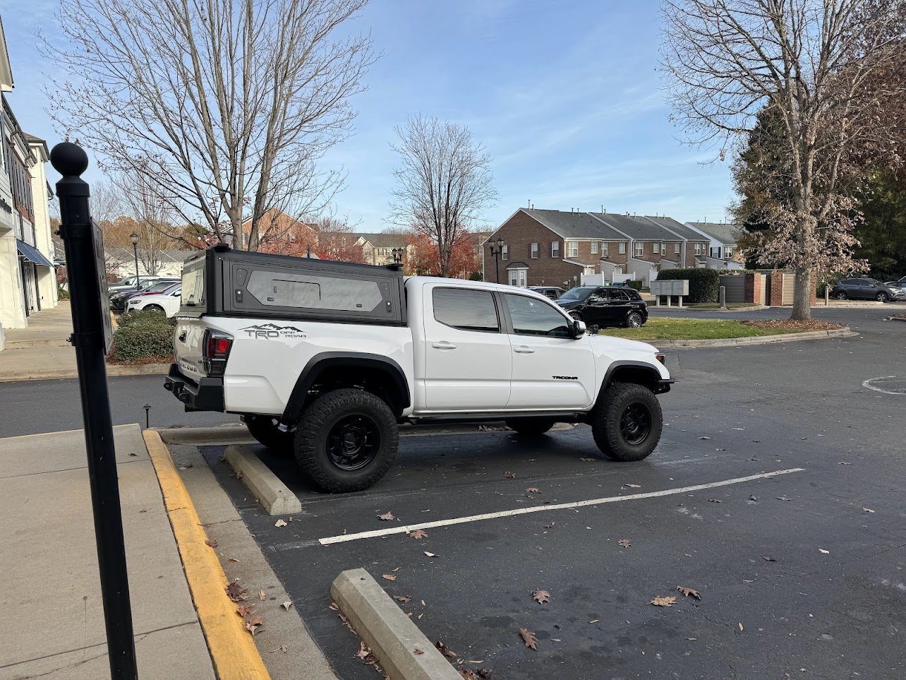

    Not much going on here lately, had my 4th major ankle surgery in the last 3 years. Couple months of downtime ahead of me but excited to get back outside when the time comes.
    Been collecting some parts for a major refresh and update this spring.
    Got the @drtfabrication rear diff skid on right before surgery.
