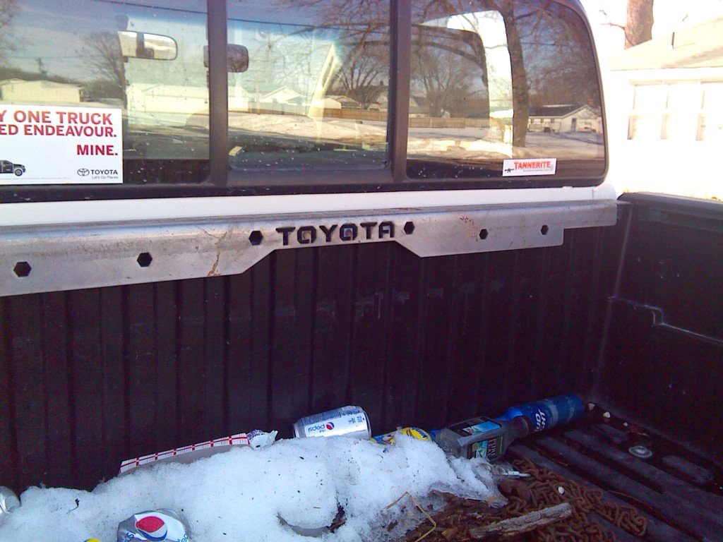

    Okay, i've started working on this project. I work at a machine shop/welding shop, that also does powdercoating (any color black you could possibly want) and I also am big into ATV's and Fourwheeling. Well, not long after I picked up my Regular Cab Short Bed tacoma, I realized I had a problem. There is no room for a toolbox or any way to protect my back window from a fourwheeler in the bed of my truck and still shut the tailgate. Yeah, i've thrown a board in there a time or two, or used an old tire, but I wanted something solid, that would mount to the factory rail, and look good, without sacrificing a lot of visibility out of the already microscopic back window. So, I drew up some plans, took them to the CNC plasma, and here's what I came up with:BedBarRendering_zps85a5cec2_7195f41f5d0628215dd202b188c9a2fa61b65e7c.jpg
    So after transferring it to a print, cutting it out, and forming it, here's the base bar, that curves around the factory bed:

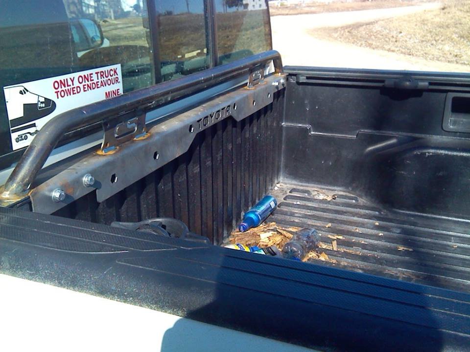

    And here's what it looks like, until later this week when I weld on the D-Rings and powdercoat it. I still have full visibility, fourwheeler fits great, and mounts to the factory bed rail with some 1/2" T-slot nuts.
    I am thinking about selling these down the road, I can do small custom touches, change the bar height, do light tabs, etc...
    The tags between the bar here are custom too, just my initials in a design I like. There's a guy at work who wants me to do the same thing, only with TRD instead.
    This works, to my knowledge on any of the 2nd Gen tacos, and fitment has been confirmed on the 2014 DC SB too.

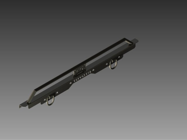

    i'd be interested in the one shown in picture 2 w/o the extra bar.

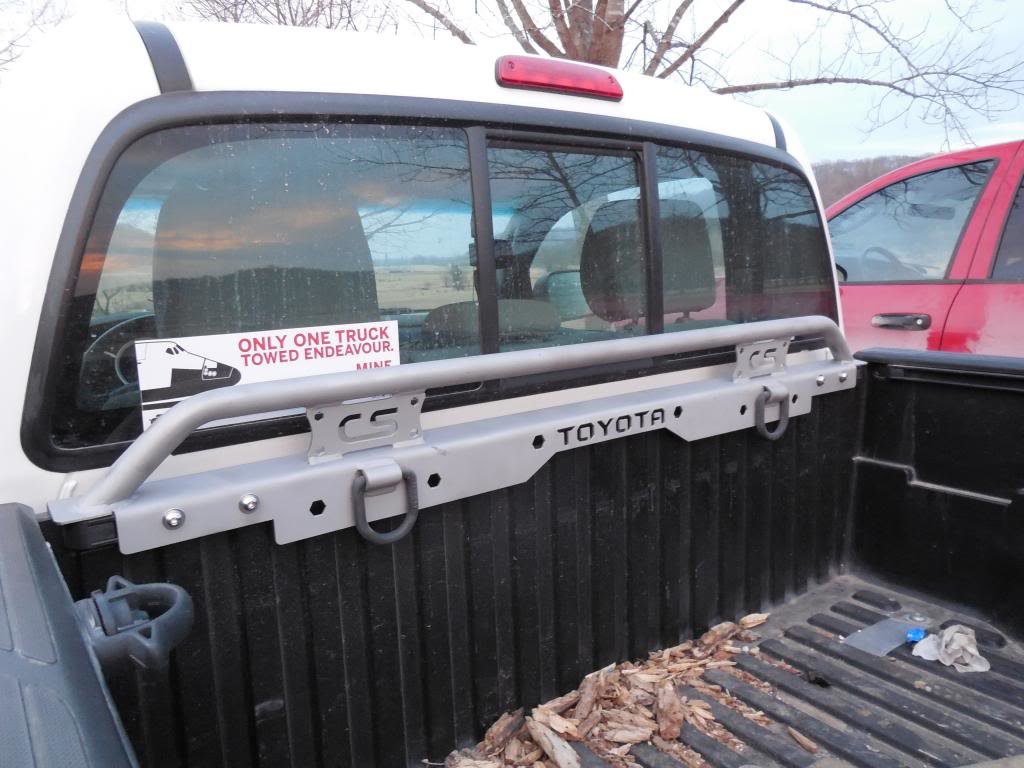

    Well, here's the finished version, ready for powdercoating with D-rings attatched.
    A guy at work with a 2014 TX Pro Tacoma wants auxilliary light tabs in his, and he wants the tags to say TRD instead of CS. I simply did the CS because those are my initials.
