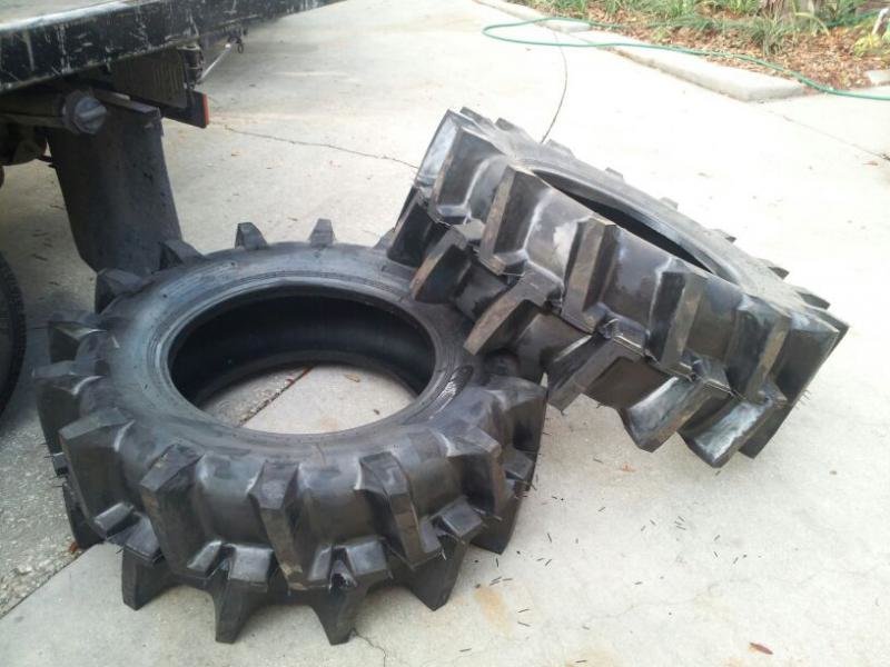

    Get some of these!
    678851d1339959685-r2-rice-paddy-tractor-_f4310c66118fffb8b2a9f3c09437032b337343cc.jpg
  9. Nov 7, 2018 at 1:25 PM
    BarnBoy
    BarnBoy Well-Known Member
    Dec 11, 2017
    #238274
    582
    96 Tacoma 2wd
    Those some kind of rice paddy tires?

    No clue. Searched mud truck tires and they came up.
