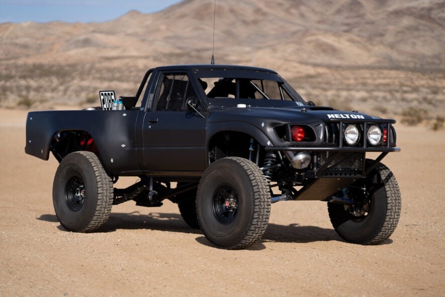

    Did you ever end up doing this? I'm interested because of the rotational weight savings and I'm trying to run a light truck. This guy put Tensor DSR37 tires that measure 37x10x15 (and the 33's weight 39lbs): https://www.race-dezert.com/home/matt-heltons-super-yota-race-truck-sy4-243928.html. I'm not going for a prerunner, but just saying. 1600 lbs. load rating for the 37s. Here is Tensor's air pressure guide: https://cdn.shopify.com/s/files/1/0667/0741/files/tensor-air-chart-5-19.pdf?v=1621456205
