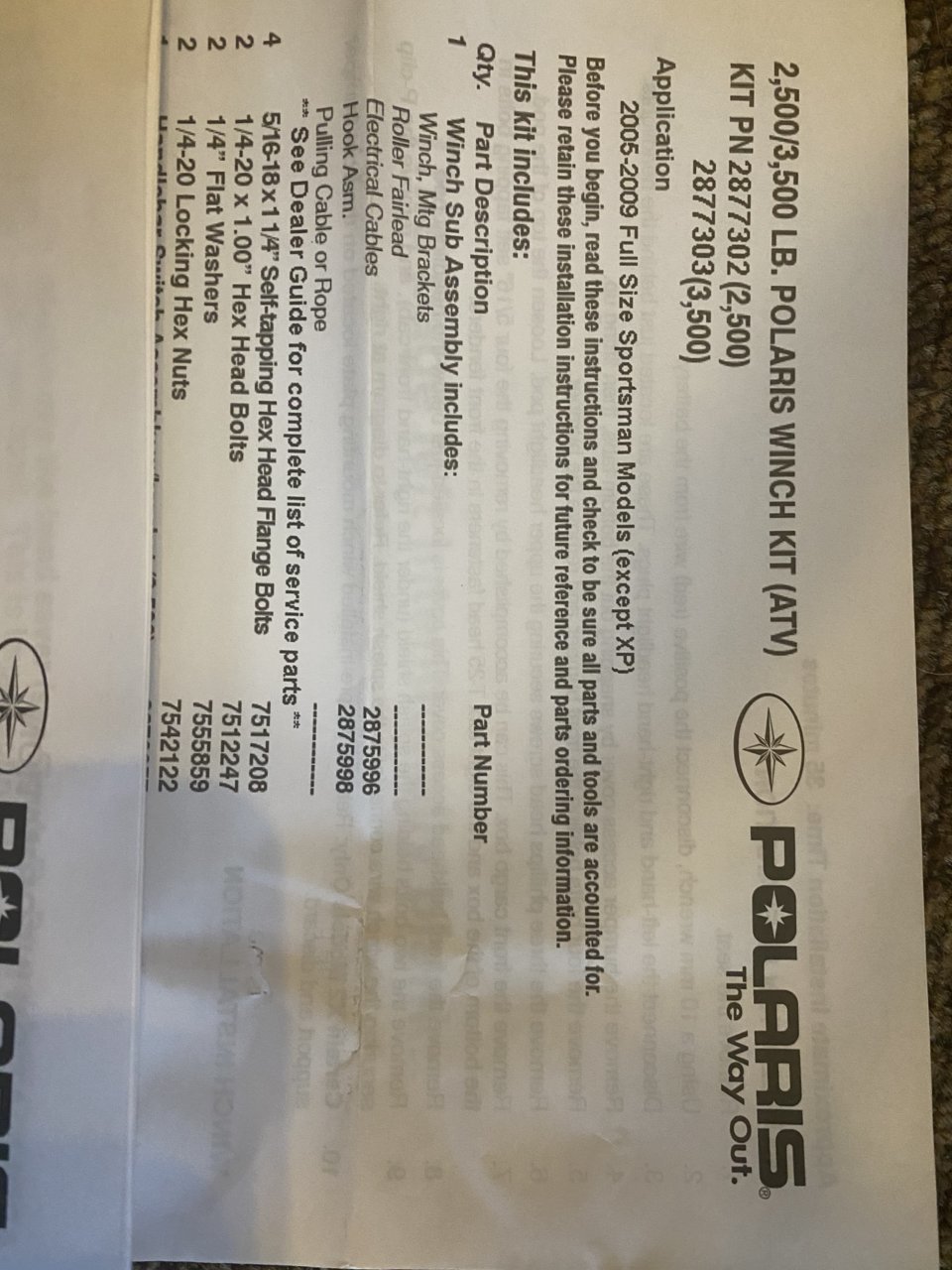

    But I do have an ATV with a winch on it and the steel cable it came with is pretty frayed after years of use and is starting to scare me more and more every day. So it's time for a new cable and I was looking for some input on steel vs. synthetic. Its main use is for raising/lowering a snow plow which gets used several times a winter as well as a few times during the summer to regrade our gravel driveway. Other than that is sees occasional use (a handful of times each year) for forestry related activities like moving and positioning logs and acting as an anchor point when felling trees.
    Attached is the model number, I'm actually not sure if it's the 2500 or 3500lb because the winch is buried in the bumper and I can't see the nameplate.
