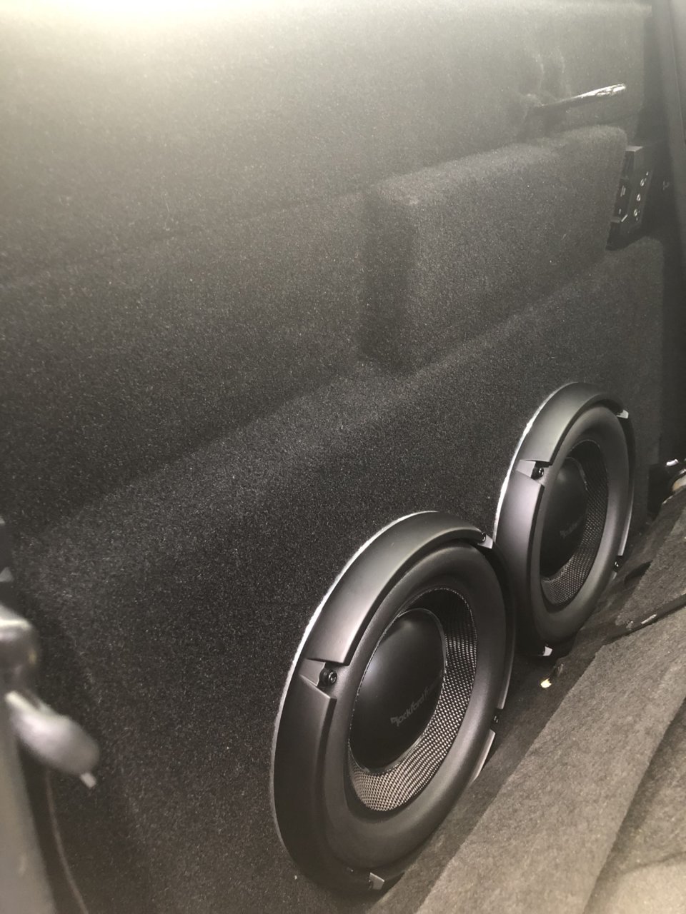

    i went went the rockford 360.3 processor two set of t2 6.5 components , t1 600x4 , and a t1 500 x1 which pushes constant 750 to t1s1 10inch

    476F165D-0E05-4451-A992-53F096CFD261.jpg the guys the put my sub did 1/2 ass , took the whole pocket out of the back behind the seat , which i wanted to keep in really takes away from the look of the RF sub , thinkin of fabing up my own box kinda like taco tunes or oem does
    Been awhile had them re-do with another box and ten
