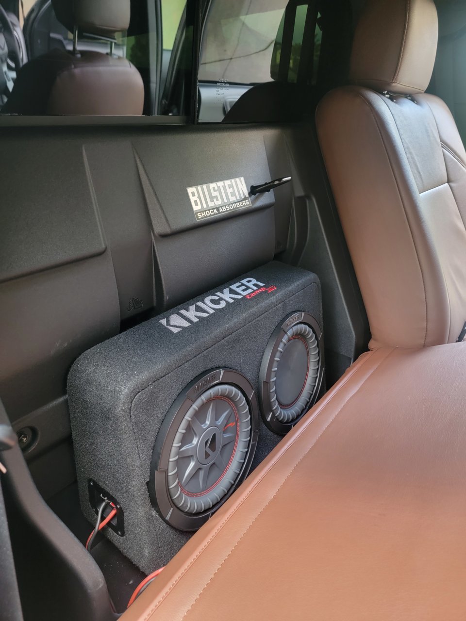

    Well, after many sleepless nights, I decided to install a Kicker mono amp 400W and a 8in Kicker CompRT sub for now with a local shop. I will get the Pioneer 6600 after summer once I saved up enough money :fingerscrossed:.
    To my surprise, the shop owner suggested that i don need the LC7 after he sat in my truck listening to my current set up (Kicker Key Amp with Focal speakers). He said the sound is clean enough for my set up and he was right! After the install, I couldn't be happier with the sound quality now. I wish I could had the 10in instead of the 8in but I didn't want to remove the rear plastic bin.
