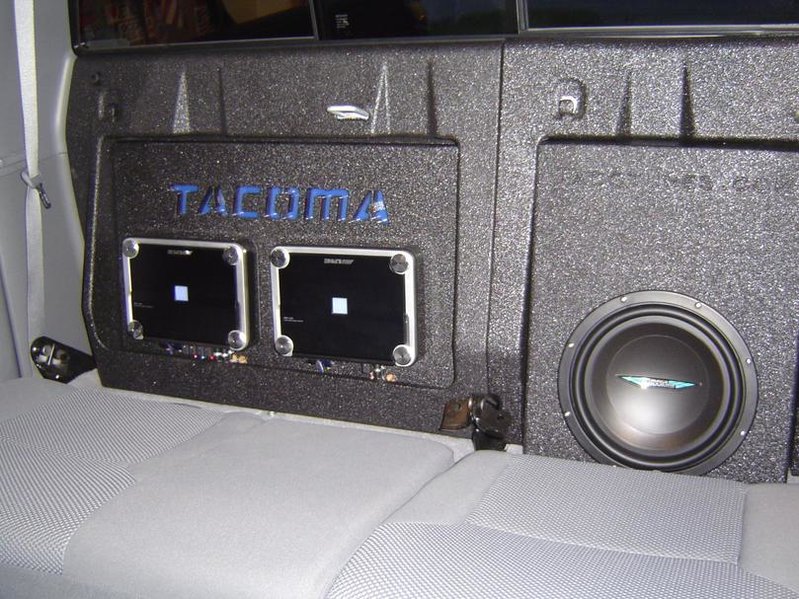

    The sub you picked out is a nice little package. It has great reviews and will definitely improve the overall sound. And it makes installation easier too. But personally, I would go with a different sub. I have this box in my 2005 double cab behind my rear seat on the driver's side. Picking out a sub is a little tricky since they can perform differently in various boxes. And when you listen to them in the stores, they're generally not in the box you end up using. I'd recommend, again, playing music you're familiar with and listen to the sub at various volumes. Just make sure it sounds good to you. However, if you go this route it costs more. If you're just looking to add a little umph at the lower end, the Kicker hideaway is perfect and convenient. But if you want something with more serious bass, buy the sub, box, and amp as separate items.
