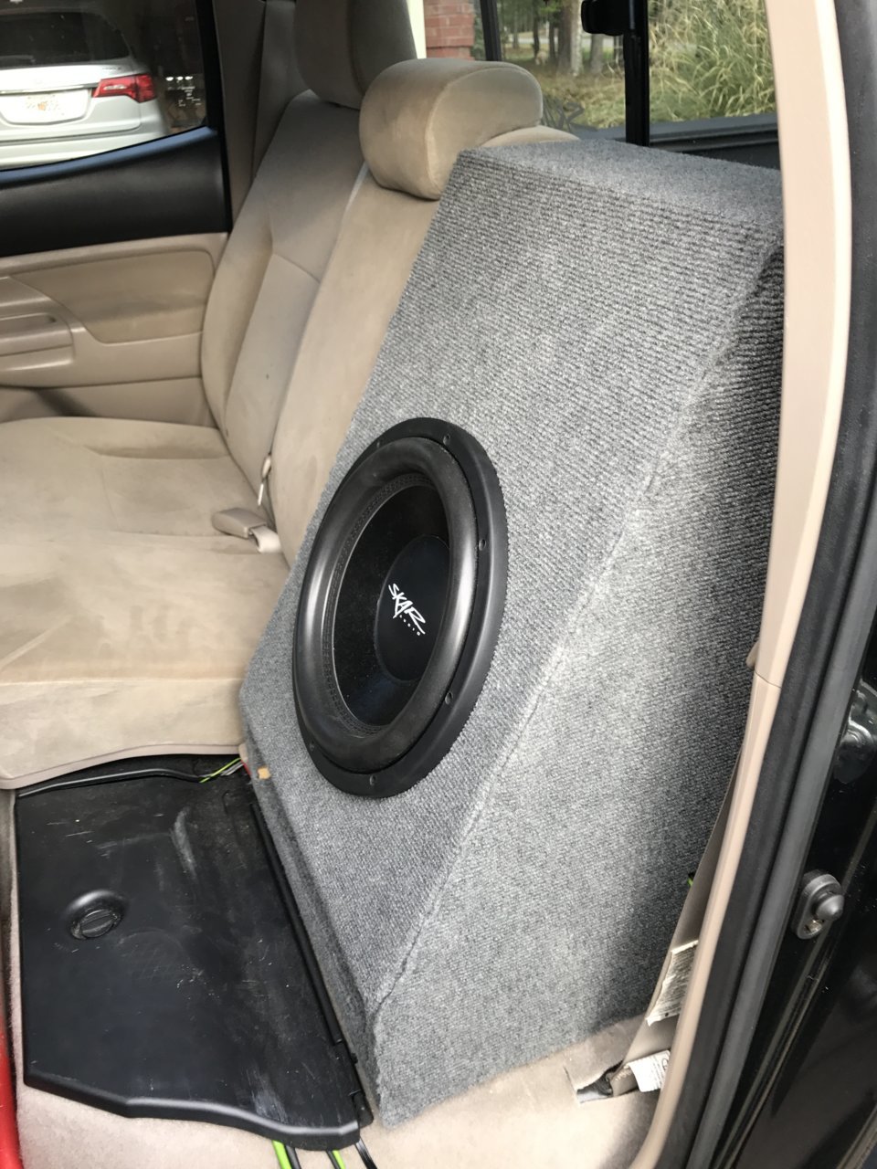

    If you have little to no friends, you can always sacrifice the seating area behind your drivers seat like me :0
    My new 18 inch woofer is going in so I will have even less room for activities here soon. Skar Audio>every other brand.

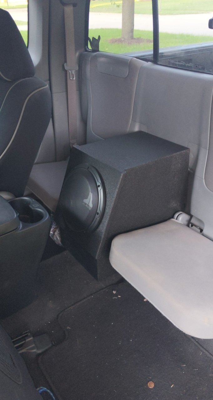

    I just have a 6.5" component set of JL audio speakers in the front doors ran off an aftermarket head unit. 10" JL sub at 300W. Won't be near as loud as any of theirs but sounds great.

    I don't have anymore at the moment. Rough dimensions are 12" D at the top, 17" D at bottom 11.25" W and 12" tall. The bottom support that rests on the hump of the floor isn't part of the internal volume of the box. Used 3/4 MDF and doubled the baffle so the front is 1.5 in. Ended up with about .7 cubic feet after sub displacement and the sub needed .65. If it was any bigger I would have made it butt up against the back of the center console and downfire it. That seems to be the most common solution for access cabs
    One thing to consider if you do go this route is the seat belt buckles. I never have anyone sit back there so I wasn't too worried about it, but I removed the console and seat belt buckles to fit it. I'd imagine you could elevate it a few inches to maintain full functionality, though
