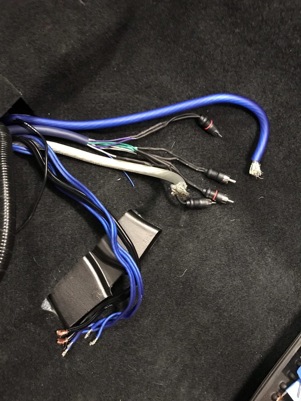

    It plugs into the headunit where the speaker output plugs go. Then it has a stretch of wire that you run under carpet to driver seat and it goes into either a line ouput converter or hi level inputs of an amp. With this installed your factory speakers no longer work since you unplugged them from the back of head unit so the output wires on amp need to run to each speaker. You can avoid this if you just want to cut your speaker wires from head unit and tie into that. So basically all it is for is to save cutting factory wires

    Damn so the taco tunes kit doesn't run back up and connect to the unplugged stock speaker wires? I liked the idea of running a bundle up to that headhunt rather than run wire to all four doors.

    Ill sell you my bundle. 15$ plus shipping. Have a 25’ speedwire 9 wire combo sitting in garage.you could run this from anp back up to stock speaker wire if you wanted. Or you could just tap the wires. Tap front speaker wires behind front kick panels. Tap rear speakers under front driver and pssenger floor panels.
