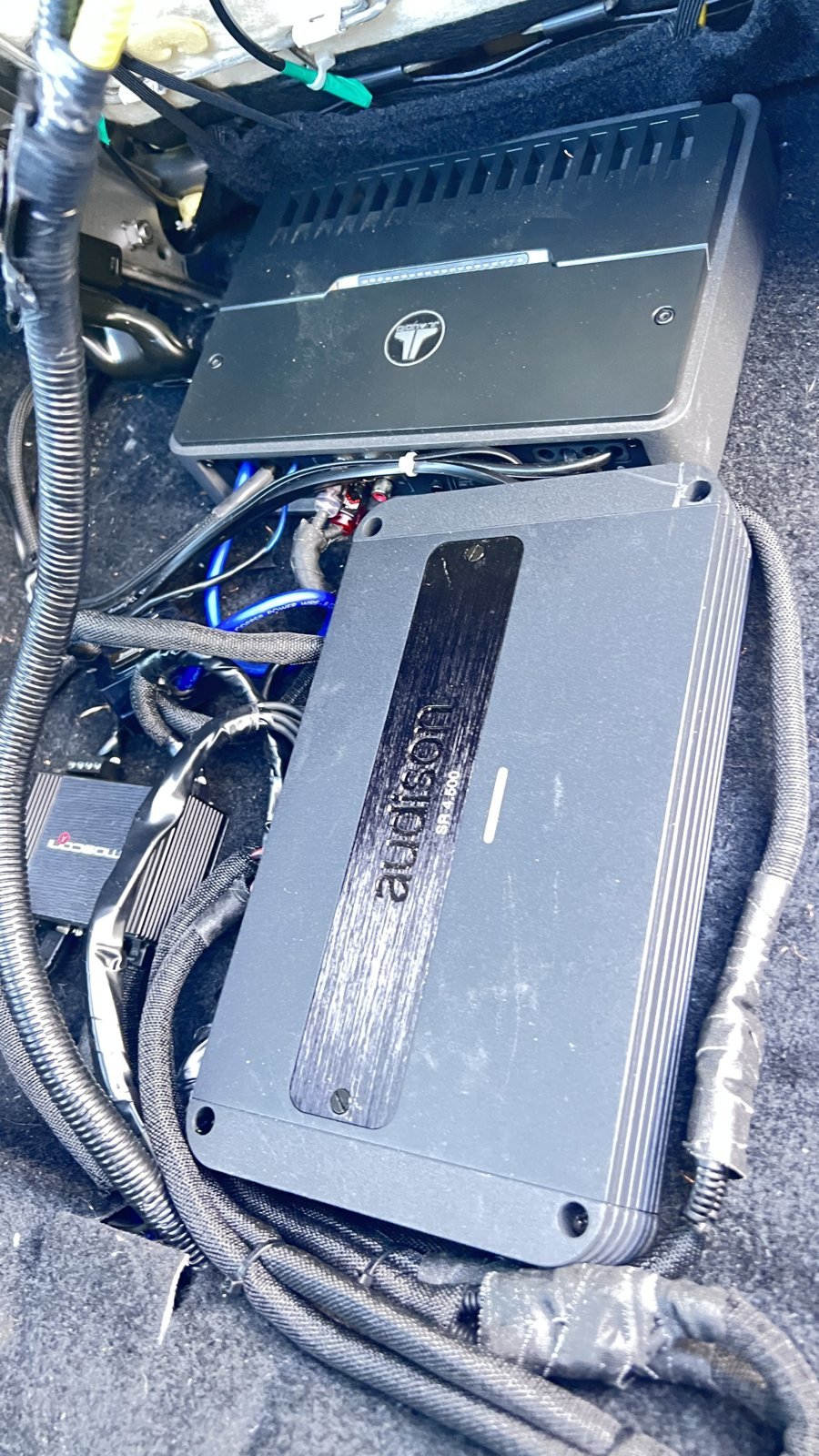

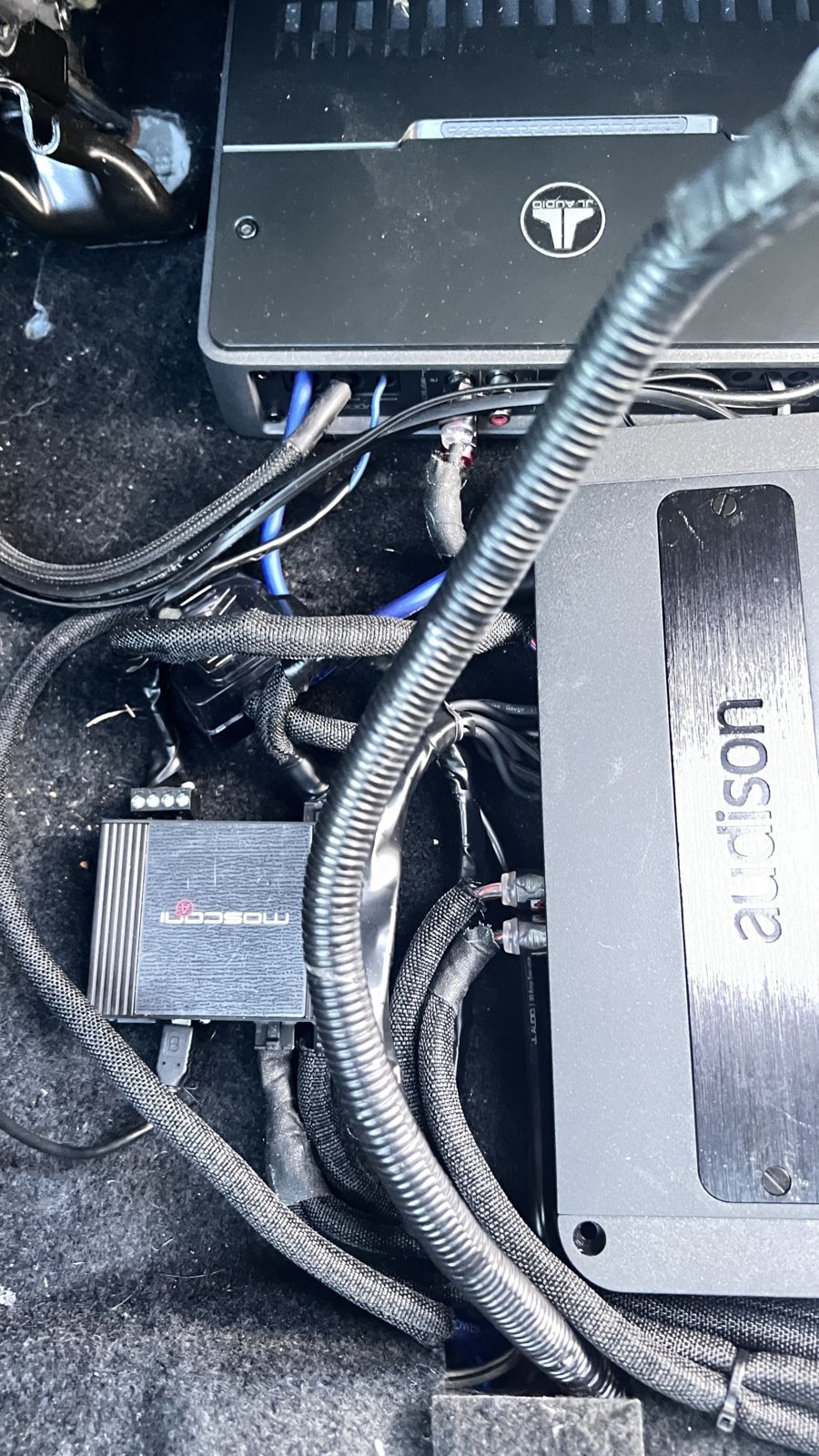

    Installed these C7s in the last few days, totally worth it! Running a 4 to 6 Mosconi DSP
    SR 4.500 Audison pushing the C7 Tweeters And C7 6.5 Mids,
    And the RD 500 doing the job with the TW3 12 JL audio Subwoofer

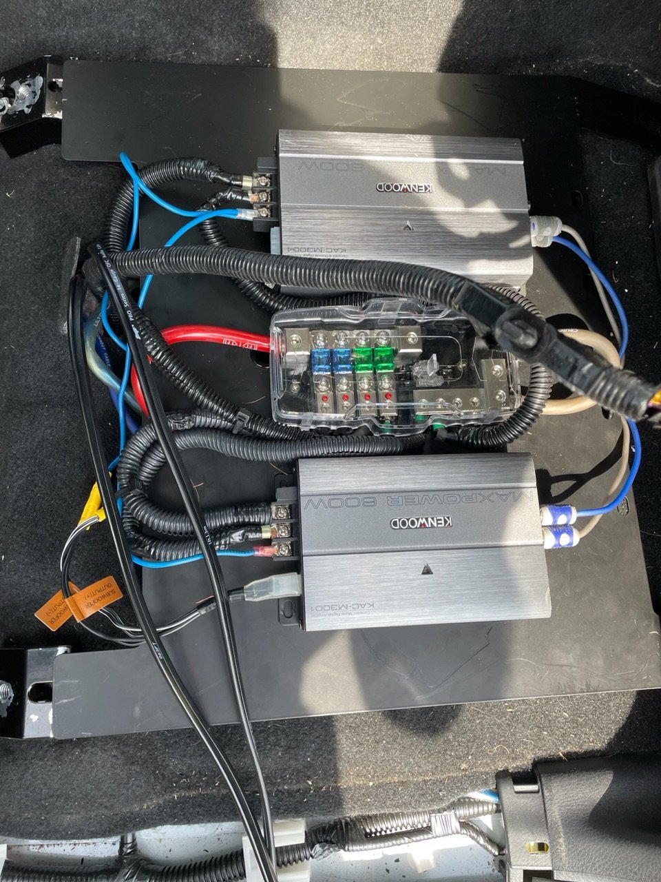

    I’m using 2 of those Kenwood mini amps , 1 on bottom is running my 10” Rockford shallow sub , 1 on top is what I am using to power the kicker 6x9 front door speakers. IMG_0375.jpg

    Do you like them? Are you using them from a factory HU or some other arrangement? It’s hard to tell because both the speaker level inputs and normal line in use the RCA connectors.

    I have a Kenwood head unit, the amps use rca connectors, and the plugs that you see on the other end are for the speaker wires .

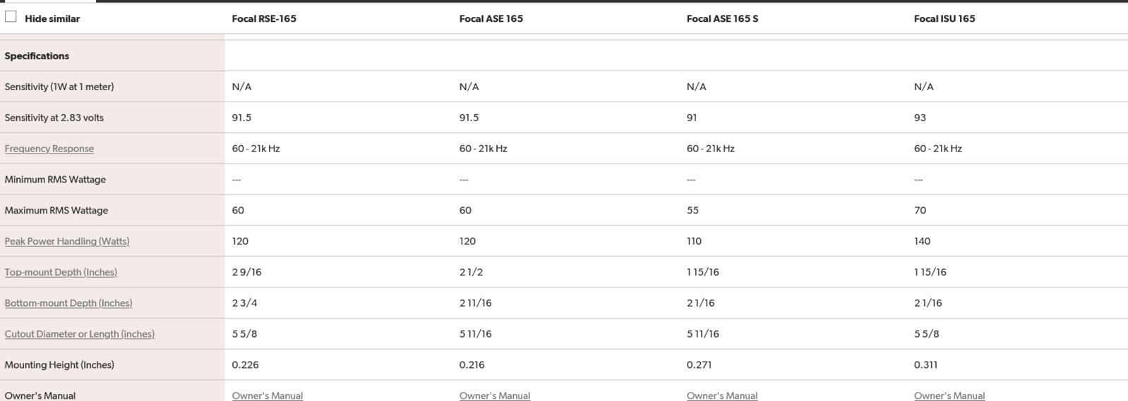

    Yea I think most Tacoma fitting Focals cut off at 60Hz...so you're going to need a sub for bass...

    ^that should be free-air response, it will change slightly once it's in the doors. there's also an EQ boost on the oem radio, i think its around 100-120hz, that reinforces the low end...
