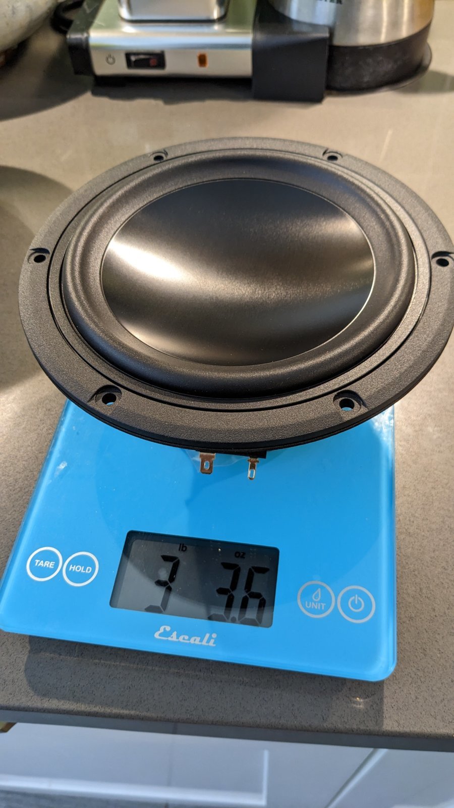

    On Soundman's advice. I picked up the Daytons a while back...and, yes they are built to a much higher standard than the Audio Control separates I just bought. It just made me think how car audio stuff is just over-priced across the board. Lesson learned. Glad I kept my Daytons woofers because, I must admit, the Audio Control stuff...while sounding great...the mid-woofer does not sound as polished (for lack of a better word) than the Daytons. When the Daytons arrived...I was like "holy crap...this is a nice speaker!" The brushed aluminum cone, the cast aluminum basket etc...the surround is indexed to the cone...for $50 each.

    I like the Audio Control Separates a lot. Yes, they’re very understated but, in person, they’re more impressive. There is very careful attention with packaging and instructions. There are two crossovers per L and R side (total of 4). I placed a set under each seat. This gave me quick access to the 3 position switch on the high pass crossover and I can adjust the seat back on the rails to easily access them.
    Soundman suggested keeping them in the cab for just that reason and he was right. The Audio Control tweeter output is strong and I had it set to the lowest setting which sounded most natural to me. Audio Control also provides large heat shrink envelopes for the crossovers should you want to remove the electronics from the aluminum housing and stick them in tight places like the dash.
    I now run the crossovers at 0 setting (instead of -3db or -6db) because I can cut the output with my Sony HU at -5db. This gives me a bit more detail than a -6db cut. This is just one of the areas where getting an aftermarket HU really pays off.
    BTW, I was expecting the woofer’s large magnet to translate to big bass but the mid bass is very neutral and balanced. It seems to start rolling off naturally at 80hz which is where my subwoofer (JL Stealthbox) kicks in. I’m still dialing it in with different settings but so far it’s been great fun and a solid choice. No regrets. Well, maybe I wish I had gotten an Audio Control Amp with DSP…but my Alpine S2-A55V (the weakest link in the chain) has been solid performer.
