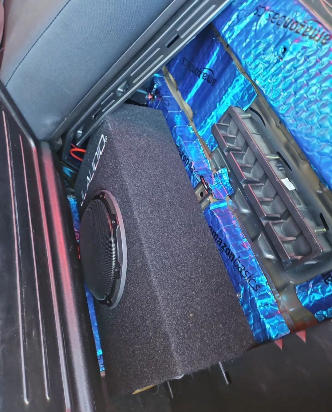

    I also went with the kicker 10s and it didn't fit under my front seats (2016 TRD no power seats). So my local stereo shop took out my passenger backs eat panel and stuffed it in there. It was ok until I had one of my enthusiast friends sit in the back and say he couldn't even hear it. Sooo back to my stereo shop (which I should've just done in the first place for recommendations) and they recommended the JL audio 8" Powered Microsub. And Holy sh!t does it make a difference from the Kicker! Night and day. It fit perfectly behind the seat afyer removing the back plastic cover.
    Just a PSA that this is a great alternative to going the Kicker route after racking my brains and doing research on countless posts here.

    um, what does this mean? the sub acts as a direct short?

    Ha! Typo my mistake. Nonetheless it slaps even behind the rear seat. Much more than the Kicker Hideaway 10". Night and day difference running on top of seperate kicker amp for the speakers. Really a great option within the slim pickings for subs for Tacoma's unless you get one of the custom fit boxes.
    https://www.crutchfield.com/S-GbVvsv78aU1/p_13693330/JL-Audio-ACP108LG-W3v3.html
