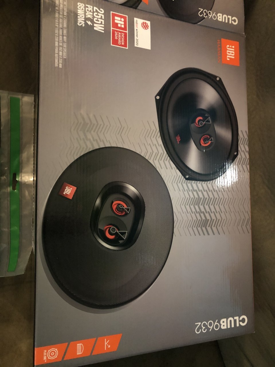

    Hey all!
    just wanted to let you know I completed an audio upgrade on the front. Here is everything you need.
    Screws: I used some wood screws from Lowe’s. Take the speaker adapter plate in and find the size you want.
    JBL club 9632 speakers:
    https://www.amazon.com/JBL-Club-9632-Three-way-speaker/dp/B085ZTR7G1

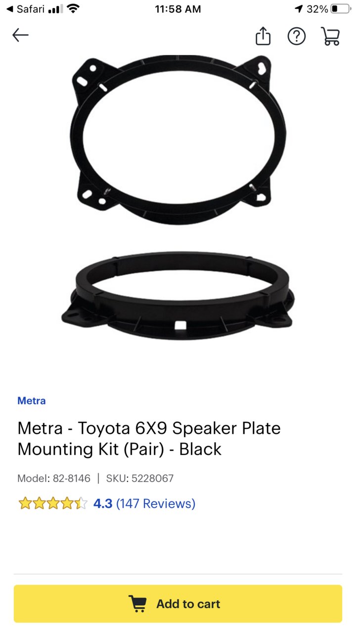

    Metra Toyota speaker adapter plates:
    https://www.amazon.com/Metra-82-814...t=&hvlocphy=9012325&hvtargid=pla-450218402125

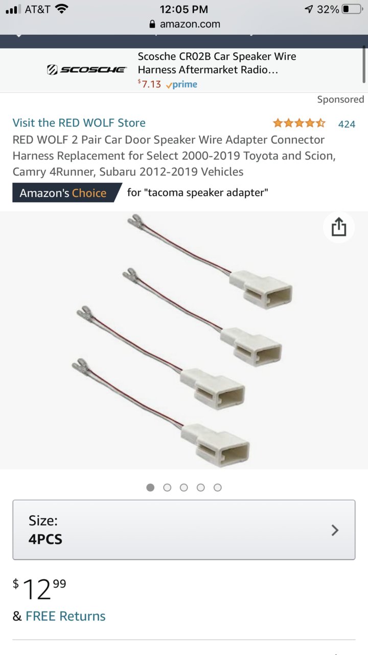

    Adapter wiring cables:
    https://www.amazon.com/RedWolf-Spea...a+speaker+adapter&qid=1615255360&sr=8-1-spons
    That’s it! It’s a 30 minute job on both sides. YouTube has tutorials to follow that are perfect. I am very pleased with the new audio performance!

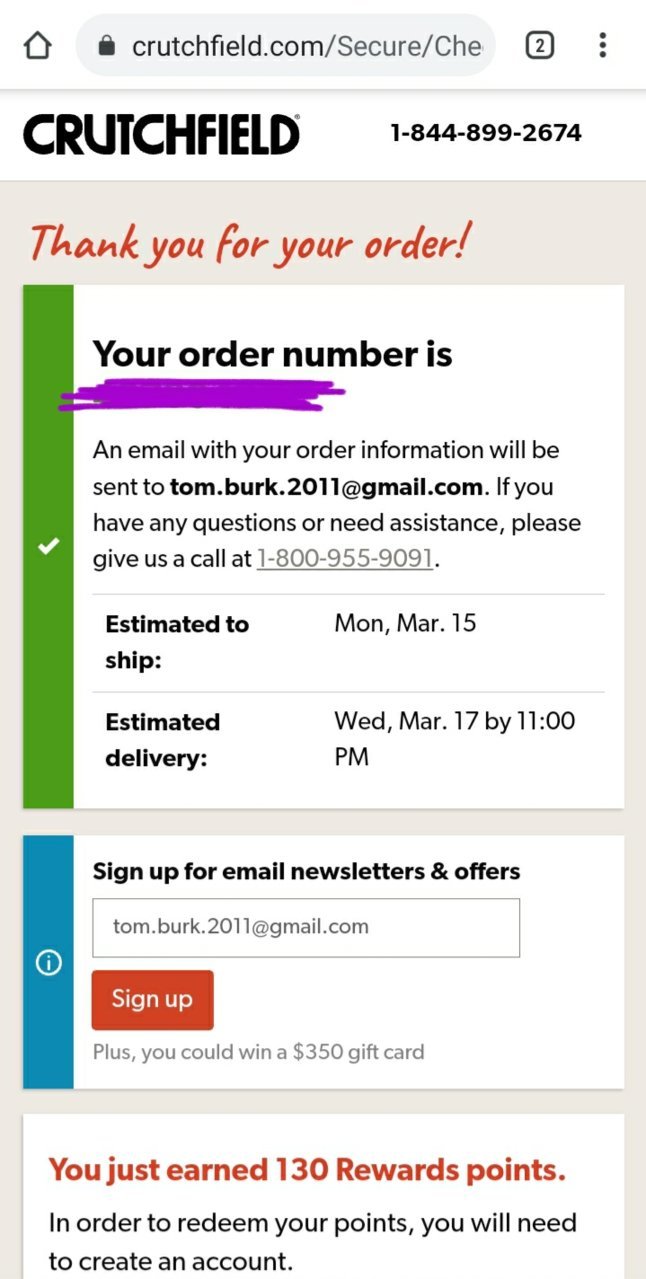

    Also just wanna point out if you order from crutchfield, I've found they also include the needed adapters for the vehicle. Both speaker adapters and wiring adapters.

    They are 6x9, millions of times better than stock lol. I will be picking up brackets on Monday for the rear. Those are infinity speakers.

    Great thread guys. I cant wait until Wednesday!!

    Those front speakers have a mediocre spec for the RMS Watt. Your head unit will come nowhere close to pushing that capacity of the speaker, so you have some room for using additional speaker capacity if you ever want to install an amplifier to better use the speakers. I like the setup so far, aside from the fact no amplifier or sub is being used. Step at a time. Not saying your install is junk, but saying you have some room for expansion as you build.

    Brackets worked perfect and yes infinity ref in the rear. Just got them in too!
