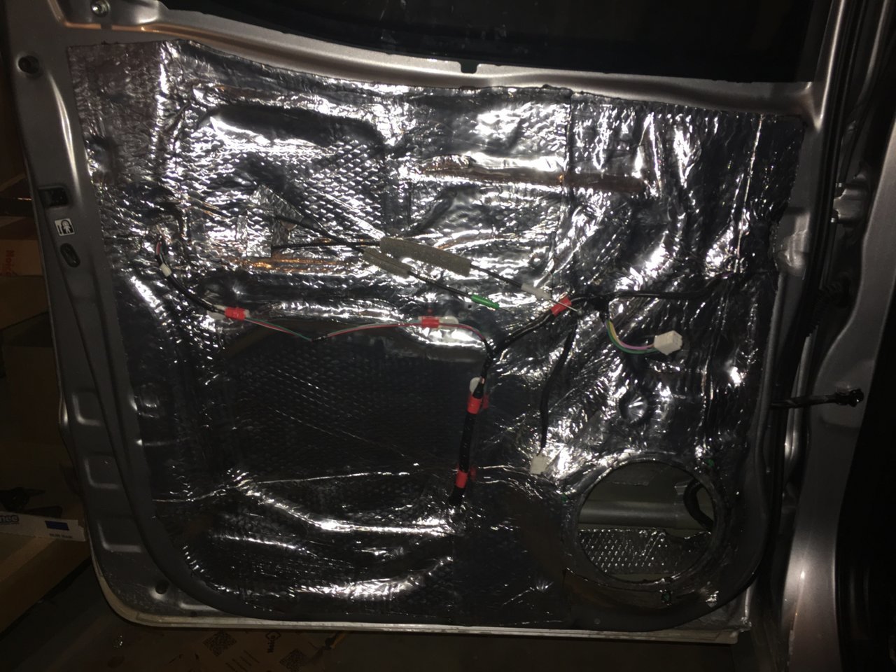

    Dont forget bullet proofing. I get a little thumping

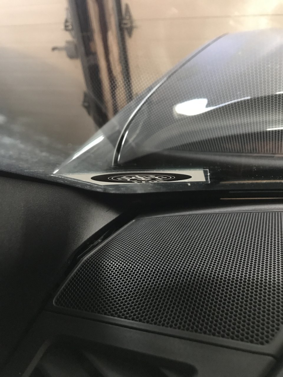

    I have a dumb question and a stupid problem. I upgraded my tweeters on my 3rd gen with the kickers referenced all over the place. I noticed a day later that my A pillar trim didn’t look right, the bottom appeaed out of place. I just messed with it and the stupid red clip located in the middle of the trim popped off and fell into my dash. I heard it bounce on a few things and I can’t tell where it landed. I’m going to hold off from ripping my dash apart and just hope there is not rattle. My question is how do you know if the pillar is installed correctly? I didn’t take a before photo. It looks better now but could still be wrong. Hoping this won’t mess w/my airbag performance.
    Has anyone else lost the clip and was it recoverable? I am so mad at myself right now. I used be an interior materials engineer for Honda R&D and should know better.

    Ok, I think I got it. Let’s just hope the clip or lack of clip does not cause some sort of problem
