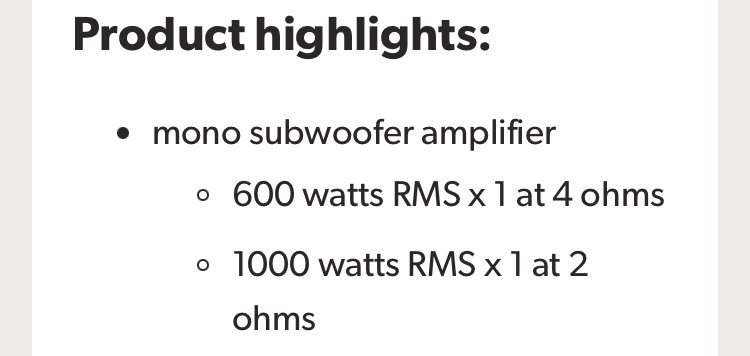

    I was going to put two 10” JL W3 subwoofers in my GEN 2 Tacoma Access Cab…now that I have more money to play around with I think I am going to get 2 Audiofrog GB10 D2’s
    Crutchfield told me if I am using two Audiofrog 10’s in the back that I should go with getting both 2 ohm “D2” speakers and not get the 4ohm “D4” version speakers. Apparantly this is because according to Crutchfield after going to the amp which is a JL JD1000/1 amp…ultimately having two 2 Ohm (D2) Audiofrog 10’s will allow me to push the ohms up to 4 ohms each speaker which then turns both to 2 ohms total once wired to the amp. Apparantly the Audiofrog GB10 D2 has the capability to either use 2 ohms or 4 ohms…the 4 ohm version does not have a 2 ohm setting…I guess this is why they are called 2 ohm “dual” speakers.
    Is crutchfield right here by going with two 2 ohm Audiofrog 10’s and not the 4 ohm version?
    I just want to get what is best for my Tacoma Access Cab…I was also told an enclosed speaker box would probably be better than a ported box for better sound.
    I listen to some extremely heavy music…no rap but still the metal I listen to has strong deep lows as well…just not like you hear in rap.
    Obviously I still want some hard hitting subs though…
    Also the JL JD1000/1 sound like a decent amp to use for these?
    Decisions decisions, lol…thanks in advance. :)

    Taking all the math out of it for now to simplify things…
    to get a 2ohm load at the amp, you need two of the 2ohm DVC versions, so they have told you correctly.

    4 Ohms is better. Period. At 4 ohms the amplifier has way more control over the subwoofer driver, the added damping enables the amp to not just move the cone, but more importantly, stop it.
    HOWEVER
    “Nobody” gives a flying fuck about high fidelity in their subwoofer. Homeys just want that shit loud AF. Like all of your comments above, I don’t think you even mentioned accuracy, I just saw words like “hit, hard, loud” and that’s pretty much normal now, and the industry has come to the rescue, providing you amps that deliver power at 2 ohms or less at the expense of fidelity.
    You can get amps running high power sub channels at 4 ohms but it is EXPENSIVE. Take a look at all of the monoblock amps on Crutchfield, they get that 1000W, 1500W, whatever watts actually by using a 2 ohm load or less. That’s why you can’t just assume a JD1000 will actually be 1000W, that might be its 1 ohm power output, in fact let’s look…
    And there you go, 2 Ohm. You’ll find a lot of amps labeled “xx-million.1” for a model name and that’s just what it puts out at whatever minimum load rating it was designed for. I don’t buy amps like these, I want the damping, a cooler running amp, and cooler running speakers. So, that’s why I spend more and most others don’t.
    YMMV, but this is why Crutchfield is recommending you go 2 ohms, to maximize your power without giving you sticker shock, knowing you’re just like all the other guys they deal with wanting subs. People like me don’t go to places like Crutchfield for advice, and they understand that.
    So, if you want two woofers:
    2 ohms - D2 ohm, coils wired series, drivers wired parallel to the amp.
    4 ohms - D4 ohm, coils wired in series, drivers wired parallel to the amp.
    Always wire coils in series instead of speakers. It turns them into essentially a single voice coil because they are mechanically bonded on the VC former.
    You could parallel the coils, then series the drivers and get your same load, but speakers wired in series interact. If you push in on one driver, the electrical circuit between the two will cause the other speaker to move in the opposite direction. Your amplifier has to fight and overcome that “feedback” so wiring drivers in series should only be done out of necessity.
