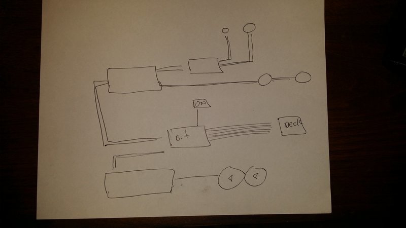

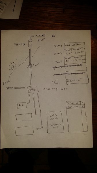

    Great news. Speaker locations are going to work out. Mids on factory tweeter location (dash) got drawings of the layout and how the speaker wires will be ran /power&grounds/fuses and all the good stuff. Looking like those shelves in the glove box will be holding the 2 cross overs nicely from the 3 way kit. Bit one would fit in there too which would look sweet but the cables I'm going with $$$ will be a long run of rcas so well keep it close to the amps. Here's some pics guys. Rough drawings lol but gives you an idea for who ever doesn't know how it's ran. Over all good day even got a nice bottle of white wine given to me to enjoy!

    Crossovers in the glovebox? You'll probably regret that. For an install of this scope, it should be easy enough to hide them out of the way so that you can use your full glove box and not subject them to whatever you toss in the box as well as repeated opening and closing.
    To echo earlier sentiments though, why use a DSP if you're using passives? One of the bigger benefits of using a DSP is active crossovers. Another is time alignment - and you won't get to use that on your front stage either. Pretty much all you'll get out of it is a fancy EQ. I'm also going to stick my foot in it here and write that I'd probably choose a Helix DSP to the Audison, but either should work nicely.
    My advice - if you really want an SQ build, ditch the passives (and actually use all the DSP's functions), and amp every channel (with too much power - think headroom). I think most of this has been said before, but needed saying again.

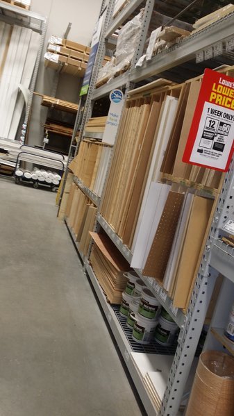

    Home Depot has no BIRCH and it's not looking like lowes either. (Rob I didn't make a fake account lol )
    IronPeak likes this.

    Pisser on the Birch. The HD stores here stock it, but the local lumberyards might be the only source in some markets. Might get better stuff too. Is it sub time? :cookiemonster:

    @zackdippolito Man im not trying to come off wrong here but @rob feature is correct. You are losing the ability to have active crossovers when you are using it in conjunction with the passive. I mean you could set the crossovers for the low end on your door speakers but that is it.
    i am taking it for granted that you have done your research on passive and active crossovers, and that you know why Rob and I keep chiming in here. You are paying a lot of money for that bit 1, which is an AWESOME DSP, but you are not using it to it full potential in this build set up.

    I got morning wood;) only had to go to 4 stores before finally hitting up a lumber yard in Toronto. Forced to buy an entire sheet those bastards.

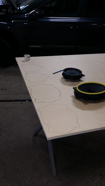

  20. Dec 23, 2016 at 2:35 PM
    #40
    zackdippolito
    zackdippolito [OP] Well-Known Member
    Jul 15, 2015
    #159506
    113
    zack
    2012 SR5/2014 TRD Sport/2017 TRD Sport 6M

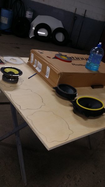

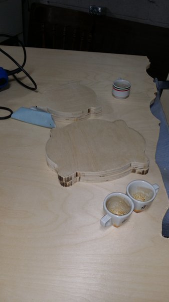

    Got templates started for the 6's in the doors front and back so I traced the oem housing around the speaker and cut them out sanded them down nicely. 10 espressos later I had them all cut and what not( ready to sound proof and glue together sandwiched)just waiting on ordered materials to arrive:)
